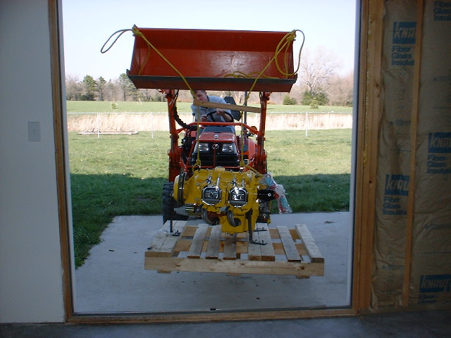

I have not noticed that so much with mine but I imagine tractors are different. In any case once mine gets to about 2,000 RPM or so it does what it does. Turning the engine faster makes it more responsive, maybe a little more "powerful" but mostly just lot's of engine noise. Like I said, if it gets stuck, rev the engine a little, rock the tractor etc to help the FEL. I don't think there is any need to drive aound with the engine full blast to move a bag of mulch or even a loader full of dirt. I don't think my IO360 is as heavy as a Cheby but I used about 1600 RPM so I could gently operate the loader without thinking about it so I could keep my eyes on the 25,000 dollar prize. Shoot, maybe my 2410 is more "powerful" than a 2710 at reduced RPM /forums/images/graemlins/grin.gif. Guys and their "powerfullness" /forums/images/graemlins/wink.gif. I think in my next life I will ask the crows if I might be a woman or at least a dog (but not at the same time /forums/images/graemlins/shocked.gif), women and dogs have so much more sense than men /forums/images/graemlins/tongue.gif.
Often finess will get better results that brute "powerfullness" . J
