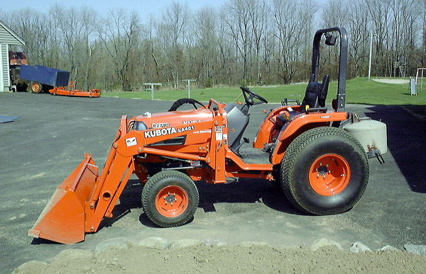

Moon,Here is a counter weight that I made out of an old water tank. It is about 20" in diameter and has about 550 lbs. of lead in it. Works great and you don't have to worry about hitting anything with it when backing up! I know its not a "box" but does the same thing.

Von, yours looks pury cool. How in the world did ya make that one?

Tex, It is not to hard to make an effective counter weight from a variety of things. The system I like is a plastic container (small garbage can) that you can insert a drawbar through (the type draw bar that goes between your lift arms) and a simple bracket for your top link. Fill it full of concrete, insert the top bracket in the wet concrete, let it set up for a day or two and you have an cheap counter weight.
