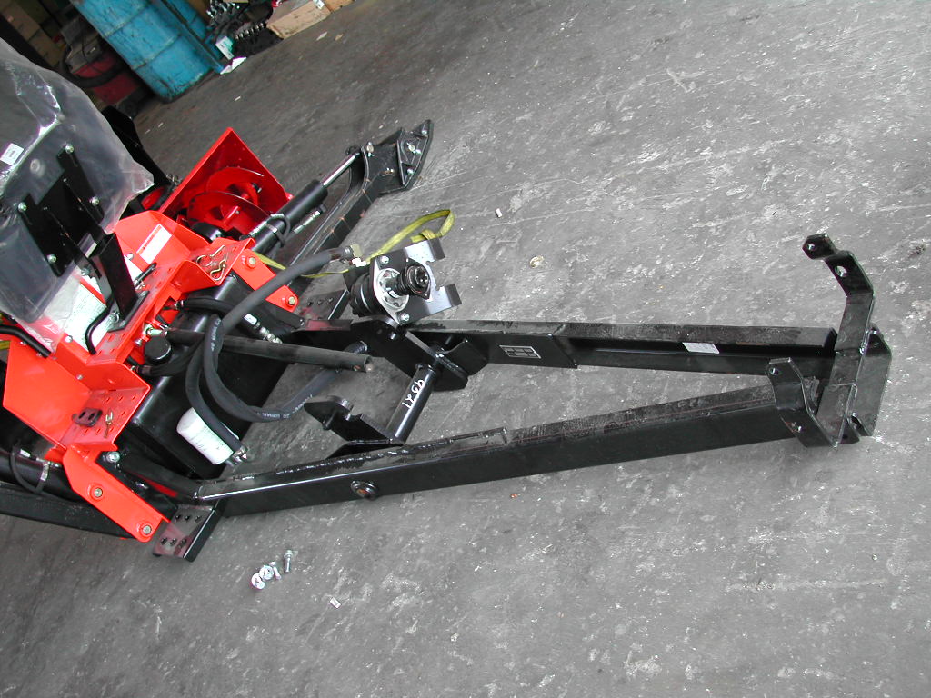

My error. Your subject said 7500, so I was thinking the Woods
7500 hoe, not the B7500 tractor.
Here is a photo of the cheaper B-series Woods subframe (about $450)
on a B7800, I think. I can also dig up a photo of the 4-pt Woods
subframe for a B.

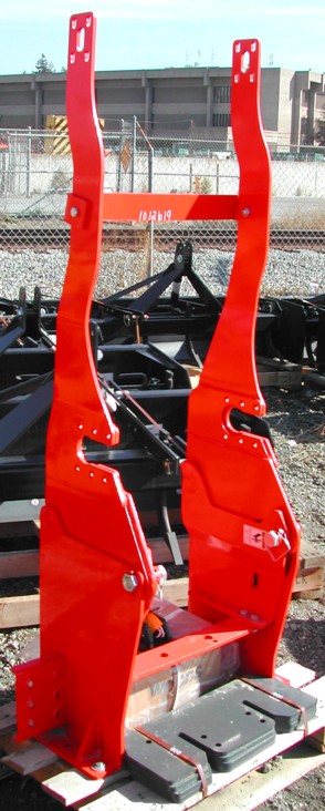

Woods 4-pt subframe....B series. I don't know which Kubotas. I
imagine this is the one you were quoted. Or one like it.
   / B7500 Backhoe
Yes, the one of the 4 point is what was quoted and is listed as the only sub-frame mount on the Woods web site. Is the one you call the "old B-series" what is considered a 3 point hitch mount?? I saw that option, but I've read that I shouldn't consider a 3 pt mount with a sub-compact like the B7500 Kubota. In any case, I was trying to find out if the 4 pt sub-frame price of $1100 sounded right.

If you look at the Woos web site, they note which ones are 4-point
subframes. The others are the older style that make use of a ridgid
lower frame and a strengthened toplink bar. They are NOT 3-point mounts.
I am totally against using the 3-point to mount a backhoe on any CUT.
Kubota does have a 3-point backhoe, however, called the 4672. Their
official position on using the 3-point to mount a hoe on Kubota tractors is
that you void your warranty, unless you buy the Kubota 3-point hoe. I was
told that by a factory rep when I pointed out the irony.
As for the $1100 price you were quoted, I think that is high for parts only.
With labor, it is more consistant with the $950 parts price I have been
quoted.
