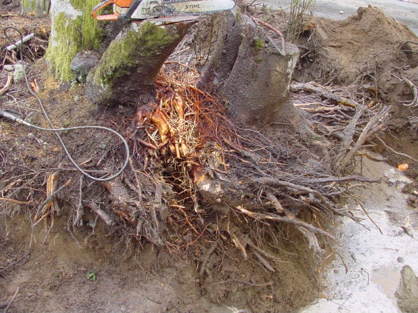

I have the B7500 and 4672 BH. I am in the process of digging up 14 alder stumps from a stand that I just recently dropped. I am currently working on a cluster of 6 trees that grew into on large root ball. This one has been ugly. I had to split the root ball in half. I did this using my pressure washer to drill down and expose the root and then chain saw in half. I have dug a ramp with the loader to get underneath this mess and then used high pressure water to remove the dirt, so I can move and then burn them. These trees vary in age from 20-40 years, (8-24 inches in diameter). This is a slow process with the B7500, but as a "weekend warrior" it ends up being a fun challenge. 1"-7" alders should be very easy to get out. I don't know about 1 scoop on a 7", because it depends on the soil and root structure. For the small 1" alders, I would recommend a toothbar on your loader. It will handle the small ones if they aren't in hard clay. Of course the more power you have, the faster and easier stump removal will be, but it is nice to have a smaller footprint tractor the rest of the time. There are times I wish I had a bigger tractor and time when I wish I had a smaller one. This tells me that I got the right size. BTW, did you talk to Mark at Issaquah? Good luck with your shopping.

I just got in after a full day of seat time. I do have some photos to share. This project is really pushing my B7500. Trust me, if I was a "professional stump digger" I'd be looking at something a lot bigger. However, since I have no aspirations of making a living digging stumps and I only have a few more to go, the B7500 is just fine. I also agree with the last post regarding the B7800. It looks like a fine machine. However, I looked at it and found that the 4690 has more reach, but exactly the same digging power as the the 4692. The loader on the 7800 has about 200lbs. more capacity and the 3pt. about 300lbs. It would be very costly for me to trade up, and that really isn't that much improvement to justify to dollars, for me. I could barely afford my B7500. Anyway, I have 4 photos and I will attach each in seperate posts with descriptions.
The first photo shows the full cluster, although you can't see all 6, but you'll get the idea of what a mess this is. I used a pressure washer to expose the roots and the ended up chain sawing them apart.

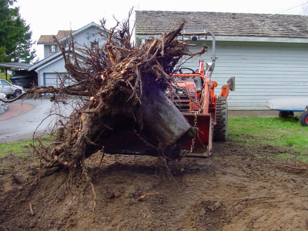

This is a photo of the first half that I broke off. This is two stumps. I was actually able to lift this with the loader. I had to use a little leverage to get it up, but it worked.

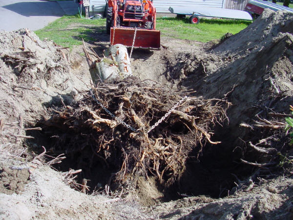

This is a picture taken from above the ramp and hole that I dug to get these monsters out. I used the chain to tip up the root ball so I could blast it with water to get the dirt of so I could move it and eventually burn it. To get it out of the hole I used the BH to roll it.

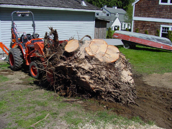

Here is the monster out of the hole. There were 4 trees growing out of that mess. No way my tractor could pick this one up. It was all I could do to push it up to the burn pile. I'm glad I'm done with this little project.
You asked how much work it would be for single stumps. After finishing this mess, it would seem like a walk in the park. Actually, the truth is, if you are in a hurry, you will be frustrated. If you enjoy seat time and a good challenge, then no problem. It also helps to be Swedish. Also, I have to confess that these stumps were in very sandy soil, so that helps. I do have some veins of clay on my property and I haven't had any problems digging in it. The hoe will walk the tractor around if you let it. I have found it helps to keep my loader bucket full with dirt when I am doing some hard digging. I have had the BH off and on about a dozen times. Taking it off is easy. Putting it on takes practice. My first time it was well over an hour. Each time I got faster and now I can do it in about 15 minutes.
Hope this info helps.
Greg

My goodness, those pictures are certainly worth a thousand words! That was one heck of a wrestling match which you obviously won. Although that took some time, it is clear that the B7500/4672 hoe combo is a formidable machine. Those pictures definitely indicate that the B7500 and 4672 hoe would be more than adequate for what I have in mind. The picture of your loader lifting that beast of a stump was particularly impressive; that thing was almost as big as your tractor. I do not have anything that big to tackle. Boone's post above discussing going through 2" willow with the bush hog also tells me that the 3 Cylinder, 21 HP engine has plenty of torque to handle the bush hogging chores that I have in mind.
Thanks again for the pics. They were exactly what I needed to help me understand what the machine is capable of. Your direct answers to my questions were also very helpful. I am going to walk my back five this afternoon for kind of a reality check (7500 Vs. 7800). I will be giving Mark a call soon.
