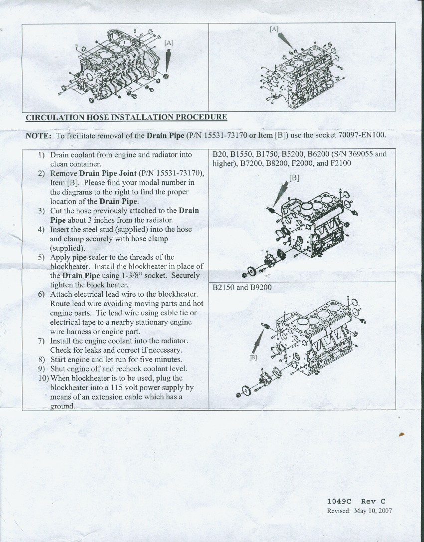

Has anyone installed a block heater on a B7200?
I purchased the unit from my local dealer and it installs in place of the block drain pipe. The instructions reference a socket (70097-EN100) for removing the drain pipe (part # 15531-73170). All well and good except the dealer has never heard of the socket and I am unable to get more than a quarter turn towards getting it out. TIA

I appreciate your response, I also have the factory service manuals and could find nothing. I am attaching the installation sheets for the heater in hopes that might help.

Thanks! That's the critter. For mine it shows the heater replacing the drain pipe.

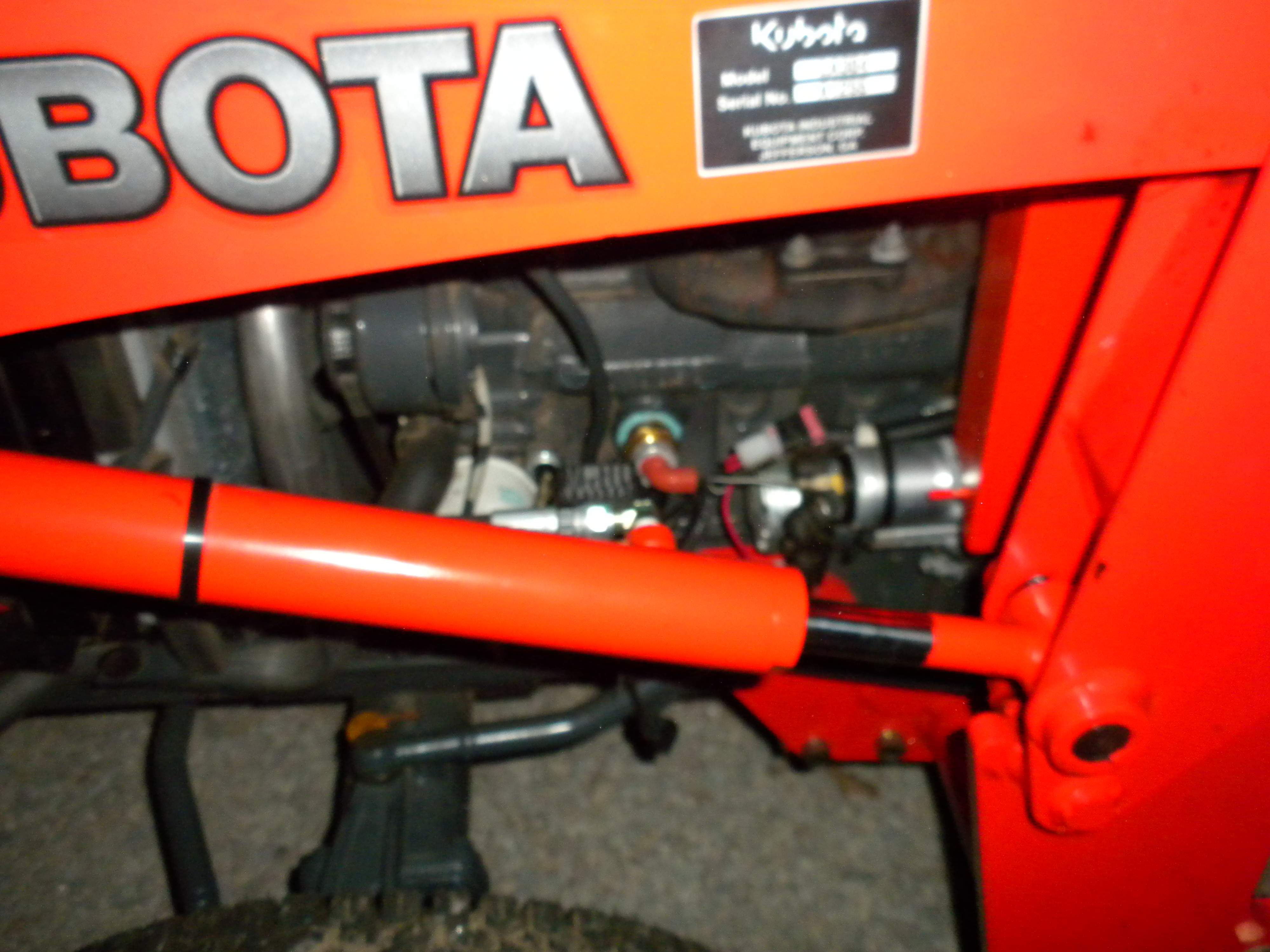

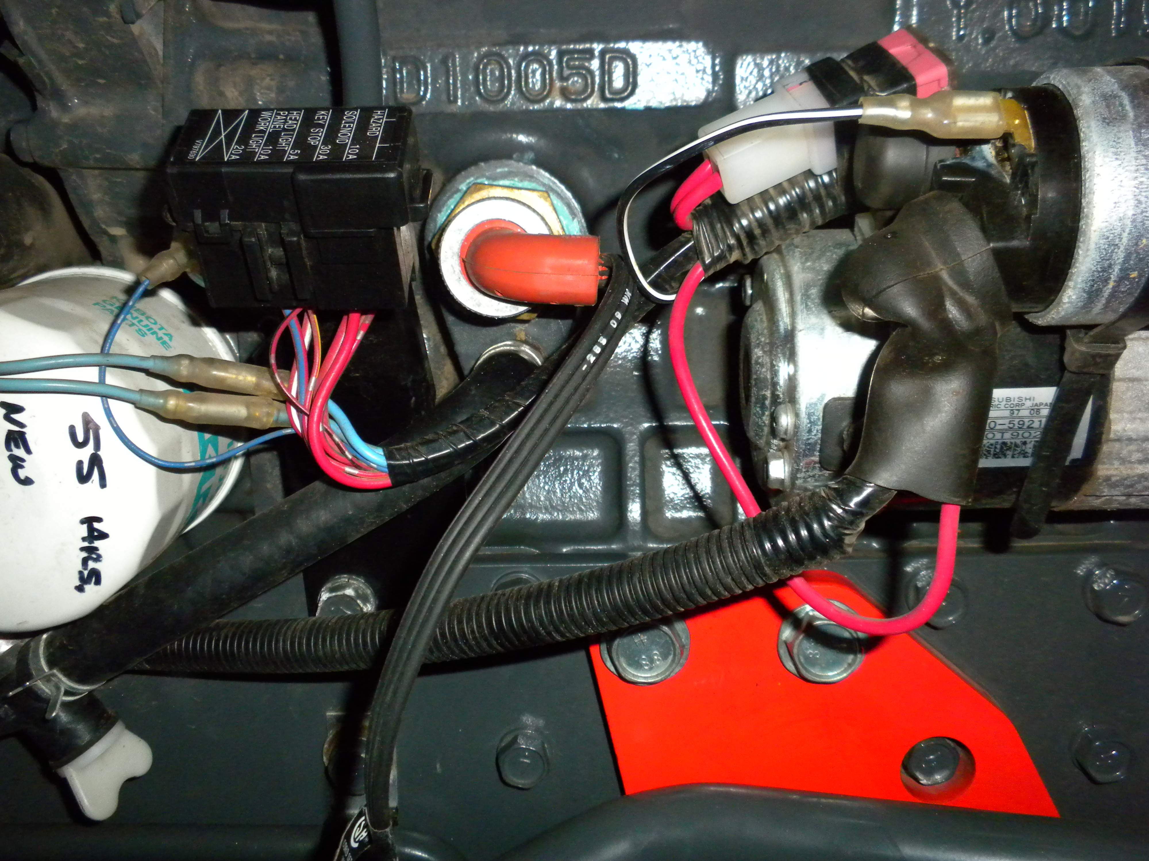

Dontieche,
Here's Pics of mine installed......there's a pipe plug that needs a 17 mm allen wrench........IIRC a 1 3/8 socket fits the brass block heater......
If you don't touch the filler cap on the radiator you can slip the plug out and install the BH and only lose a cup or two of coolant (catch it in a pan to reuse it)
Good Luck

would a ratchet end box end work
After the picture it's very evident the box end will not work.:ashamed:
Afraid I missunderstood the question.:eek:
