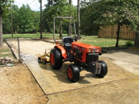

The s/n on the tractor is B7100HD67184. Can someone tell me what year this is, or post a link to where I can go to find out?

I think I see 6 bolts holding the front wheels on. If so, it's from the 90s.

You are correct. It does have 6 lug bolts on the front wheels. Is there no way to tell from the s/n?
   / B7100HSD- model year? #4
You can take a reasonably educated guess by comparing to other serial numbers. The flaw in that method is that the other tractors could have sat on the dealer lot for a year before being sold and the owner may not know about this. I bought mine used so I only have word of mouth to go on. My serial number is lower than yours and I'm told that I have a 92 or 93.

Yea, this tractor is in excellent condition, but I'd just like to know a year model. It only has 590 hours on it.

As Tig stated, you definitely have one of the mid-90's models, as evident by the 6-lugs on the front wheels. Since we're talking about a a 6 year range, 11-17 years ago, the condition and hours are much more relevant than the exact year. These late-B7100, have some minor improvements over the older models, and, because they're newer, usually have lower hours too. In either case, they're very durable, simple machines, and with proper maintenance, will probably outlive all of us.

Take a look at the rear wheels and see if there is a date stamped into the wheel. That date (if it's there) is the date the wheel was made. You can only assume that the tractor was made shortly thereafter.
