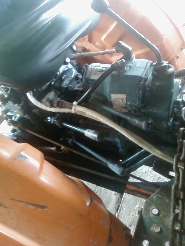

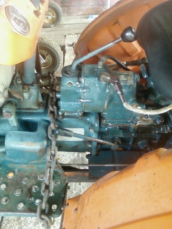

I have a B7100D 6 speed manual trans with a hydraulic blade.
There is a mystery box mounted on top of my normal transmission that feeds the blade hydraulics and has a lever on the side. It also has a diagram showing various combinations of "creeping speeds" vs. High Low settings.
I assume that this means the lever works in conjunction with the High-Low lever somehow.
The lever has 3 positions.
Does anyone know what this mystery box is called and what it does?
It seems that it not only feeds hydraulics to the blade, but also affects my transmission gears.
I can not find any mention of this option in any Kubota manual. But, it looks like a genuine Kubota part.
Why would Kubota create 1 addon component that serves hydraulics to the blade and adds extra gears??
Can you refer me to the proper Kubota manual?
Thanks for any light you can shed on this.

Well I just sold my B7100DT (1981 vintage) and it did not look like your pictures. I had the little beast for 15 years so I am pretty familiar with the levers. Left side is PTO Speed select. Bottom Right is 2 wheel/4 wheel drive. Right middle is the High/Low Range for the Transmission. I am not sure what the top right lever is. This picture looks totally different than mine. Where do the hoses go? Is this a model B7001 (Gray Market) instead of a B7100
