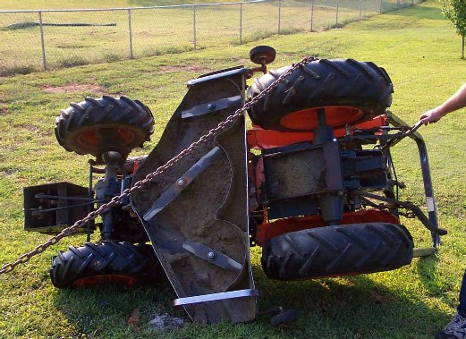

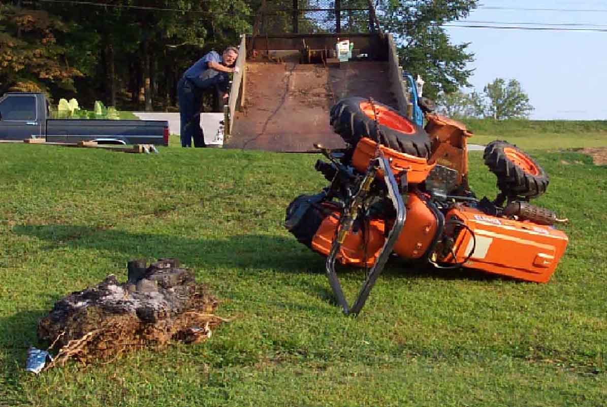

I sold my old Kubota B7100 (...old faithful...) to some friends a couple of months ago.
The wife of the couple was slightly hesitant to use the tractor at first, but then started to like it a lot, and thus started using it a lot.
She turned it over today while dragging a tree stump up a small hill. Fortunately, she was not hurt. Other than one minor dent and a bent wheel on the mid-mower, the tractor is fine as well.
Hopefully most readers on this board are aware of the safety lesson here. She had tied the rope to the ROPS which is above the tractor's center of gravity. This worked fine (I guess?) at until she started up the hill at a slight angle.
Anyways... Be sure and tow or pull items from the lowest possible point on the tractor.

Of course, this is certainly not the best technique for accessing the bottom of the mid-mower for maintenance!

The 2nd photo I posted (showing the underside of the belly mower) shows both rear wheels off the ground, indicating that the tractor would've continued rolling over had the roll bar not stopped it.
Adding the ROPS was a very high priority for me. Even so, I never thought it would have turned over on that small of a hill. Of course, I know that it would not have turned over without the assistance of that stump, but I still find that hard to believe that it turned over.
