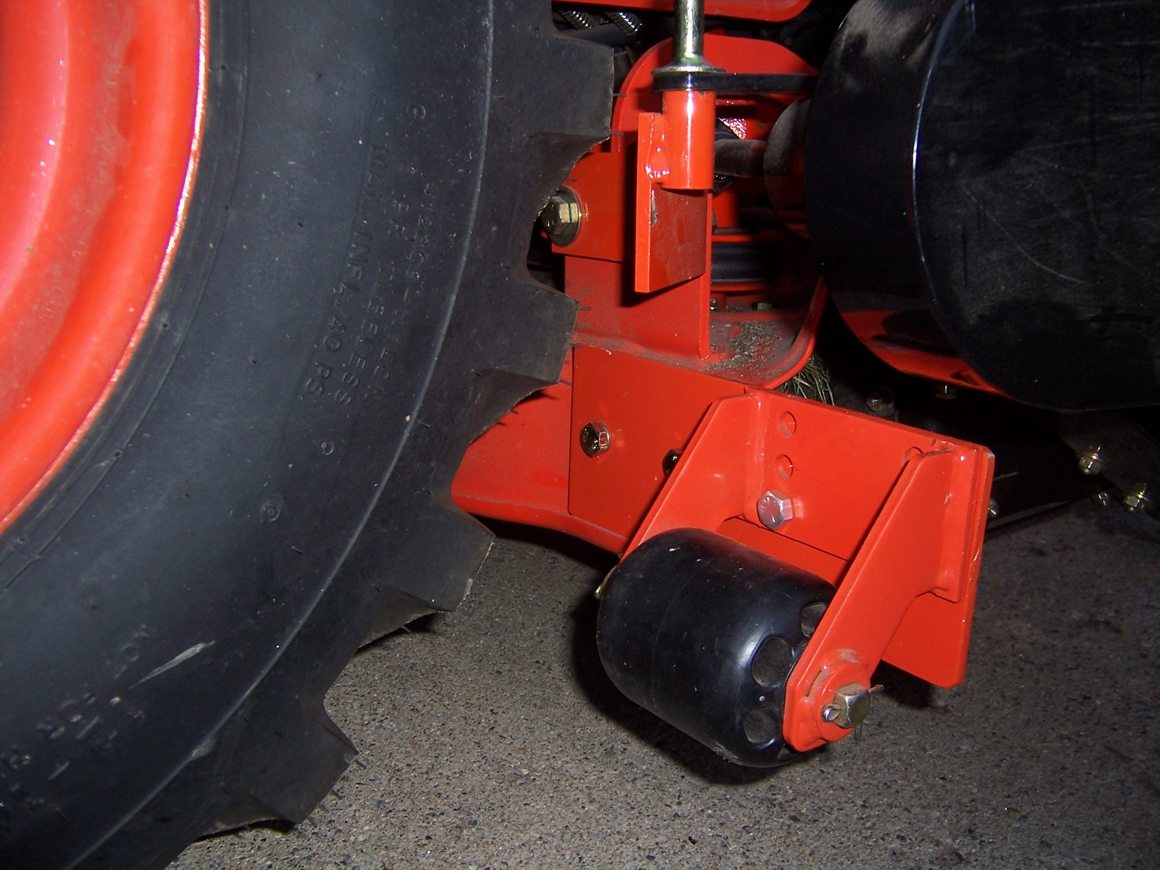

I own both tractors. I bought the B7100 new more than 20 years and 4,000 hrs ago and just purchased the B7610 last month. I have many trees and steep sections on my property and so tread width is important to me also. My B7610 has a 54" MMM and the Grass catcher, used more for all the leaves than the grass clippings. To my supprise with the R4 tires I couldn't set the rear tread beyond 46" because the antiscalp roller on the left side interferes with the tire during transport. The dealer suggested removing the roller. I modified the deck with a steel plate that allowed me to move the roller out a further 5". This let me set the rear tread to 50". The bracket for the grass catcher blower prohibits moving the tires any further appart. A photo of the bracket plate is attached. I don't know if the 60" mower and blower have any of these restrictions.
