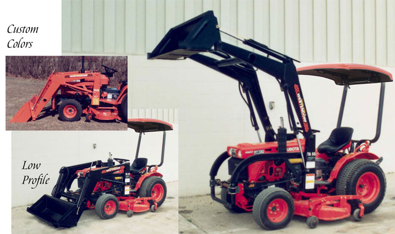

   / B7100 Loader #5
If you run across a TA55 it is an ideal fit for you B7100. Mounting brackets are readily available (should run between $300 & $400). That includes a rear axle kit to stregthen the frame (runs from front axle to rear axle). Lifts 700# at full height of 7'9". I've seen them listed on ebay...
