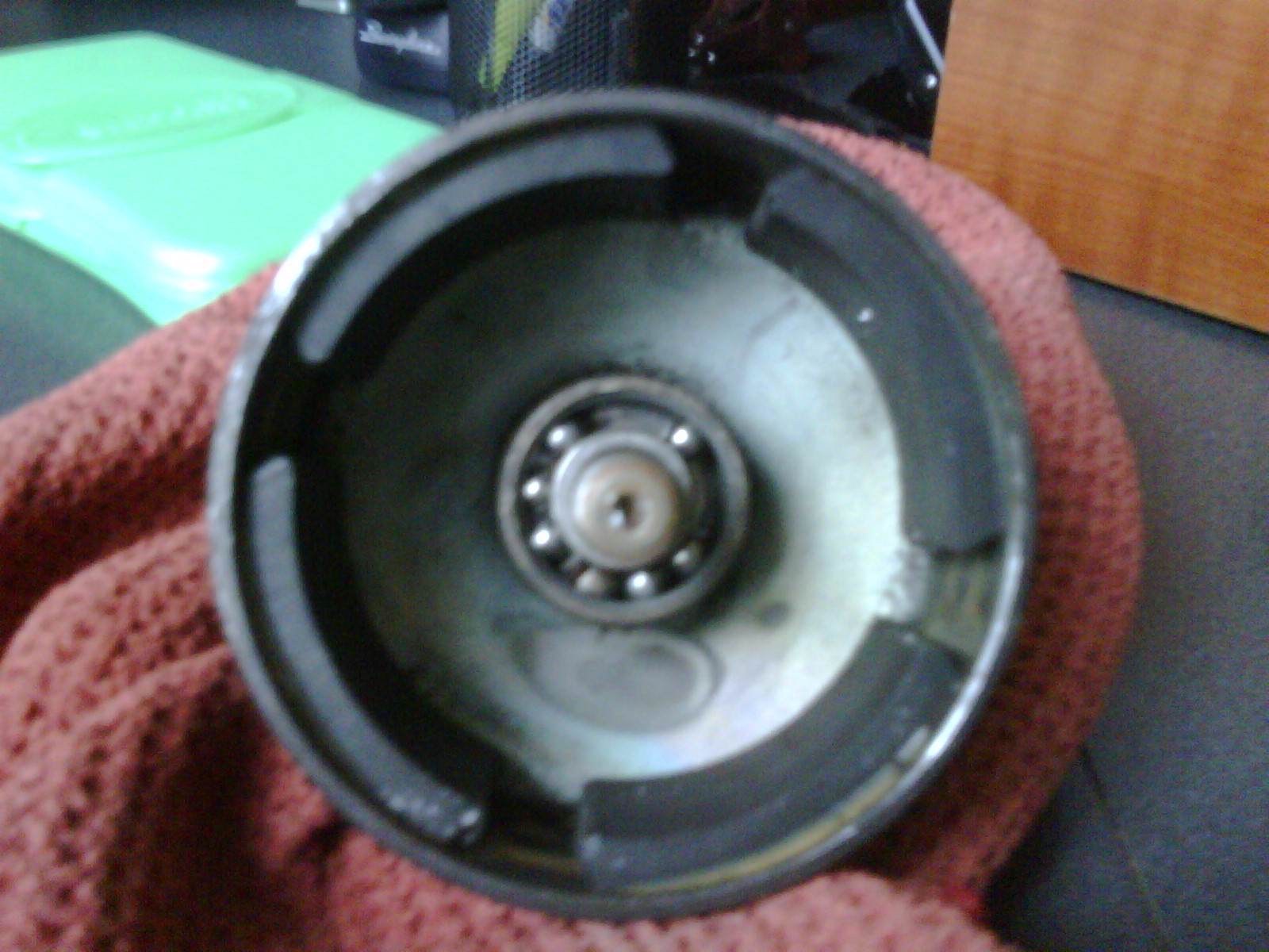

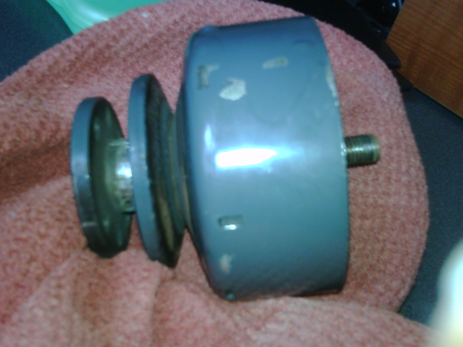

I ran into the fan/dynamo not spinning issue and deduced, based on input from this forum, that my bearing seized up. I have already broken down the frontend and removed the dynamo from the engine. After opening the dynamo I discovered large amounts of shredded metal inside. I have since cleaned out the metal debris and now need to remove the old bearing. Can anyone provide any guidance on how the bearing is removed? It is proving to be a little difficult at the moment. I have attached some pictures of the dynamo below:
Thanks in advance for your help on this.

There should be a retaining clip in the second picture that holds the shaft in place.
Send me your email address and I can send you a PDF that shows the exploded view.:D

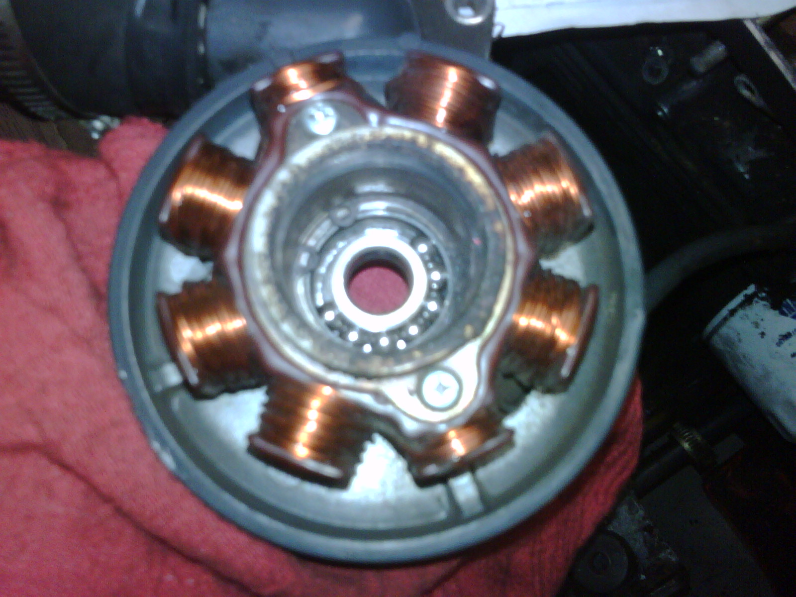

Egon, thanks for the offer. I sent you the email. Is the ring you're referring to called:
Ref No: 090
Part No: 15261-95470
Description: CIR CLIP INTERNAL
I took a picture of the rear half of the dynamo and attached it below. If you look closely, you can see what I believe to be the clip you are referring to. It also looks as if there is another set bearings in the rear half of the dynamo behind the clip in the picture which I am assuming is part the stator assembly since there is no separate listing for that set of bearings.
So if the clip is on the rear half, then what is holding the bearing in the front half in dynamo-inside photo above?

The exploded view only shows the one bearing. But but from the exploded view remove the nut and clip and everything should come apart.:confused:
I never have taken mine apart. I ordered a new one and installed it.:D
The PDF is in the mail but it sounds like you already have one.

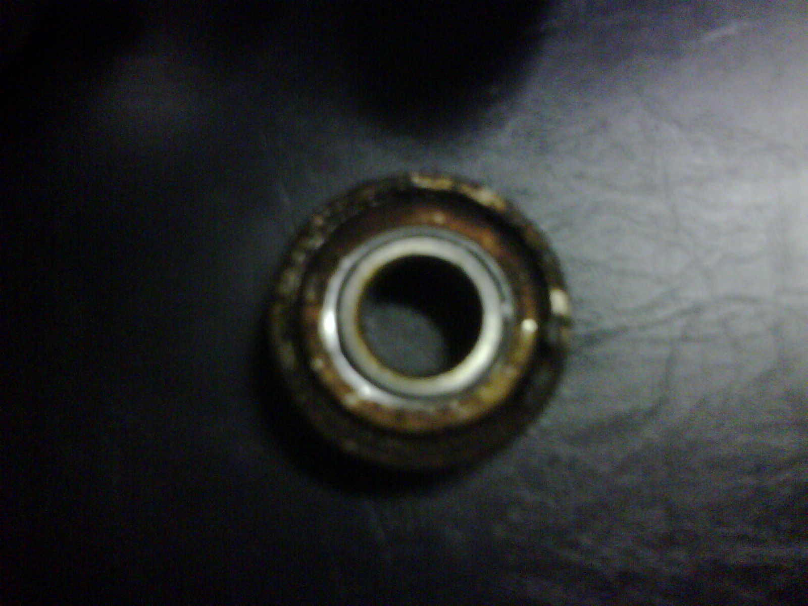

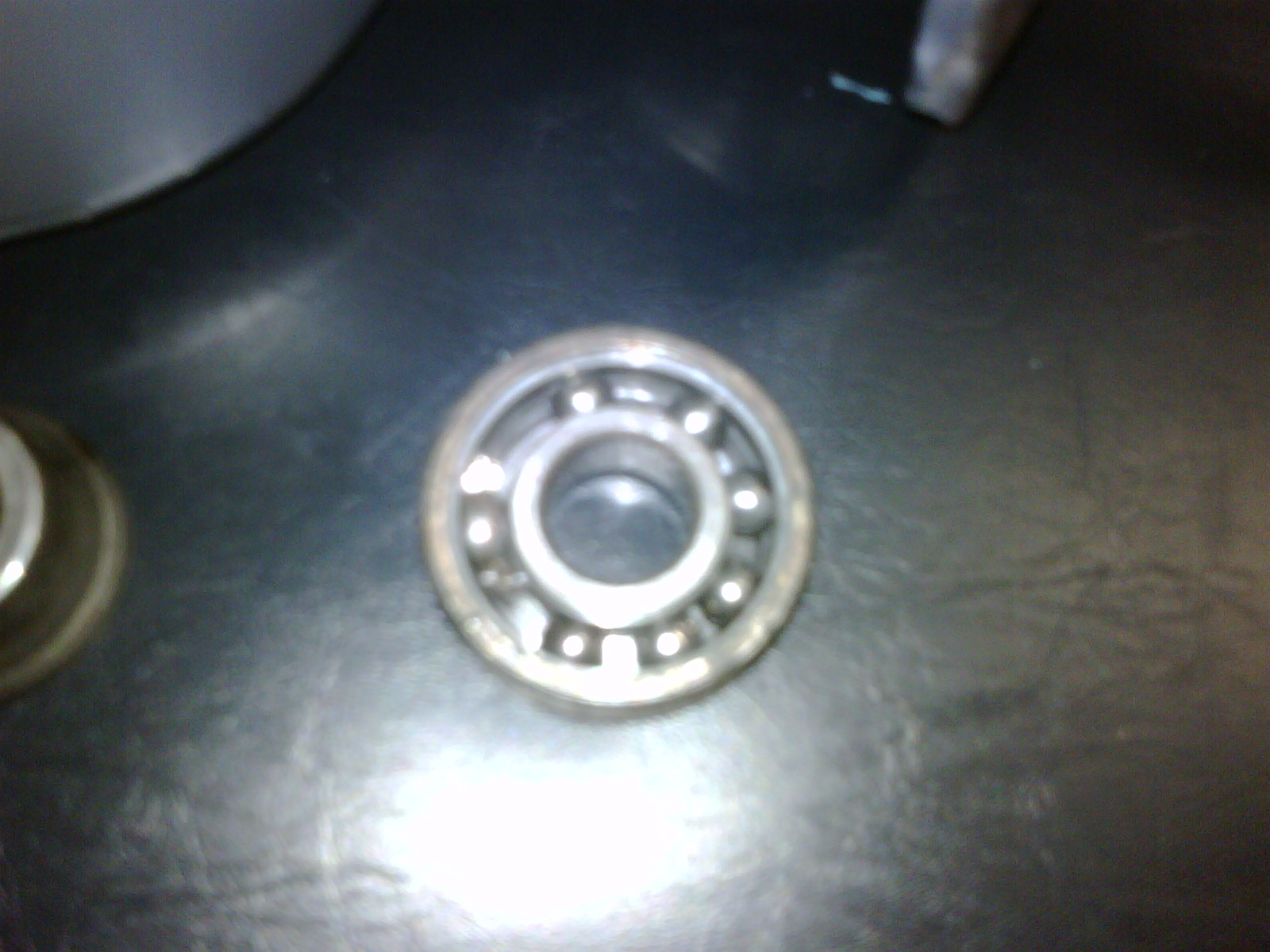

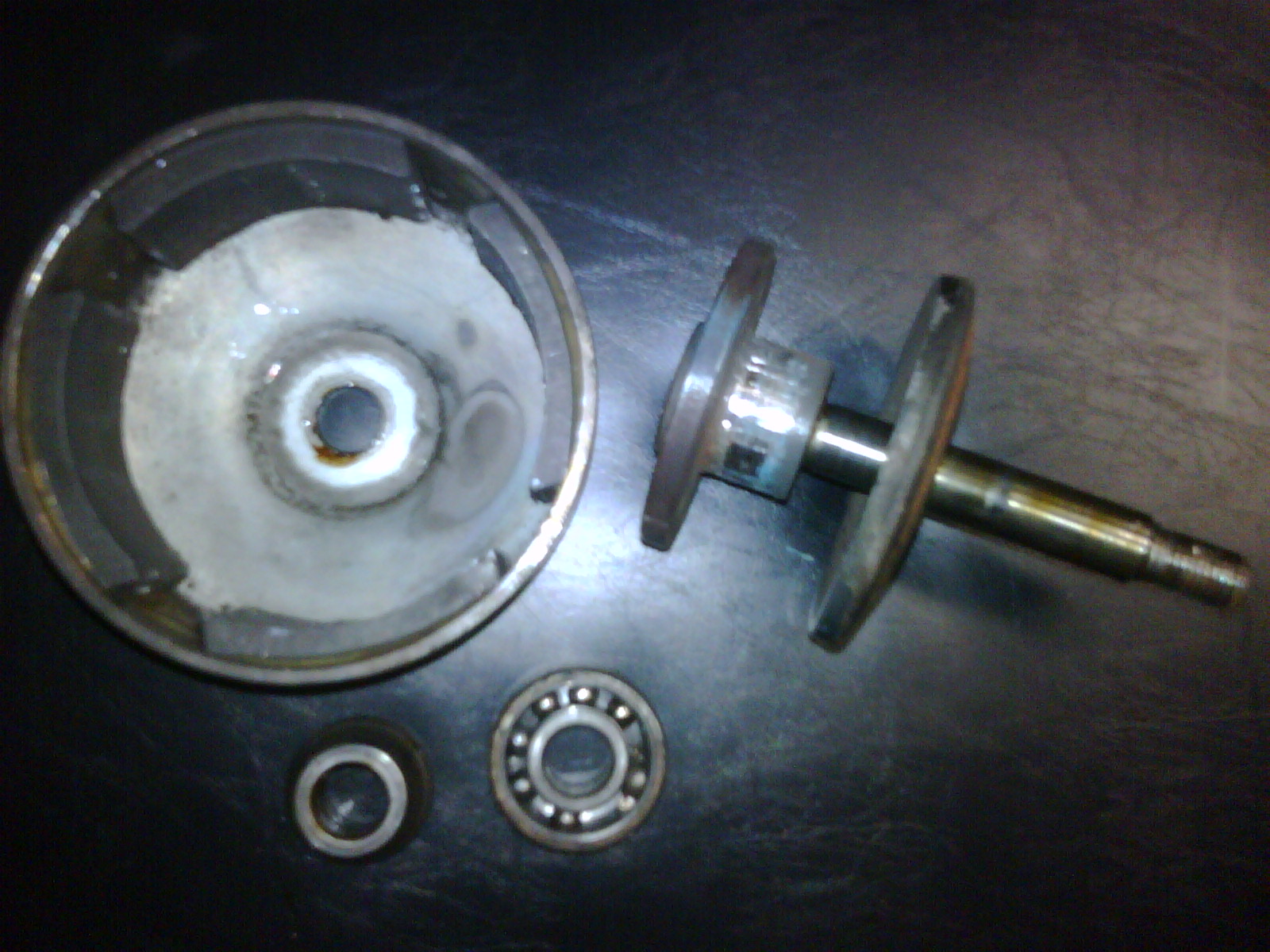

I finally got the front half of the dynamo disassembled. I ended up using a hammer and a punch to force the shaft out, after which the bearing finally came off. I attached some photos of the front half completely disassembled now.
I will order the new bearing next week and post a pick of what the new intact bearing should look like before installing it.

dexters, I was always under the impression my dynamo failed due to to much belt tension???:confused::confused::confused:
It failed at about the 1100 hour mark if I can remember correctly. The replacement was still working well at 3000 hours.
It may be something to consider.:D
