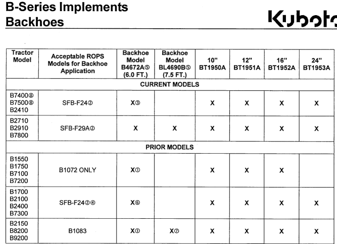

i am looking for a backhoe for my b7100. i have seen a few brands that fit. i was wondering if there was a list of model numbers that will fit
thanks Jason

Kubota B series backhoes
