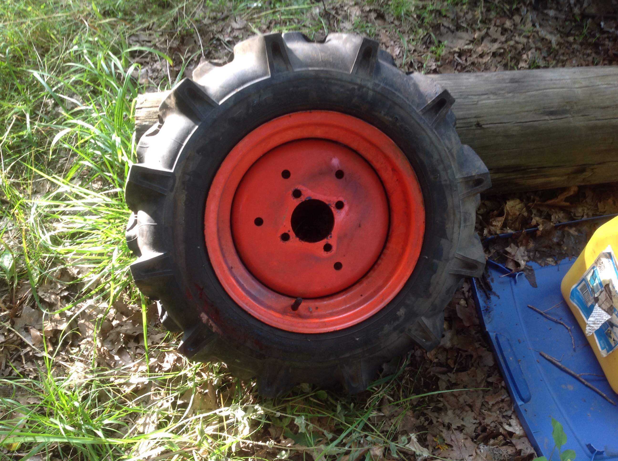

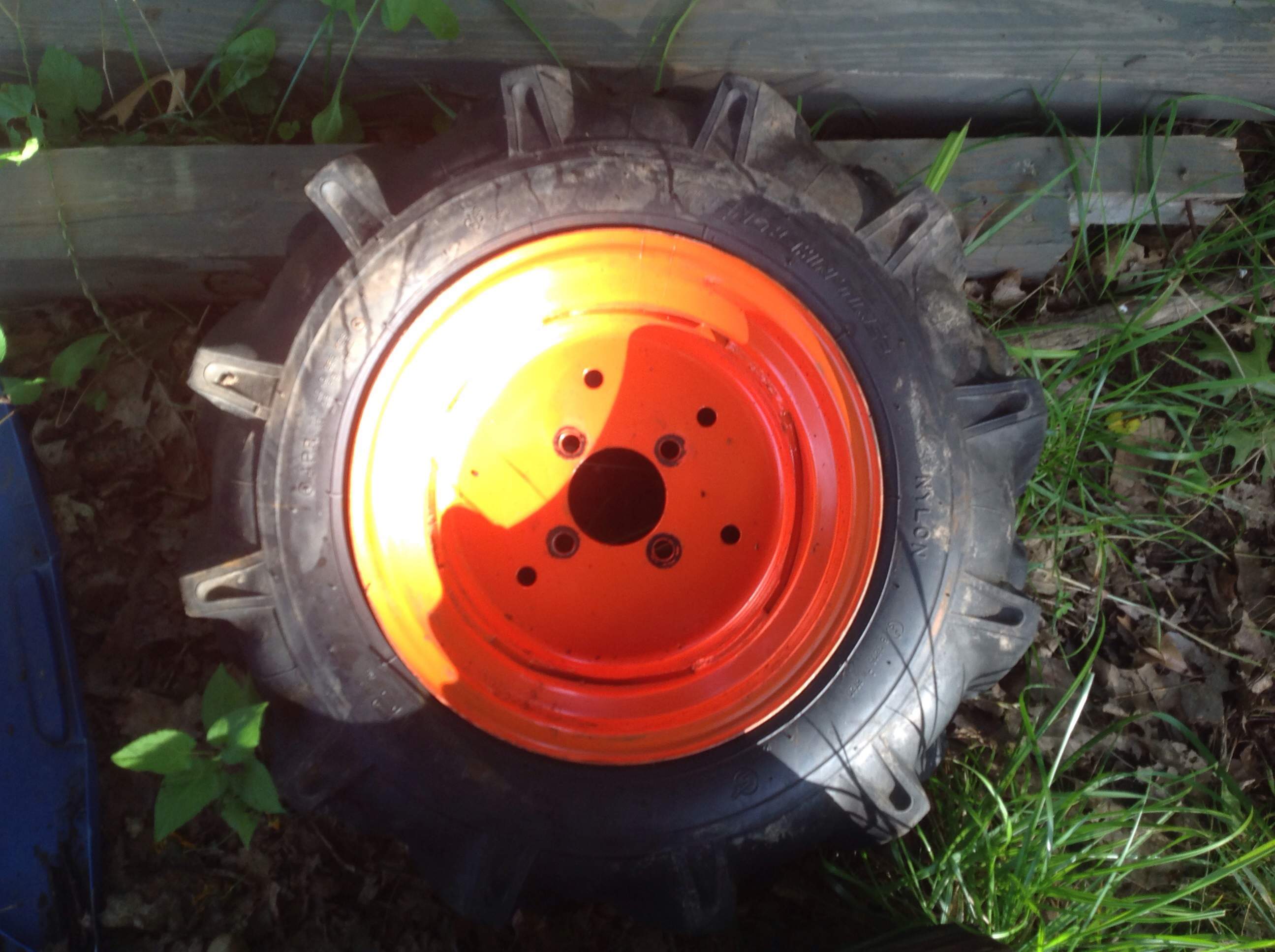

I just bought my first traactor, Friday. An older B7100 (I think it's a D model) but with pretty low hours on the seemingly working hours meter. Runs like a champ. Got it at an auction, with a brush hog, a blade and a three point trailer hitch. I'm very comfortable with the price I paid. I believe I got a very good deal, knowing ahead of time, that it had a one flat front tire, broken from the bead, and the other was pretty low, looking like it might need a tube.

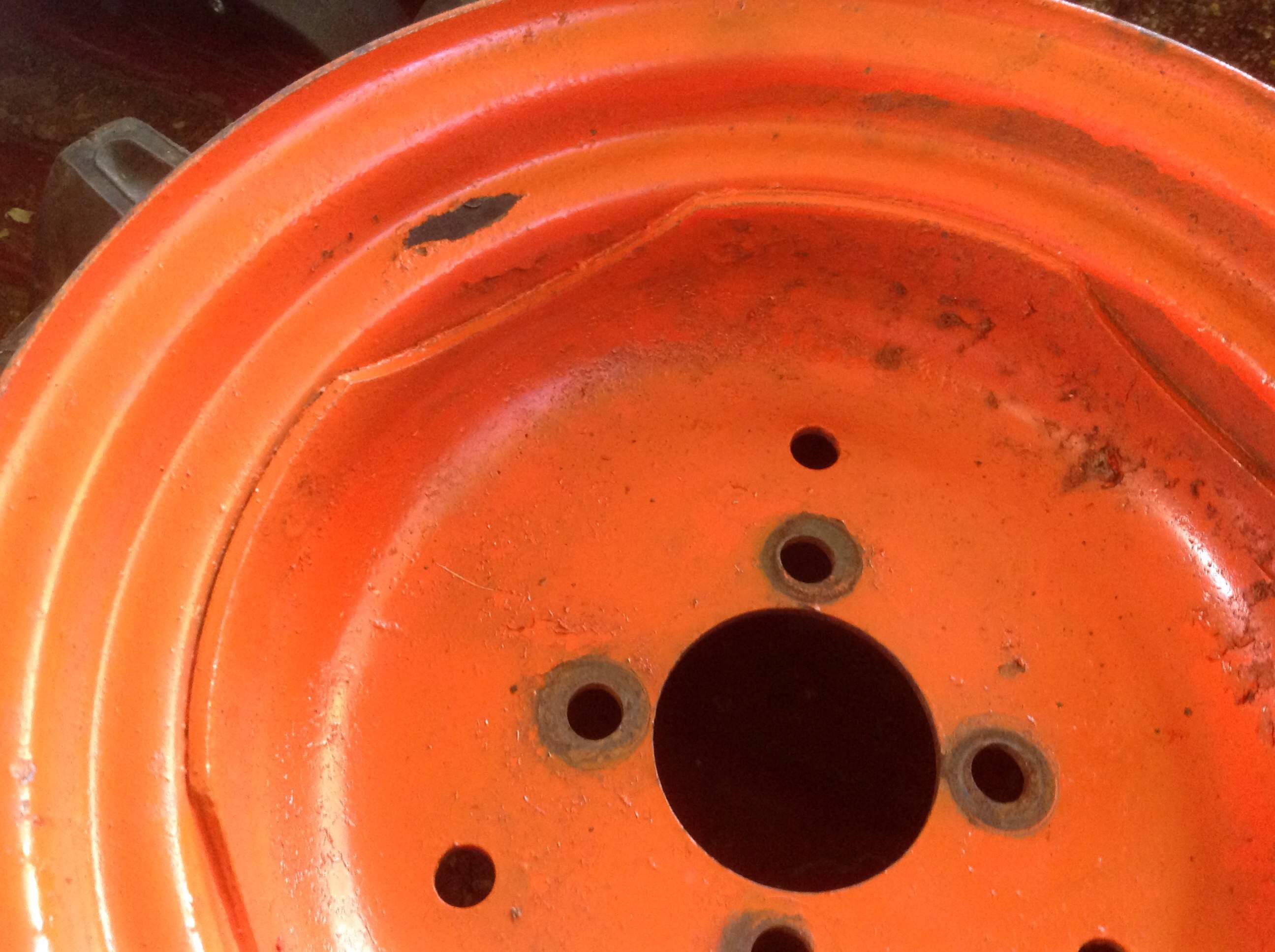

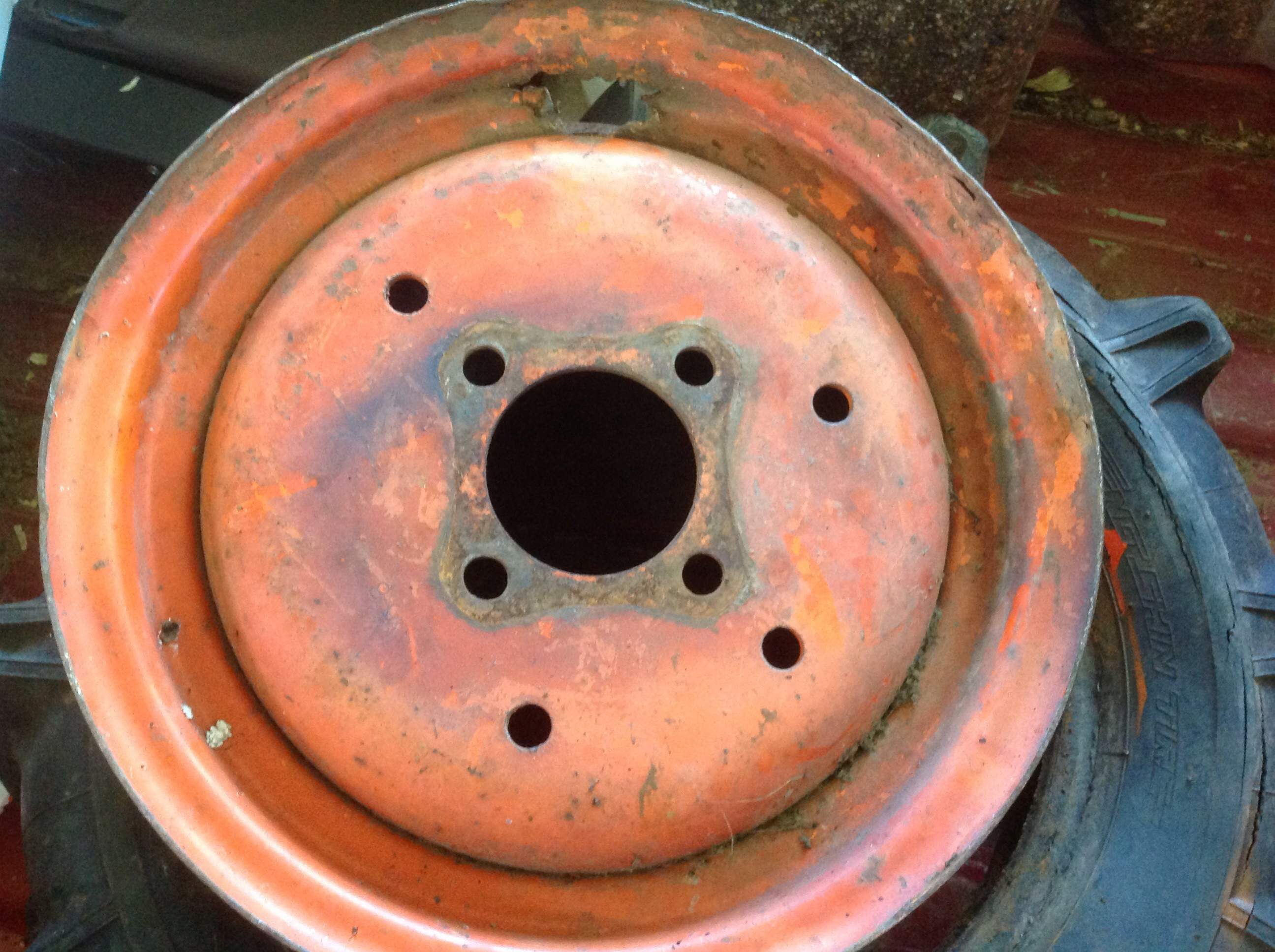

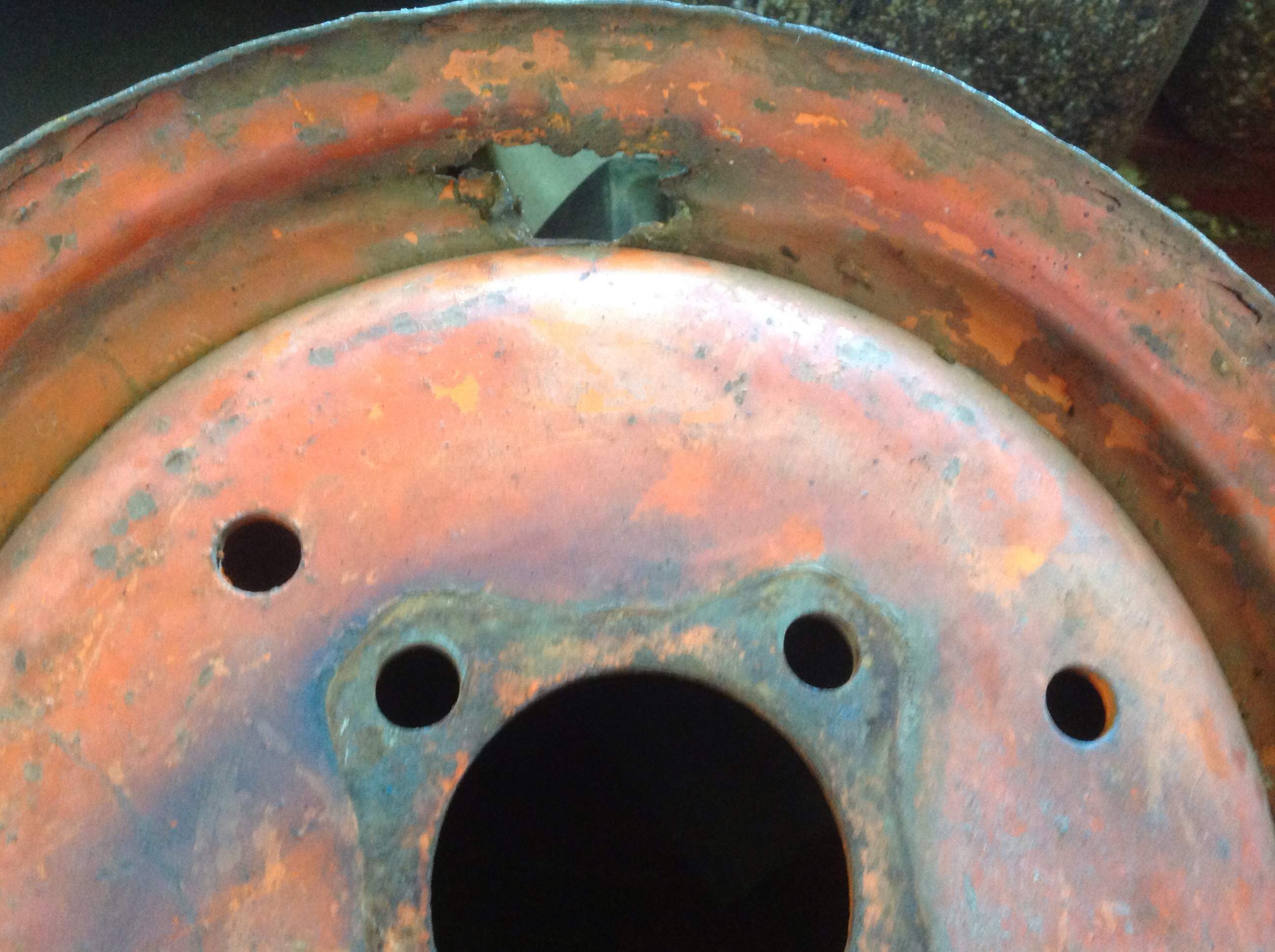

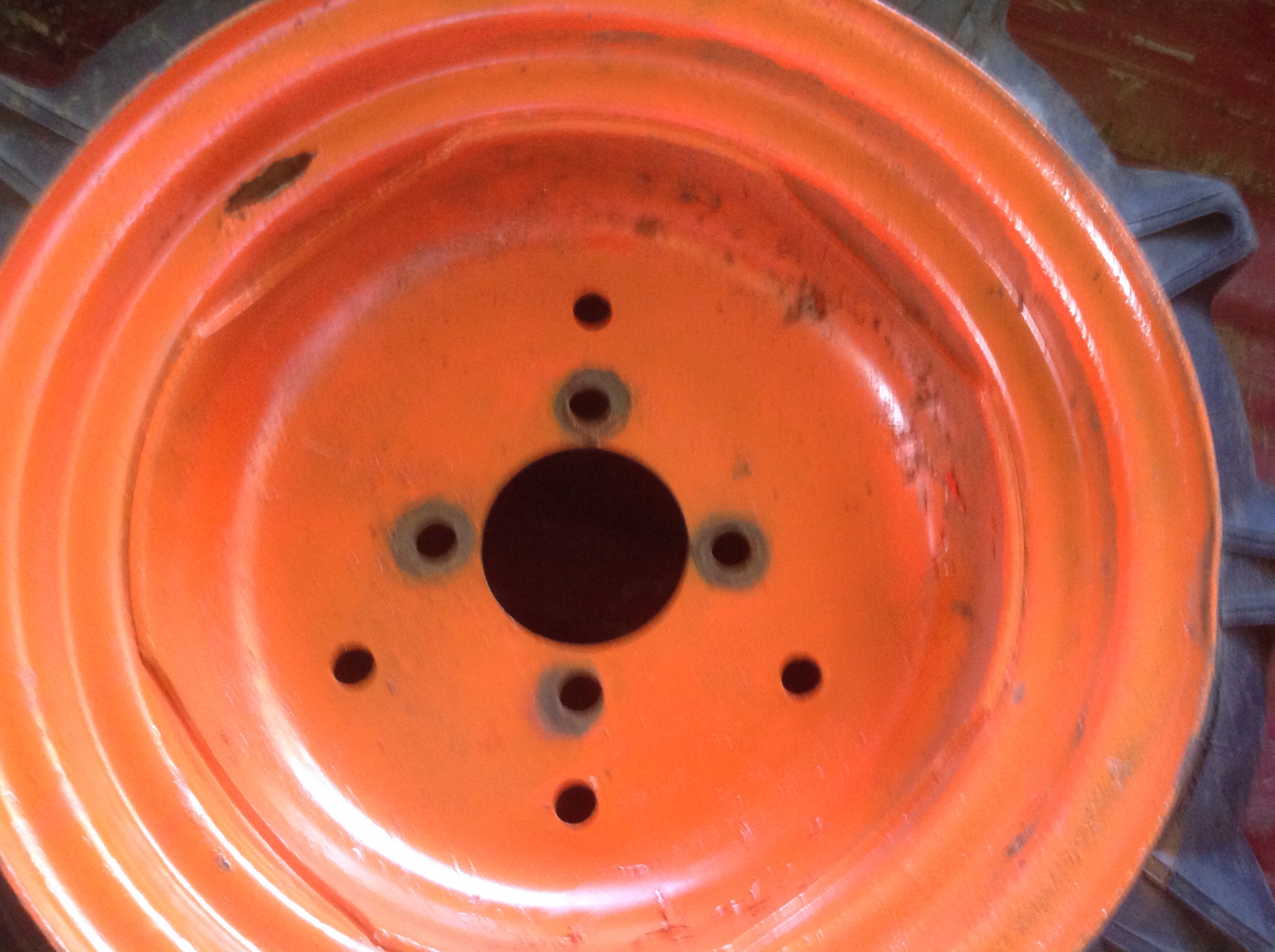

I bought it in Kansas City, and drove it down here to OK, and removed both front wheels, taking them to my local tire shop, for tubes. Turned out the one off the bead, was in excellent shape, and probably didn't even need the tube. The other, though, had a badly rusted rim, and the rim broke through, on both sides, rendering it a big, orange paperweight.
So, I'm looking around for a replacement, and all I can find, is a (I believe) Tisco wheel, sold by Farmland Tractor Supply in Oregon, for $90. I'll post the link, because Google searching for a wheel, brought me to this thread, and having the link, may be helpful, to anyone else looking, as this find was several layers down in searches.
Kubota 5X12 Front Wheel (12X5X4KU)
Anyway, if someone does have a spare wheel, to sell, please post it here, I'd like to buy it. Otherwise, I'm going to buy the one from Farmland, unless something comes up locally, here in the Muskogee - Ft. Smith, AR area, quickly. image.jpgimage.jpgimage.jpgimage.jpgimage.jpgimage.jpg

I would spend the money on a cheap welder. Since your going with tubes you could easily weld that up. I believe those wheels are hub centred so just use a larger washer. That will get you going until you can find a replacement.
/ B7100 4 hole front rim needed #9
David,
Actually, I was at the tire shop with my best friend, who is a master welder. His comment was, "There isn't enough structure there to weld to. You can't weld to rust." Apparently, by the time all of the rust got ground away, what would be left, if anything, would be thin as aluminum foil. Otherwise, that was my thought. I have some 22 gauge galvanized sheet metal, that I thought could have been tack welded in place, to hold the tube, but Travis (the welder) says that is asking too much of the rim. Another fellow, on another forum, has offered me the right rims, off of his B6100. I'm just waiting to hear a price.
