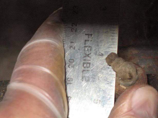

I recently picked up a B6000 with a loader, box blade and spike harrow. (I documented the saga in the Yanmar forum , where I normally hang out.) Long story short, it had some wobble in the front end that I didn't catch before I bought it. The top of the knuckle moves in and out about an inch. When pulled out:
And when pushed in:

I was incorrect. While the lower kingpin is worn, and it gives play in the knuckle, the worst problem was actually up top. Look at the top king pin, before I took the hub off:
It was bugging me all day, and then it came to me in the shower. The play in the lower kingpin was allowing the top to wiggle. The kingpin would sometimes float up and be loose, and sometimes float down, and hold. Look at it once it's properly set:
I'll fabricate some type of retainer to keep the kingpin secured down, then get it all lubed.
I still will need a bearing at some point, but this little guy is ready for a basic service and fluids change, then to be put through the paces and see what I need to do in order for it to be fully operational!
