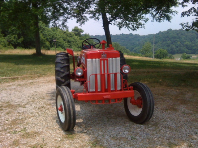

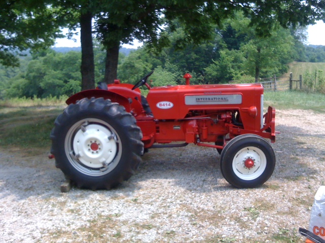

Sorry can't help with your ?'s I have had my B414 for two years without any trouble so if it works do not touch it. Thought you might to see what it will look like if you do fix her up.
Bob
