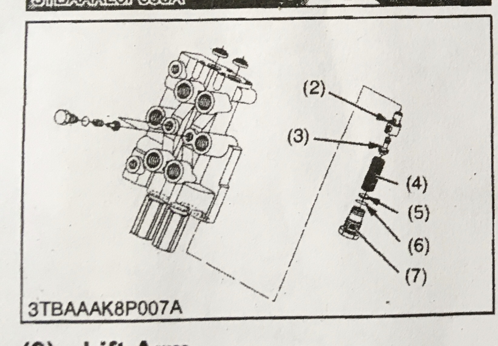

This is where it gets confusing. According to the B3200 Workshop manual, the shims go in on the bottom of the hydraulic valve body through the small hex head screw. (click on the photos to enlarge them)
Here's the diagram from the WSM:

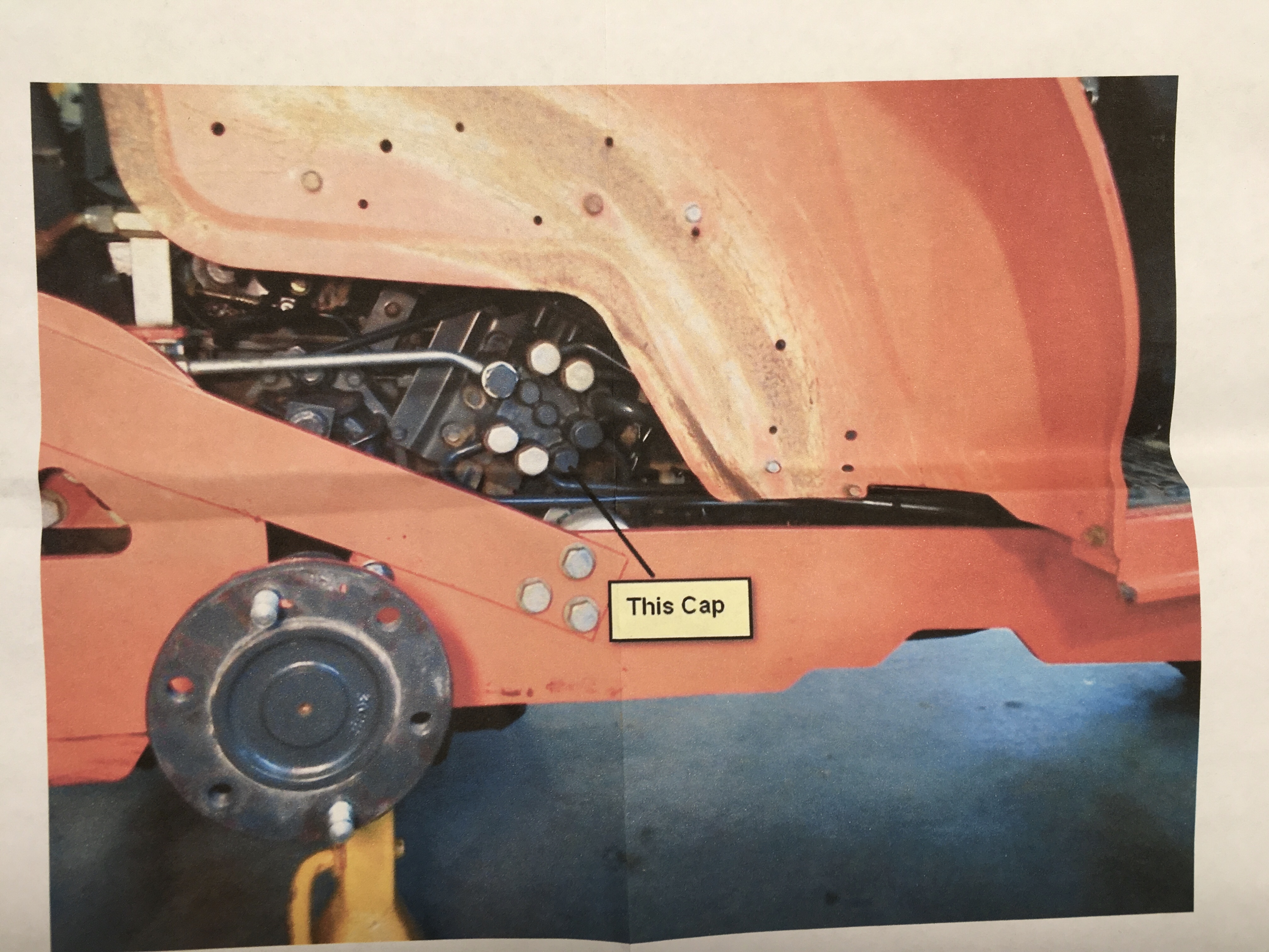

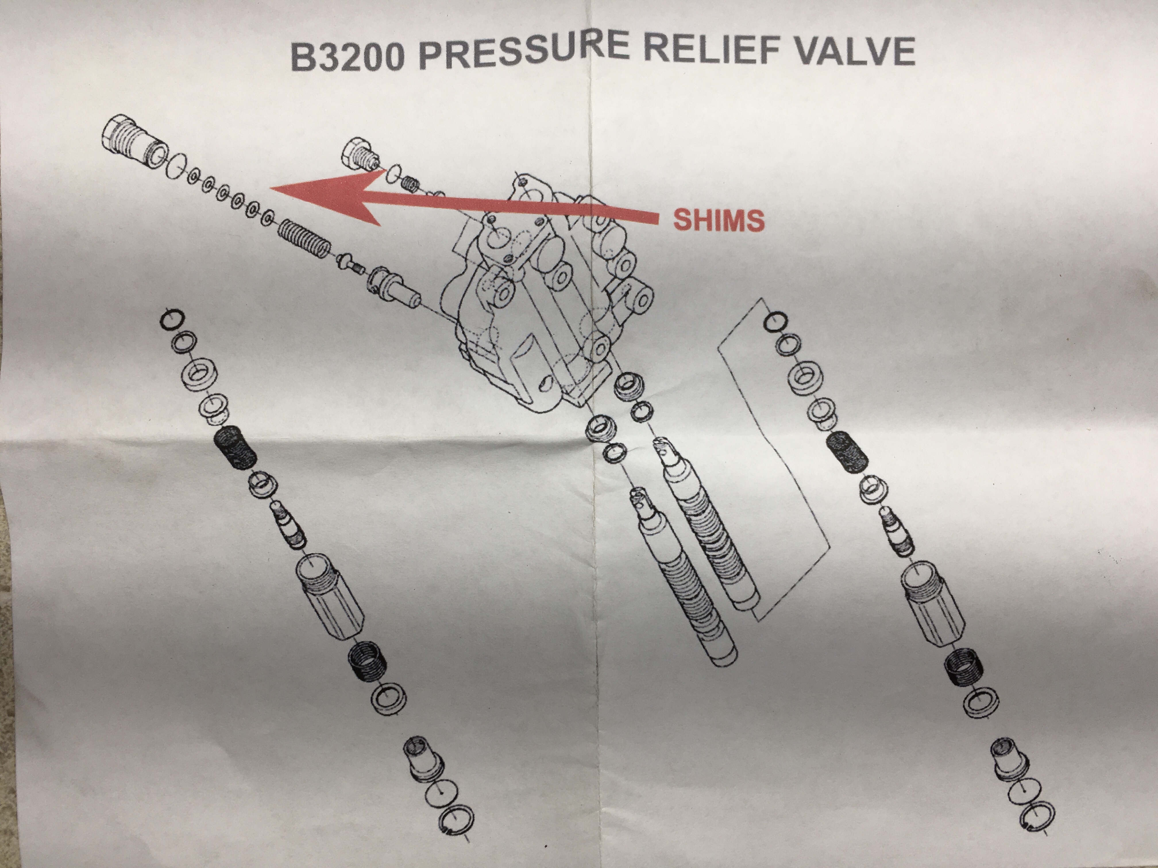

But, the info sent from Bxpanded shows the shims being mounted in one of the side connection points.
If I understand all of this correctly the WSM is detailing how to increase the loader pressure and I believe the Bxpanded info is showing how to increase the pressure on the entire hydraulic system. I only want to increase the loader pressure, the 3 point hitch works fine for what I need.
So, for those of you who have a B3200 and have done this, which road do I take? The small hex head screw on the bottom of the valve body or the larger port on the side of the valve body?

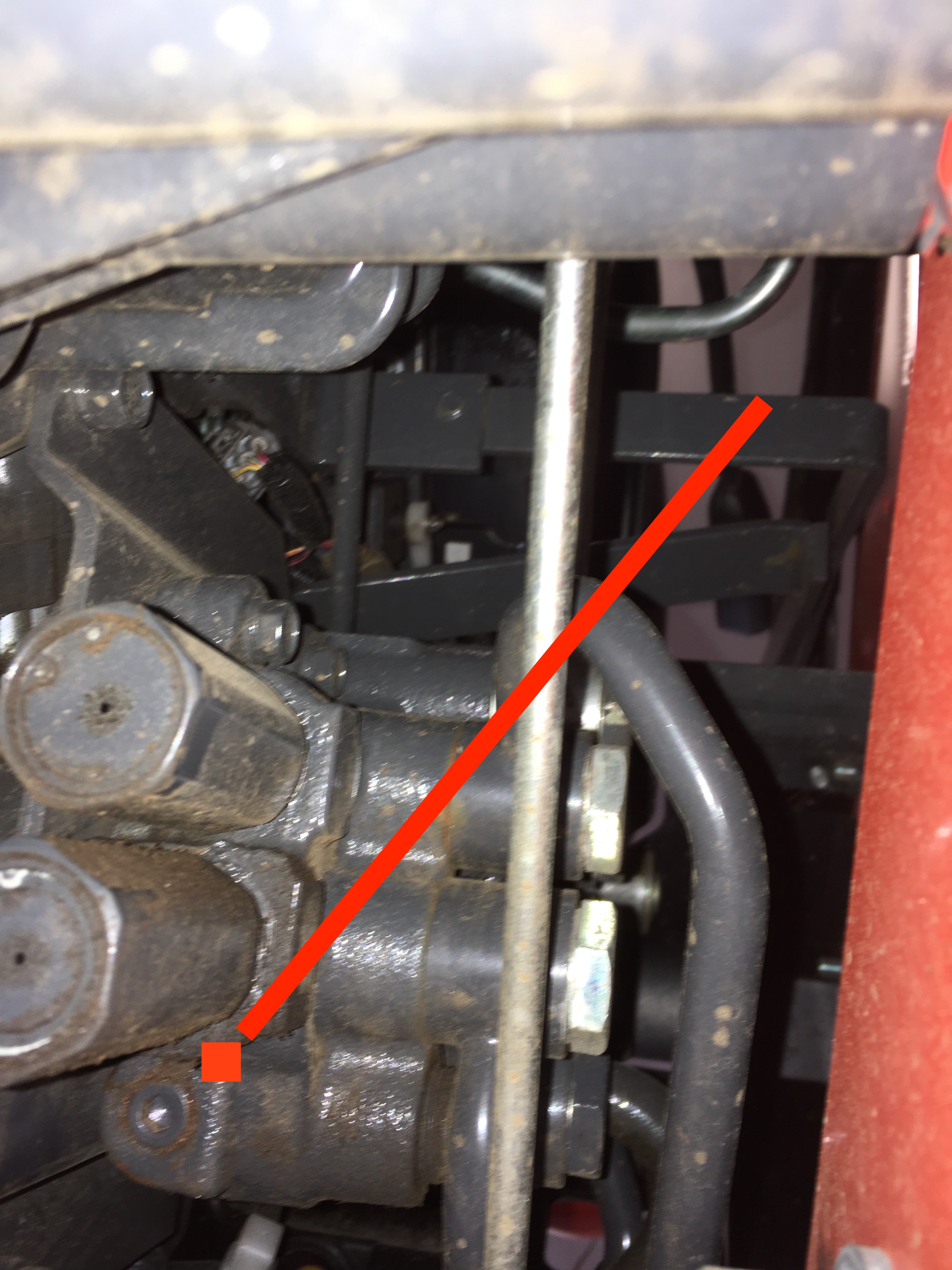

OK, answered my own question yesterday. I took out the plug indicated in the diagram on the Kubota workshop manual for the B3200. There was nothing behind it, no spring, no poppet, no shims, nothing. It looks like the the hex head plug is just that, a plug for draining the valve body. Apparently Kubota made an error in their WSM? Or, did they change the design of the valve body and not update the WSM? Anyway, at least now I know where I need to go to put the shims in. Take the wheel off and go in from the side as in the photo from Bxpanded.

Ryan at Bxpanded just sent me an email.
"I apologize if this is a duplicate response but the cap in the attached photo is the one you should use for the pressure adjustment; it will manipulate the pressure of the whole system. I believe the one in the bottom is actually just a plug that at some point previously was used to isolate the loader function. This particular valve has been used on MANY tractors and has been around a while so it's possible there may have been updates that were not taken into account when the diagram was copied and pasted into the manual for your machine."
That answers the question completely!
