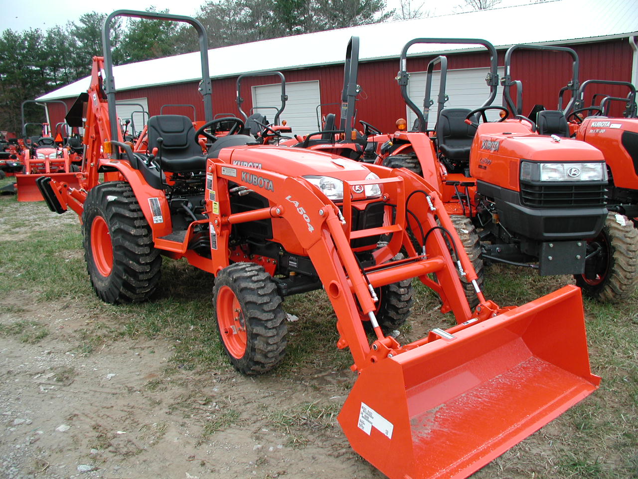

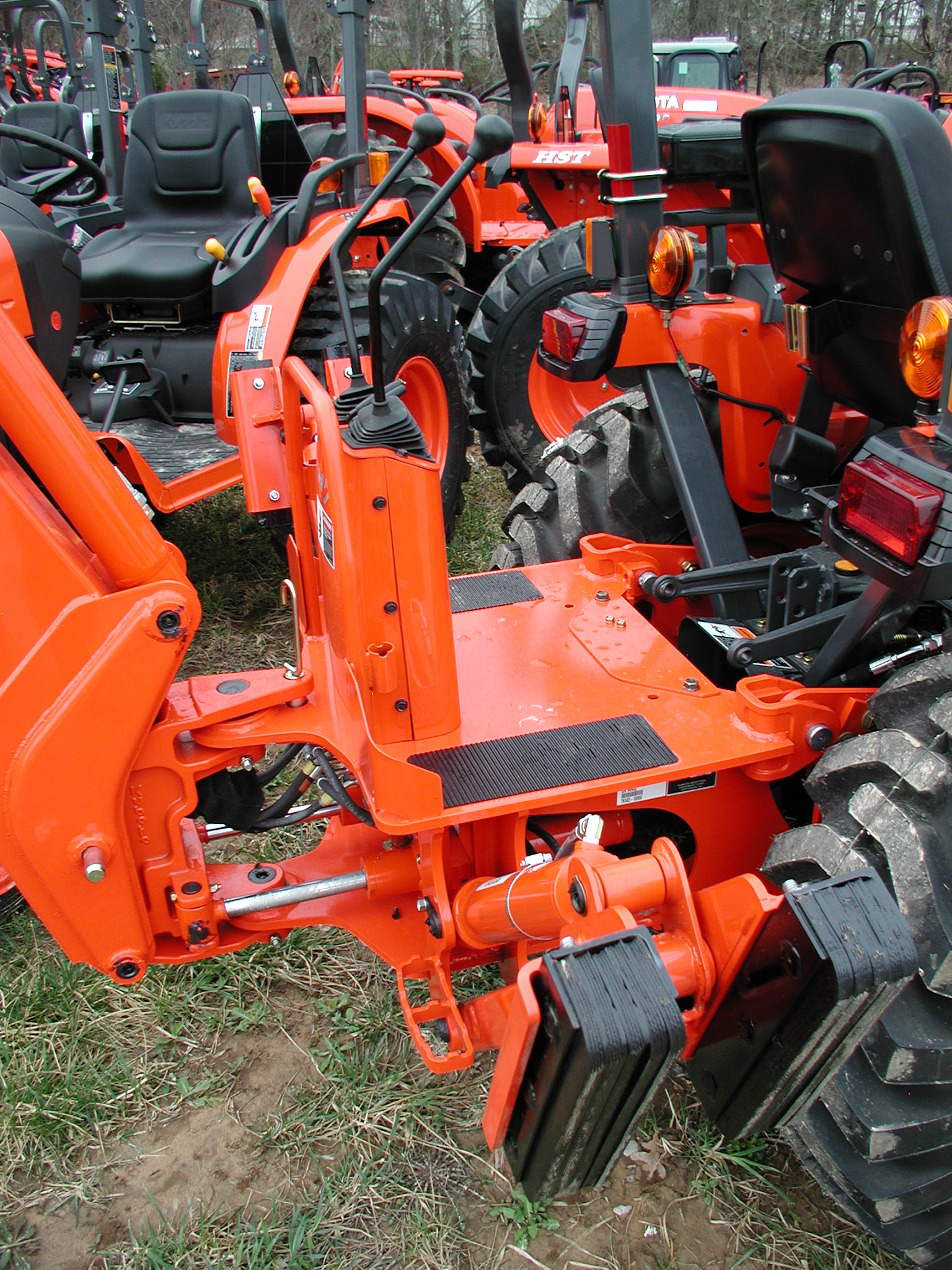

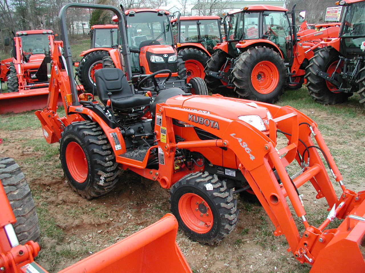

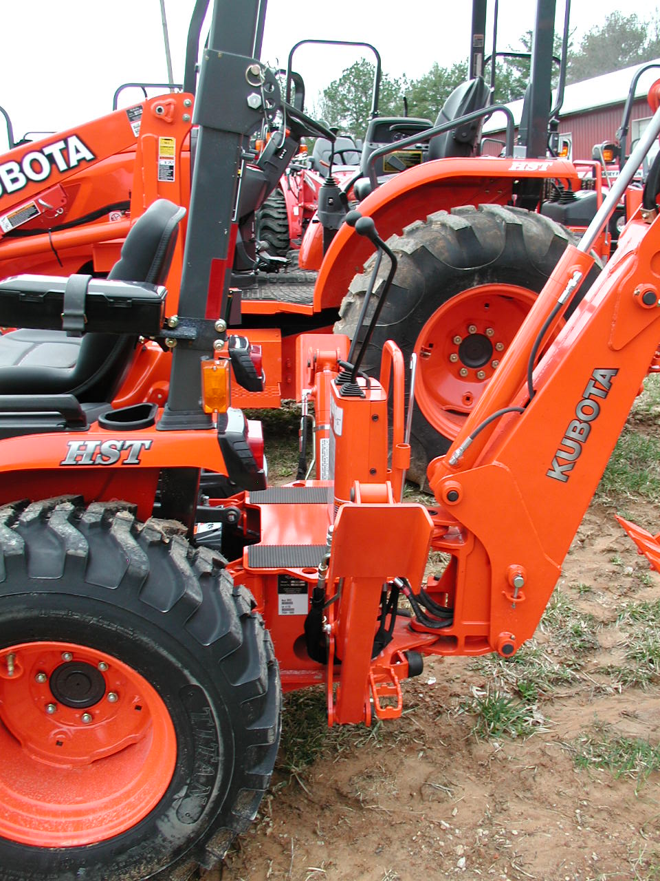

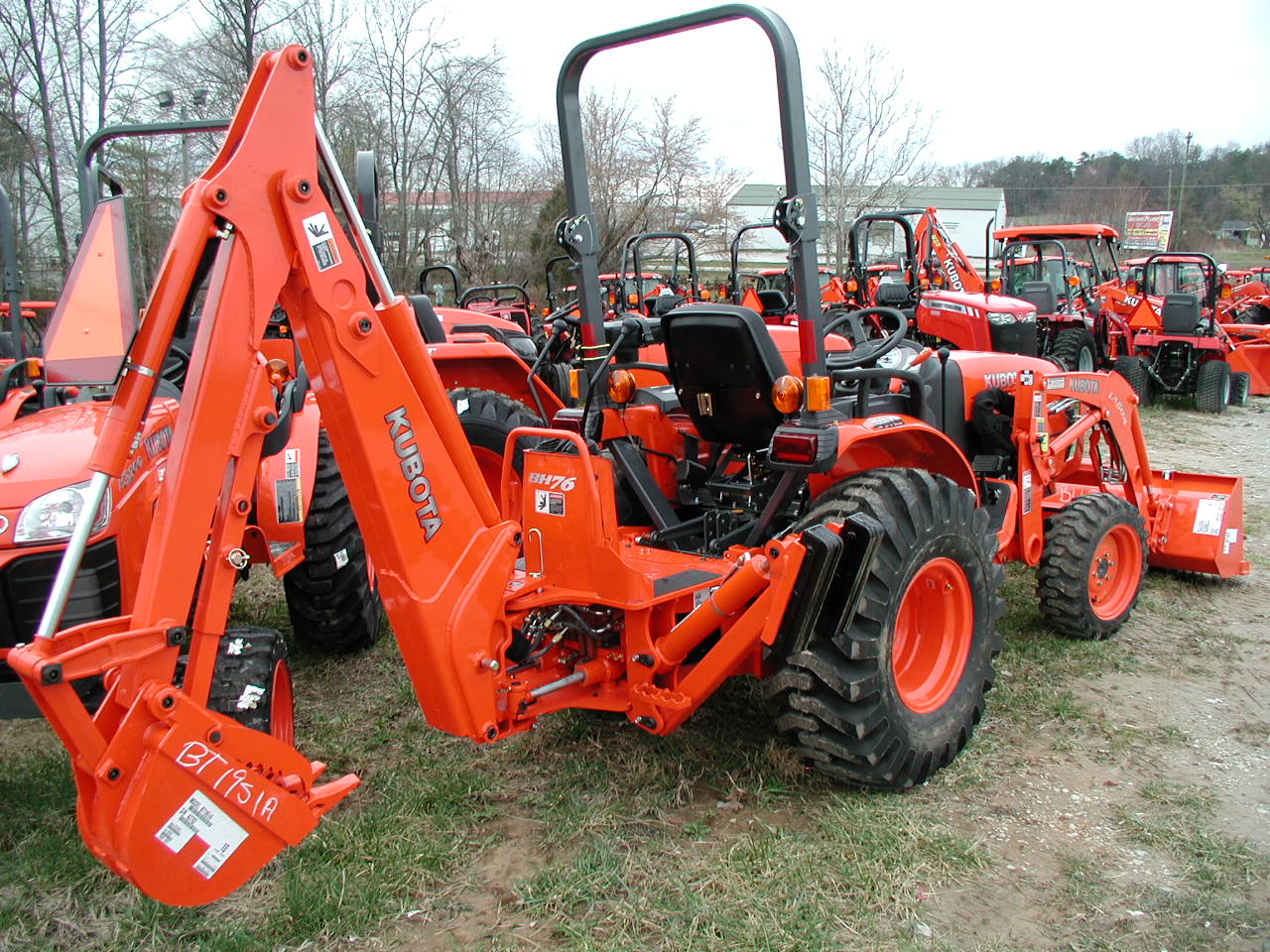

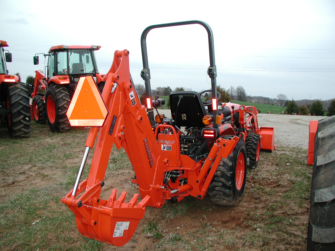

I have 2 properties - 2 acres and 24 acres - 75% off my tractor time is on the 2 acres. I convinced myself time and time again go "bigger" (I was upgrading from a BX22 TLB). I was 90% ready to go with the 3200....then I sat on both tractors side by side. 20 seconds on the 3200 seat told me go with 2X20. For my needs in the next 5+ years I knew I would be happier with the slightly smaller / nimbler platform. Also, when I looked at the 3200 BH arraignment it was much more of a "larger" platform than I needed.
My advice is sit (drive if possible) both - the expression I used in the past is you will have a "seat in the pants" answer....one that may surprise you and after you made the decision (which ever one you go with) it will be the right one.
Here are a couple of comparo pics of the 2920 and 3200 (took these when I visited Barlows - did you call them?). Not srue if you can tell but there is a BIG differance between the two.
The 3200 is an awesome awesome machine - I wish I had the application for it but MY needs just didnt warrant it at this time.
Sit on them both.
Good Luck,
~J
