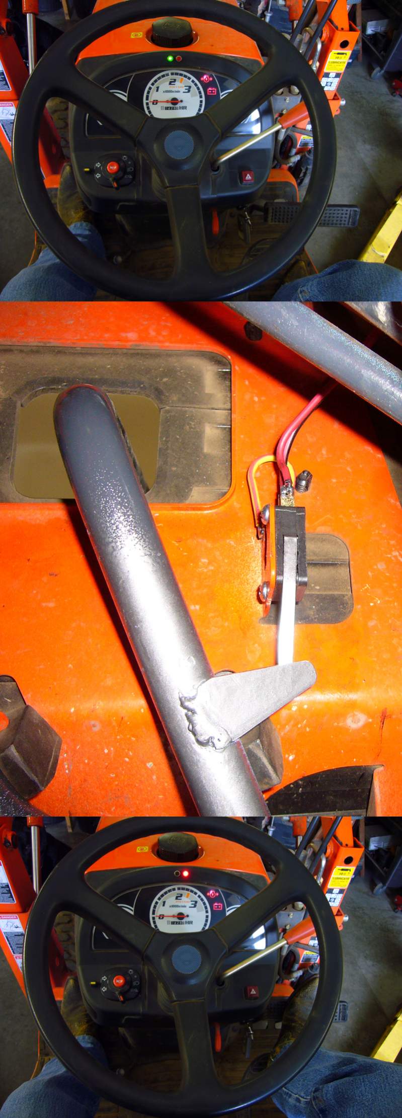

B3030 brake warning light system.
[FONT=Arial, Helvetica, sans-serif][FONT=Arial, Helvetica, sans-serif]I have driven off too long and too many times without realizing that the parking brake was still ON.[/FONT][/FONT]
[FONT=Arial, Helvetica, sans-serif]GREEN for "brake OFF". This serves as a circuit check.[/FONT]
[/FONT]
[FONT=Arial, Helvetica, sans-serif]One of the lights is always illuminated. RED for "brake ON"[/FONT]
[FONT=Arial, Helvetica, sans-serif]The levered micro switch is a grounding single pole double throw switch[/FONT]
[FONT=Arial, Helvetica, sans-serif]and the LEDs are powered from the key switched source at the signal-horn-head light switch.[/FONT]

You make a good point :p. I just finished the mod today so I have yet to find out if I notice the light. Hopefully being as close to my line of sight as possible will help and I do check my gauges more often than my brakes :thumbsup:.

Just a thought here: When you look at the two lights only one is always lit and they switch instantly each time the brake pedal is depressed or released. Green is for "good" and red means something is wrong. I really don't see how anyone would actually need a "BRAKE" label considering the owner needs to install his own warning lights. Just sayin' is all.

Sorry about the lost pic in the first post :eek:.
