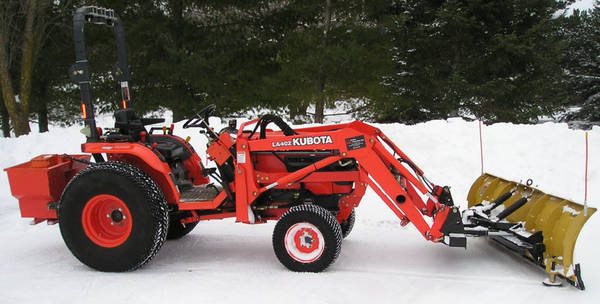

Can a B3030 handle a snow pusher? Total tractor weight with weight box is approximately 4000 lbs.

Hey Lawnking, You already work that poor new tractor all summer, now you want to work it all winter too??? Hahahahaha!!! Check out this pic, don't know the owner or history but looks like a great idea to me!! :)

I like the tractor, i like the weight box, i dont like that plow set up! If i was going to plow with my tractor, i would use the kubota blade on the subframe. I had the kubota 2069 power angle blade on my B7500, that was a sweet set up! Im refering to a protec snow pusher (box) in this thread.

It's my tractor.
Using the FEL for a pusher may not be enough power when the pile in front of the pusher gets heavy. May be able to push load, but will need to be in low range. I need angle to move snow off to side.
I would worry about enough weight with pusher mounted on front of tractor. Will not be enough weight to push heavy snow.
