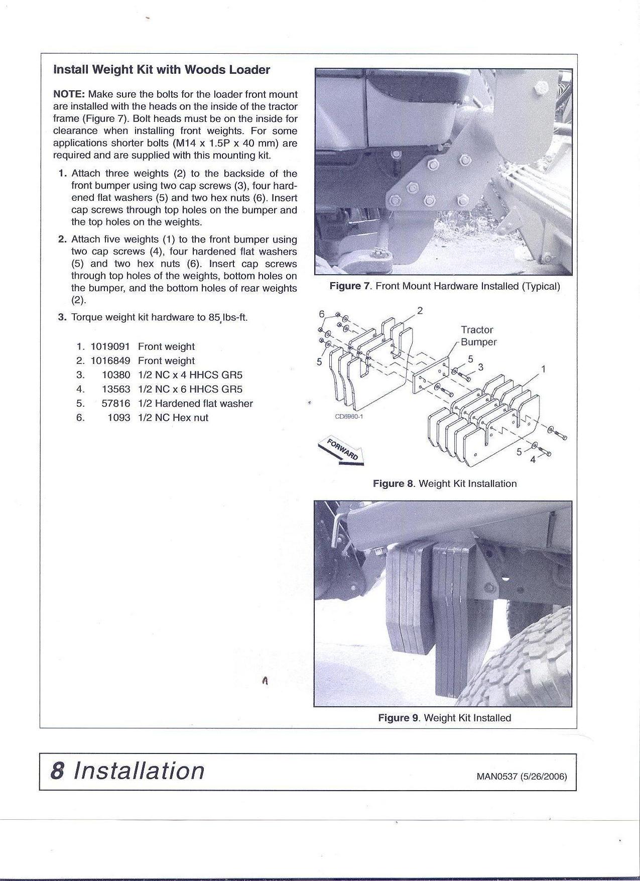

I've seen the Woods BH70x backhoe mounted on B7510/B7610's, and it works with the addition of front weights as my attachment shows. I would expect that Woods will have a subframe to fit the new B20 series before too long.

Just my opinion......... but i've seen a couple of the 75/7610s with the woods hoes / front weights, and they look foolish to me. I think having to add that kind of weight to keep the front wheels on the ground means your backhoe is too dang big !!

Got to work on a couple of them with that hoe on. Seems to me the problem was keeping rear axle seals in! Thought it was from axle flex from the additional weight.

I think the Woods Bh70x hoe is a bit much for the B7x10 series too, and I attached a pic of the weights, so folks could see just how much counterweight is needed. It also looks like a pain to take those weights off to use the front quick hitch, etc. too. I am pleased that Kubota came out with the Bh65 for the new Bxx20 series. That is what I would choose in this size tractor. The digging power is the same as the JD 46 (surprising there huh?) though not as powerful as the Kioti 2465, but the Kioti is also a heavier tractor. After using a BX22, my opinion is that more digging power, or reach needs more tractor. I think the B7800, etc. is well matched to the Woods BH70x, and I'm not positive that I would put a BH80x on an L2800........ maybe.
