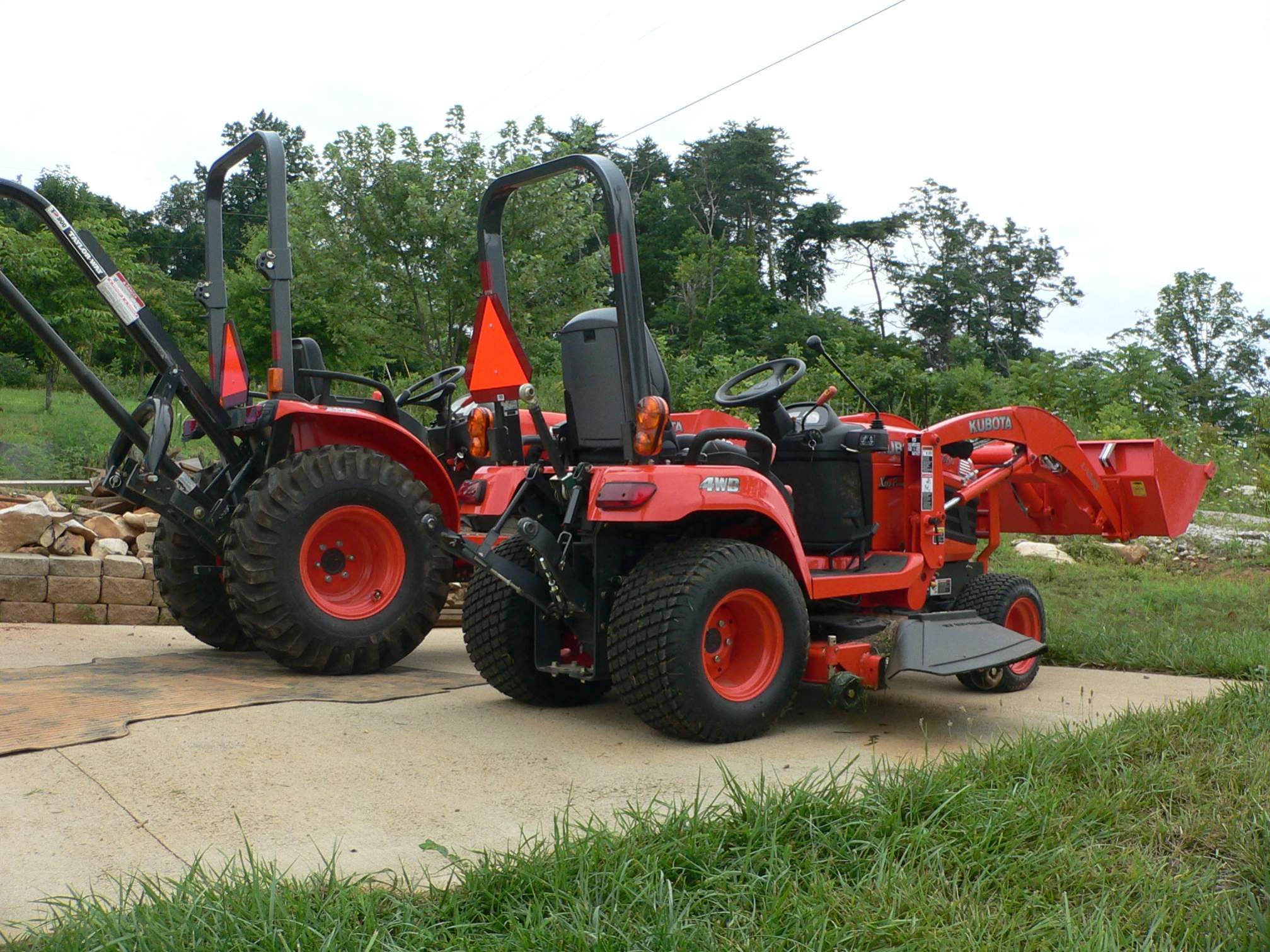

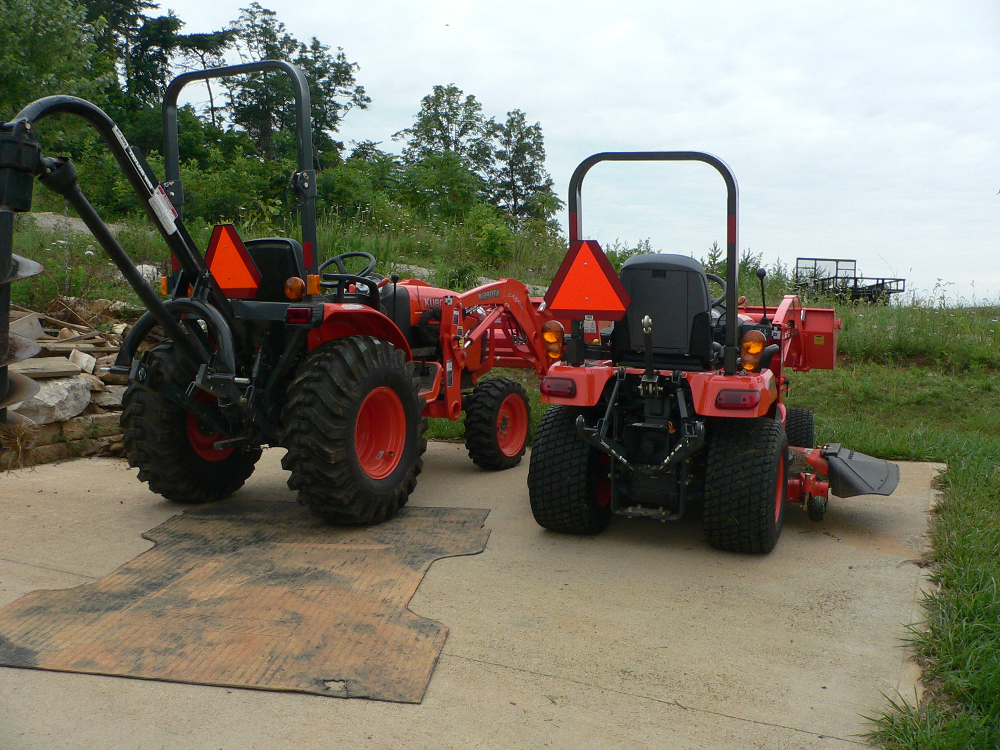

I am definitely getting turfs unloaded for my lawn but I would also like a second set to have the rears loaded for better traction with the box blade and better traction on dirt or a little mud. Anyone have pics of the turf/bar combo set? any thoughts on R4s vs ags?
   / B2x20 tires turf/bar combo or ags? pics? #2
Here's what I buy. Haven't seen any yard damage and I don't do mud except when I have to. Have never given serious thought to ags.

Gonna assume you know what a turf looks like on a Kubota.
Here are Ags (R1) what Kubota calls Bars on BXs.
Also a photo of R4- Industrial tires. Popular compromise tire between turfs and Ags.
