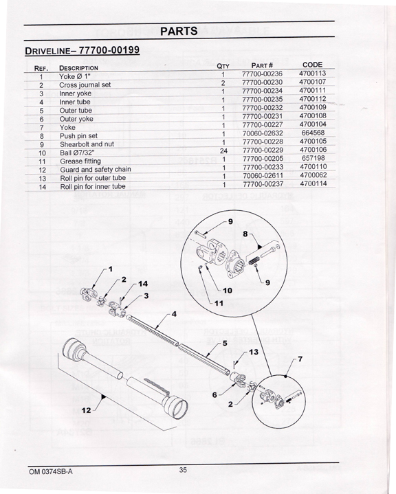

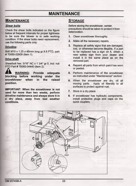

The manual for this blower lists one size of shear bolt and its part # for the drive line on on page 23. On page 35 in another exploded view, the same part lists another size of shear bolt and a different part #.
It does the same thing for the shear bolt on the drive shaft. Page 23 lists one size and part #, page 30 lists a completely different size and part #.
Has anyone else noticed this and which one should be used in each application?

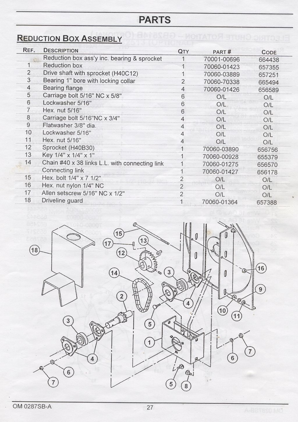

Like 638, I was confused on your model number? I've seen B2781 51" blowers, but not the model number you have. Not sure if this is going to be much help, but I have a BX2750 50" blower and have a shear bolt for the fan (#6 on page 23 below.) Is that one of the bolts you are talking about and do you see a bolt in either of my diagrams that refer to what you are asking about? Dyer, retired

Thanks for help but this is definitely a different blower. I just purchased this one but the owner's manual is dated 01/08 so the model is at least a year old. I just find it odd that for the same location on the machine, the manual lists one bolt on one page and another bolt on a second page. For example: the driveline shear bolt on one page is a M6 x 40mm but the other page calls for a M10 x 45mm. That's a big difference in size energy required to shear the bolt. The parts department at the dealer had never seen anything like it before, mind you they were quite willing to sell me all the listed bolts just in case I may need them. I'll try to post the pages from the manual when I get to a scanner at work. Thanks again.

Exactly. I've got a shear on the driveline and a shear on the driveshaft and the manual states two different bolts for each location.
Look at the bolt for the driveline in the photos. Page 23 states to use a M10 and gives a part number. Page 35 gives a different part number for the bolt (#9 in the exploded view) and when I ordered under that part number, I received an M6. It's the same case for the drive shaft shear bolt. You'll see on page 23 it calls for a 5/16" NC x 1 3/4" gr. 5 and yet on page 32, the driveshaft shearbolt is #37 and calls for a 1/4 " NC x 1 3/4" grade 5. (The difference on the driveshaft bolt isn't as radical as the difference in bolts for the driveline.)

I know this is an old post but for the benefit of others that may be looking for the answer... I have the exact same model blower and the same problem with the manual. The bolts identified on page 23 are too large. I found the specs in the rear of the manual on pages 32 and 35 to be correct, or more specifically:
Product ID: 77700-00228
BOLT M6x40 GR. 8.8 AND NUT
Product ID: 77700-00206
BOLT, SHEAR 1/4x1 3/4 G5 w/NUT
Hope that helps...
