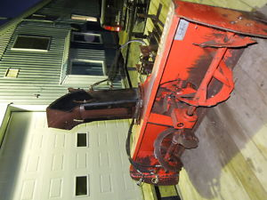

I have the chance to purchase a well used b2782 front mount blower for my b2920.
Has quick hitch and mid PTO kit
Hydraulic rotation and deflector. $1200
5k new.
Seems like a good deal opinions and anything to check for?
Imbalance rotor, bent auger

Had one on a BX23 TLB , B2750 if memory serves me right. Check behind blower where gear box and chain gear are attached, check for play which would be a bearing issue. Also look at front drive shaft , both sides for worn universals , second stage fan turns without hitting along with auger. Sounds like quite a deal.

Yeah I have a 51" now (4 years of residential snow removal) with little issues. This unit has done up to 50 drives per snowfall.
Second stage bearings failed and where changed.
I plan on buying this bigger unit and selling my current one and possibly turning a profit.
Will change gearbox oil, auger gear oil, all bearings and repaint.
Will see when I inspect it.
Thanks for the tips
