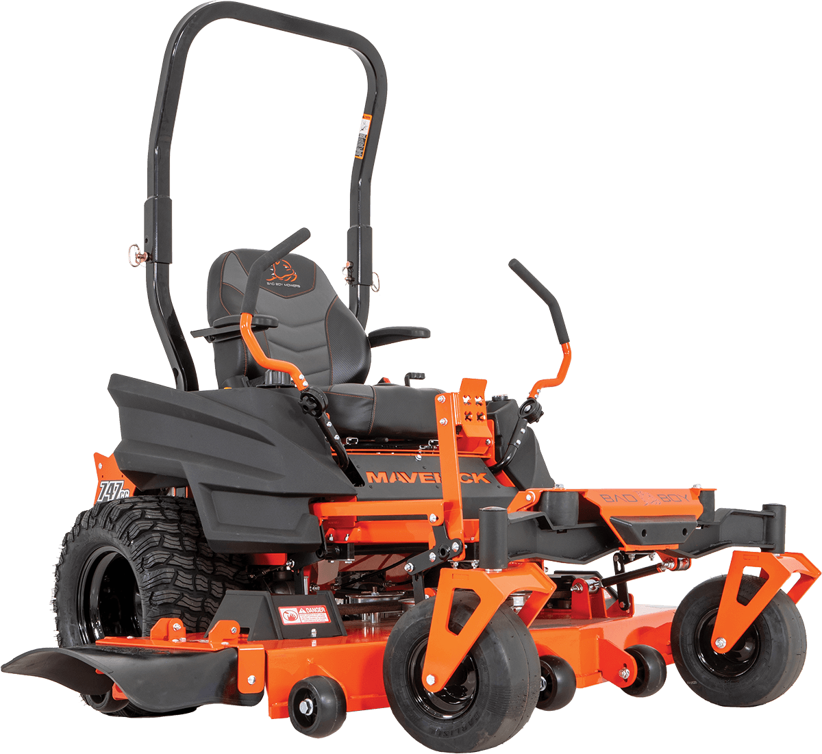

Perhaps keep most of that $1400 in your pocket and buy some better tires for the Husky. ;) Get rid of the golf kart tires and get some aggressive treaded boots. The tires on my new Bad Boy have wicked traction at 7psi. The mower nearly climbed a tree when I got to close--Even with ROPS folded down. o_O I mow the ditch along the road in front and the mower just laughs the whole time. (My big cutting tractor is still in pieces for a refresh.)
Here's what the tires on my Maverick look like.

Hmmmm. Hadn't thought of that. What is the make/model of those tires? I can't find anything like that using Google.
Well, I had to go out and look. All I see for a name on the tires is Bad Boy. So I guess they had those made for the mower. The mat on the foot rest area matches the tire tread design. I looked too and many places claim to have the tires but none match the three-leaf tread pattern. There are many with just as aggressive design. I guess you'd have to go through a Bad Boy dealer to get the 2021 Maverick tires.
