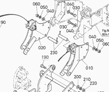

I've been looking at purchasing a B2650 and noticed on Kubota's website that the Cab version has a seat for the BH77 attached to the backhoe frame. Would it be possible to use the Cab version of the BH77 on the ROPS tractor? A quick look online at the parts diagrams shows that there is a mount kit for the Cab version that has spacers (parts 010 and 020) to push the BH further out.
Dave,
That may very well work, but I'm big on aesthetics. I don't like the add on seat look. It reminds me of the rental unit from across town. I wanted an integrated machine that looks like the backhoe wasn't an afterthought, it's actually one of the reasons I didn't go with the Cab version. Adding an extra seat is completely unnecessary if they would only redesign a few pieces of the seat suspension / brackets.
