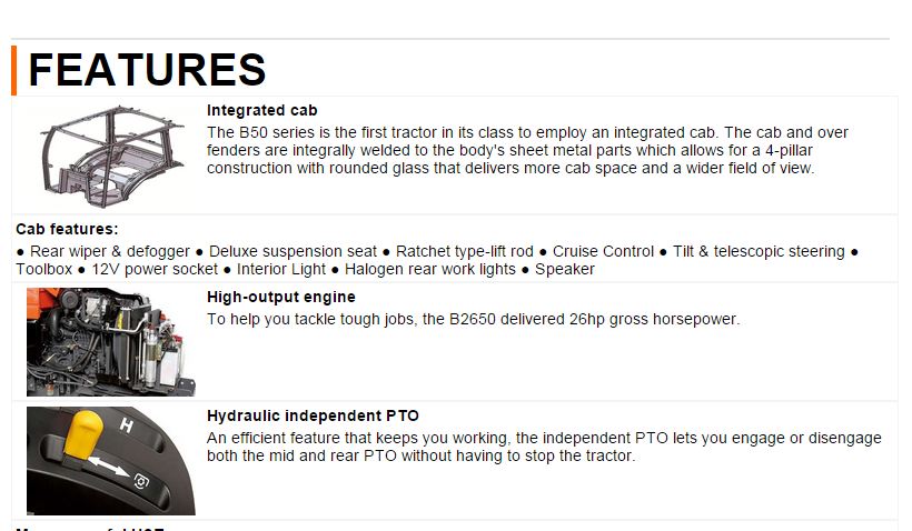

I had posted earlier that my B2650 hydro noise was excessive. To follow up I now have the tractor back from the dealer. They found that the cab was not mounted correctly and was rubbing on the transmission. I am happy to report the noise is now greatly reduced - except - when I use the cruise control. Has anyone else had this issue?

CLICK IMAGE TO ENLARGE
I'm a bit confused..the cab is integrated and comes from the factory .... don't undersatnd how it could be rubbing on the transmission...I'm going to chck mine out and try to figure out the dealers explanation.

They probably adjusted or added rubber to the isolator that looks like it cushions the cab from the frame. My 3350 has some expanded foam/rubber things that look like they cushion parts of the cab. Could be the folks in Japan got things wrong.

Kanook - I don't understand either, the parts breakdown for the cab shows that the cab is mounted with two rubber bushings.
