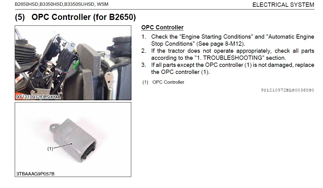

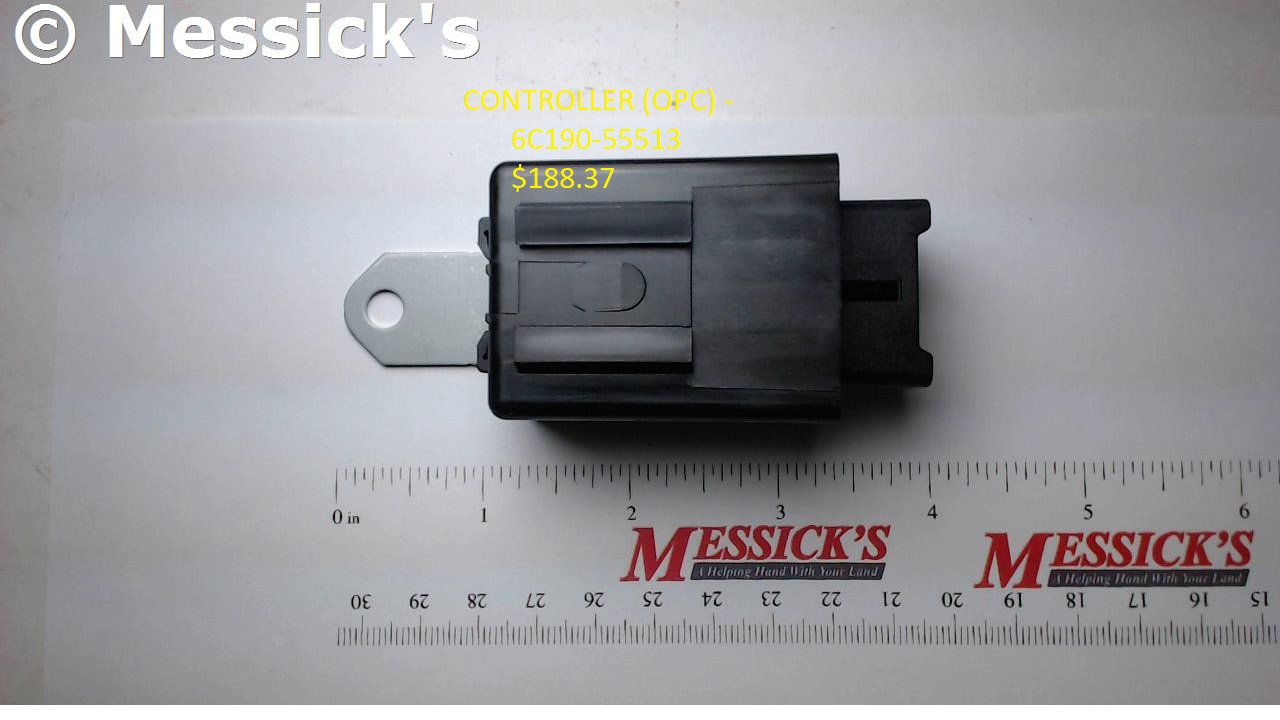

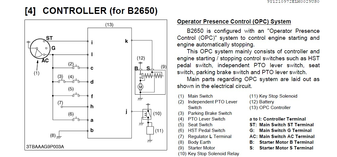

I am inclined to think the OPC controller is bad absent chewed or rubbed wiring.

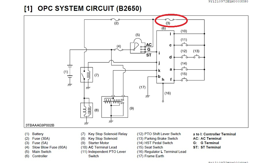

My hunch is that the HST pedal switch (14), or it's wiring, is shorted to ground.
I had an old Bolens G-14 that did the same thing.
Good chance. Tractor runs and there’s no short as long as he doesn’t push the pedal. The same pedal that hasn’t been working right to start.

It is almost always the HST safety switch that has failed, shorted to ground.
   / B2650 five amp fuse keeps blowing #10
I replaced the neutral safety switch on my tractor and it fixed the problem. It was not easy to do on my cabbed B2650, I’ll tell you that!
