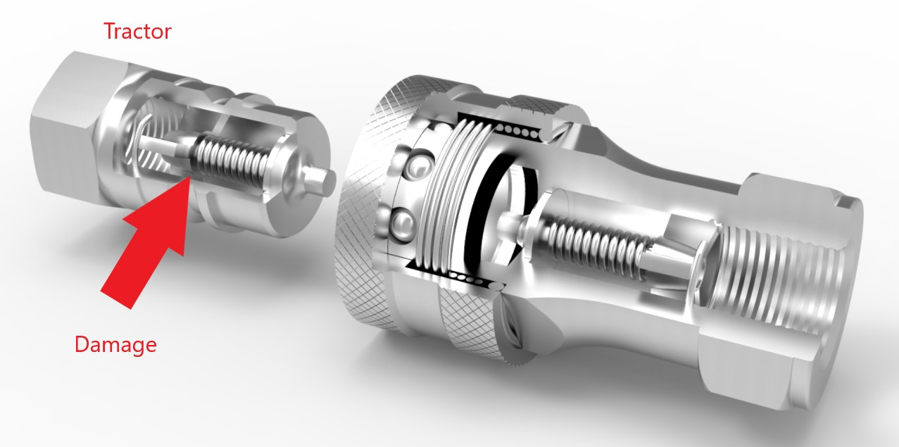

From your description this is my best guess without troubleshooting it myself. When you meet resistance lowering the boom it means you have increased pressure on the side of the cylinder pushing the rod back in. If the valve stem/spring is damaged/weak on the tractor side of the coupling it may be allowing the valve on the loader side of the coupling to slam shut as soon as the control valve is released. With that valve in the coupling seated, no oil can get out of that side of the cylinder so you can't pump oil into the extension end of the cylinder and lift the boom. Relieving that pressure allows the weak spring to get the loader side of the valve off the seat again and everything goes back to normal. I'd check the fitting on the tractor side of the coupling of the hose coming from the far end of the boom cylinder.
Thanks or posting the picture. I always wondered how they worked.
