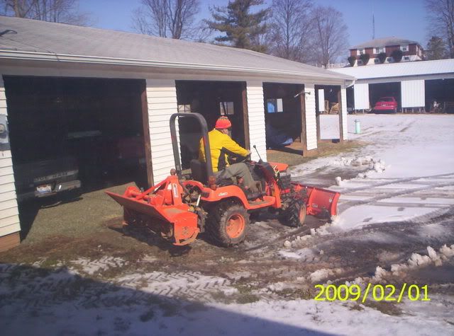

   / B2630 - how big a tiller #10
My 48'' tiller on one of my BXs.
