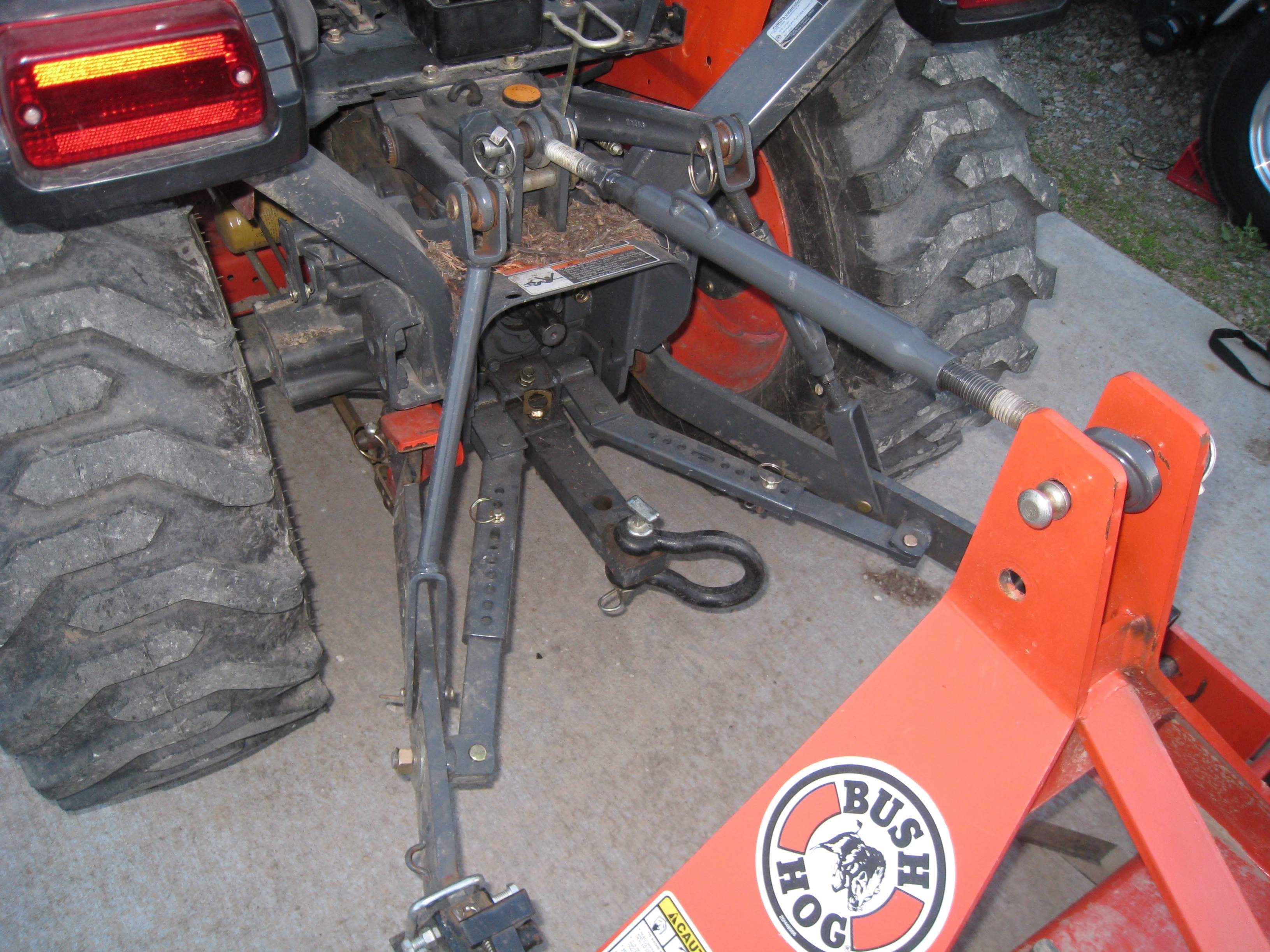

I recently purchased the Handi Hitch. It is available through Agri Supply, although I found a place in MO had it and I picked it up on a road trip. I have found it very useful and very stable. I took the smaller ball off mine and moved the 2" ball to the center hole as that is what all of my trailers use and plan to get a chain hook to go in the other hole plus the clevis.
HANDI HITCH WITH CLEVIS AND BALLS - Agri Supply
The problem I found with using the draw bar on the B2920 to pull the trailers is the lower control arms on the 3 point hitch swing in when there is not an implement on them. While they don't go all the way to the middle, they would catch on the tounge of the trailer when I turned. You can remedy this by switching from the turnbuckles that adjust the arms in and out to the telescopic stabilizers like used on the B2630 or B3030. It is a very nice improvement as it makes the adjustments easier and holds the arms out, but costs about $200.
Stabilizer
I have found adding Bling to the tractor as addictive as to a motorcycle.
