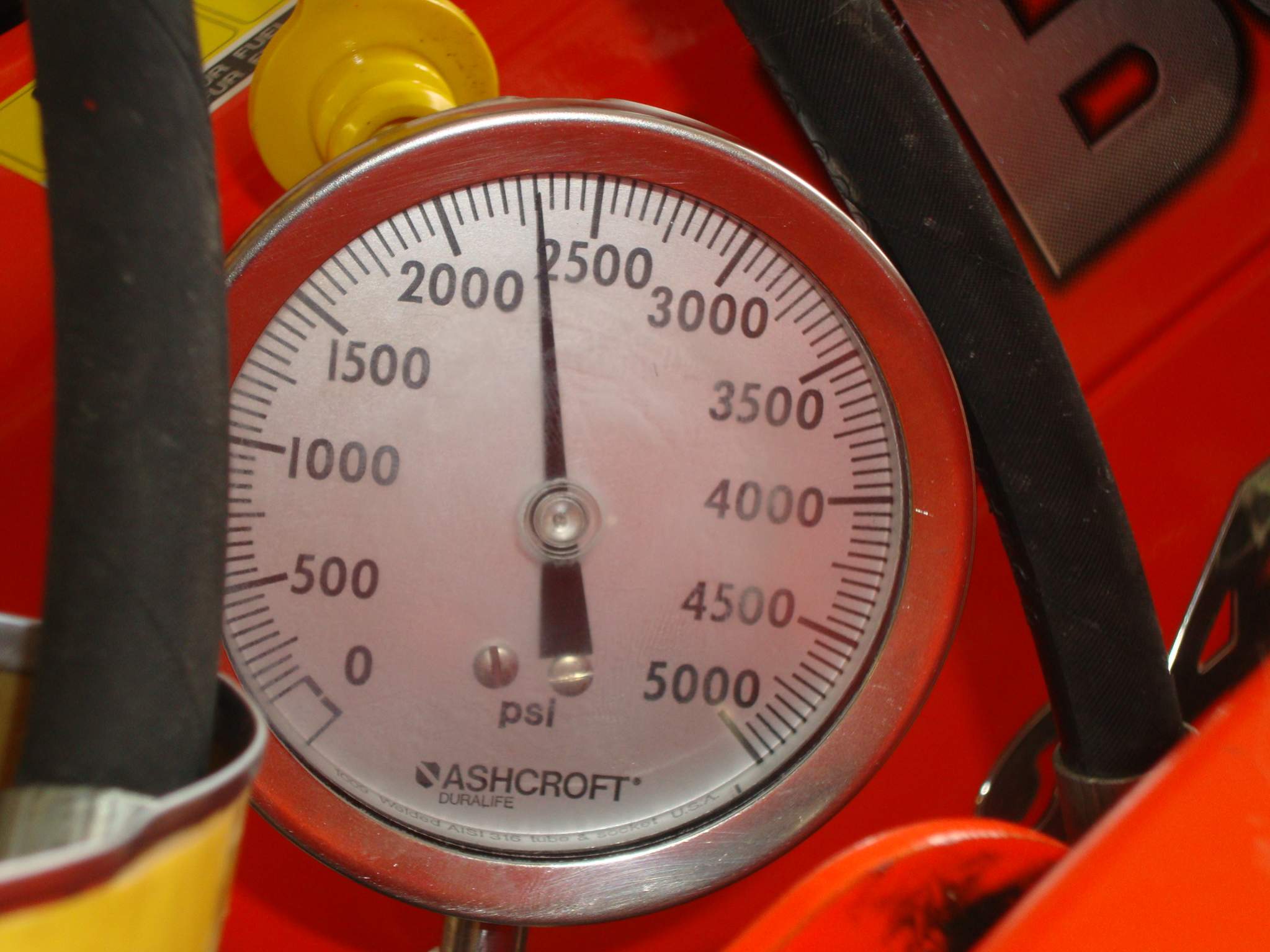

   / B2620 Hydraulic Pressure Testing #4
I simply removed the female quick connect from one of my loader hoses, screwed the gauge into the end of it, and checked the pressure that way. I didn't leave the gauge in place, obviously, but I didn't need to.
Sean
Do you know what the Kubota recommended PSI should be for that model tractor? Thanks!
