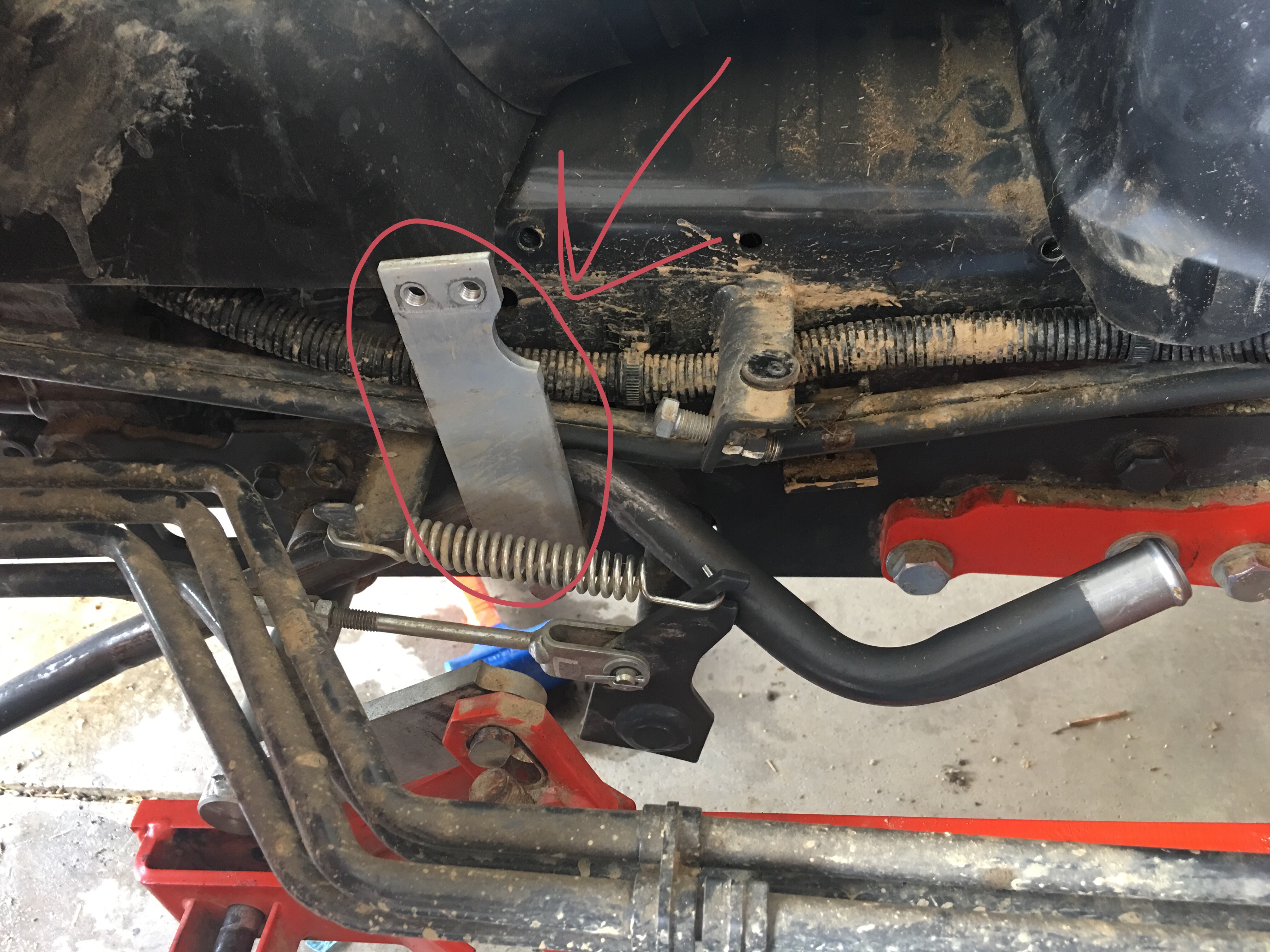

So... I backed into a stump and broke my hydaulic filter housing... The steel line that runs from the filter housing to the front of the tractor appears dented and bent a bit too. So, I'll be replacing it as well. The housing is simple but, the line WILL NOT COME OUT!!

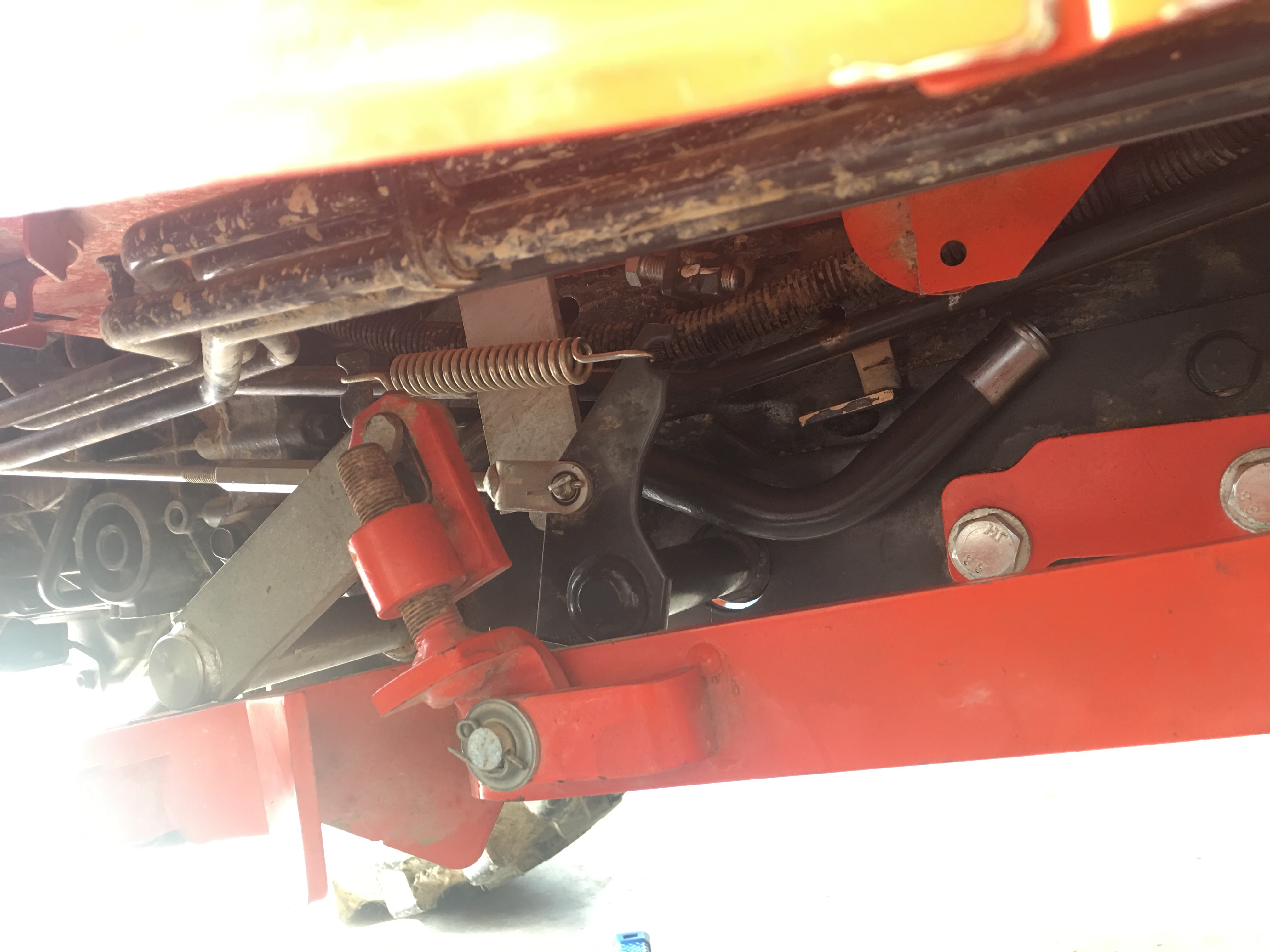

I have it unhooked but no matter what angle I try to remove it, it gets stuck at the break pedal area... Does anyone know how to remove this steel line??

So, if I remove the break piece it should come out... I'm entering uncharted waters. Any help with the removal of the break pedal price?
   / B2601 Steel hydraulic line removal... HELP!!!
Got it!! Jesus that was way more difficult than it needed to be...
