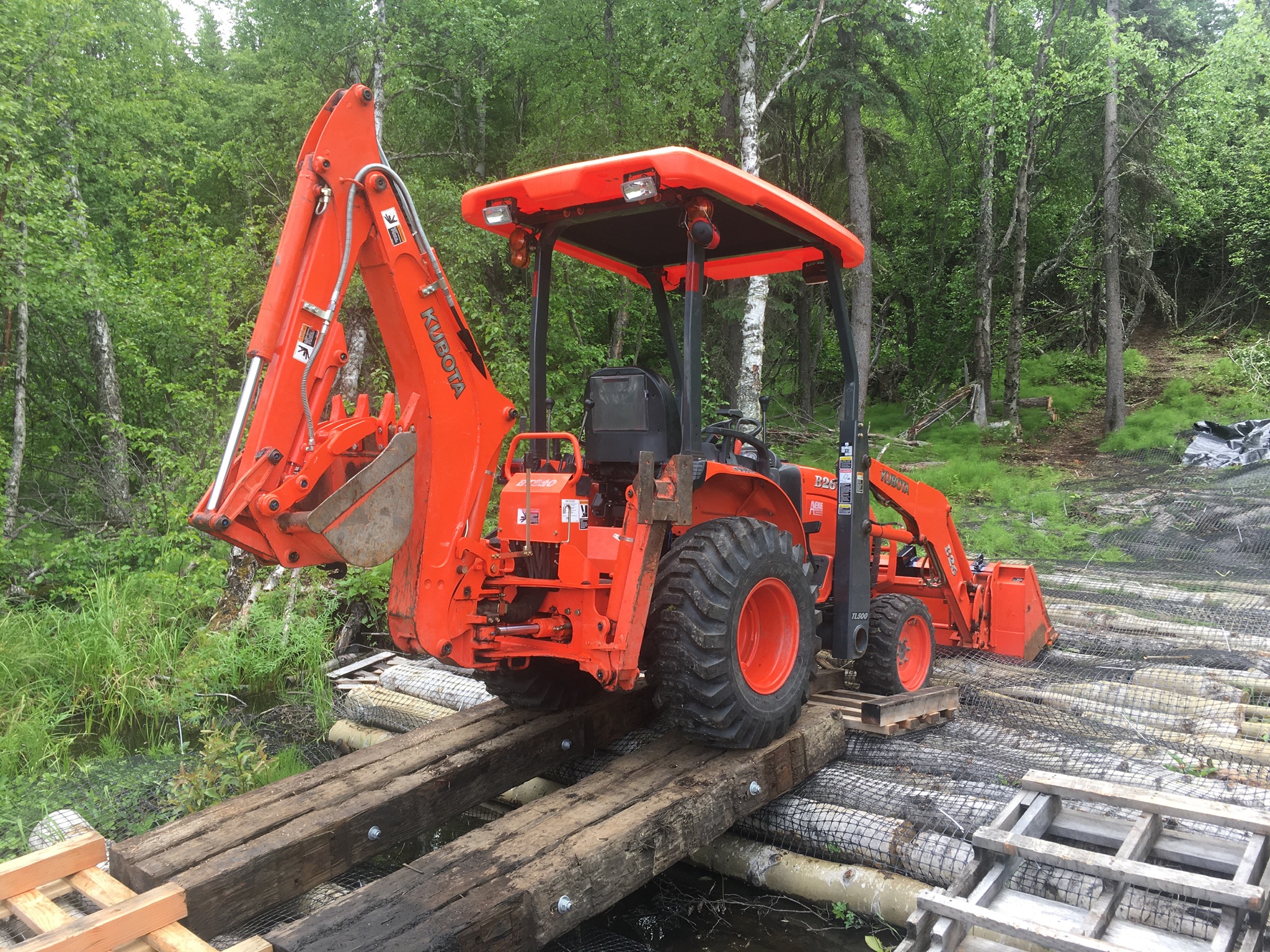

...Unless the stabilizers are up. Same with the loader- can� lift the front of the tractor up with the stabilizers down but with them up it will come right up a foot. Prior to adding a hydraulic thumb I believe I had the same pre existing issue. After the thumb add on I changed the hyd oil and hyd filters then purged of air by cycling the steering wheel left and right as per the manual. The dipstick is yellow and slick and very hard to read with new oil on it..
The above symptoms seem to be a hyd fluid level issue but the level does appear correct on the dipstick but it逞エ a slick stick and bright yellow and I�・ thinking of using some 60 grit paper on it to make it potentially more legible..

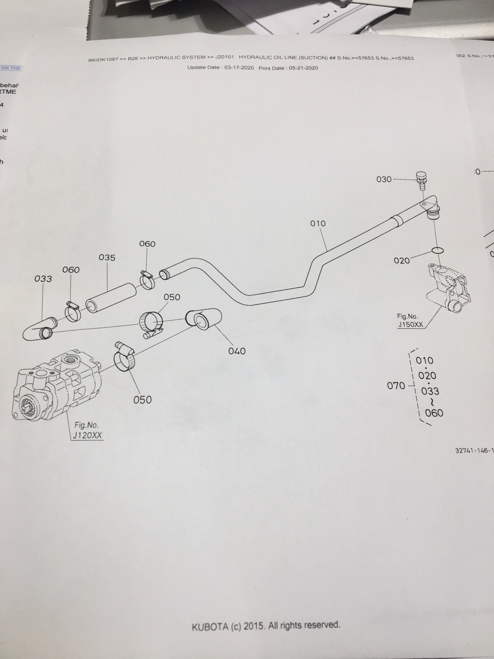

Before 400hrs the hydraulic suction elbow on the right side had developed splits. Splits occur where you can’t see. Installed a new updated line that goes from the hydraulic filter housing to the pump. Air in hydraulics always cause problems. Details in a separate post.
Not sure if I fully understand your backhoe problem. Do the simple things first. Correct oil level. Check that rubber elbow. Controls should freely return to neutral.

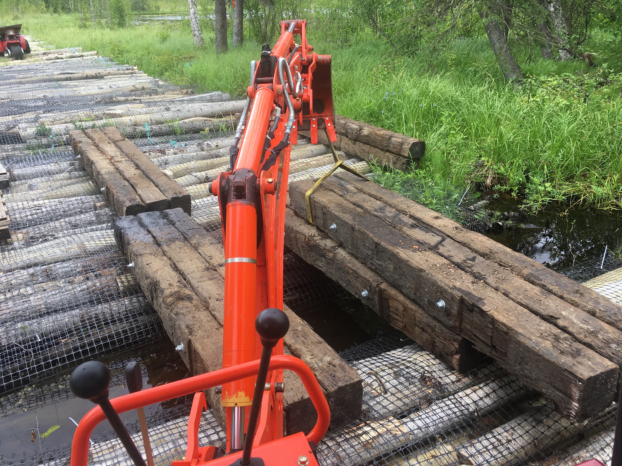

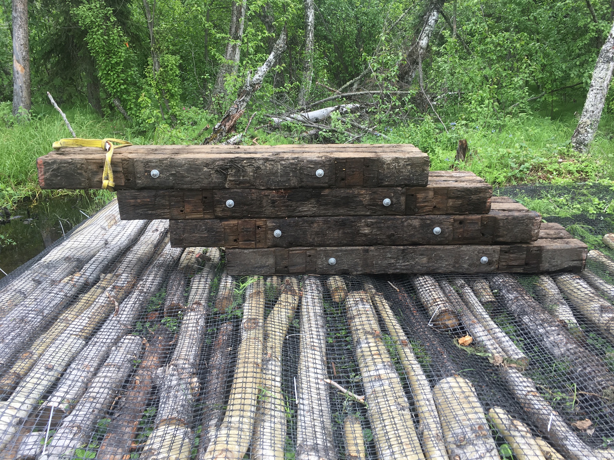

Big project you have going on. Those timber bundles are massively heavy!

That rubber elbow has me spooked and will change and check for cracks at the next 400hr service. A weak link in an otherwise tough as nails machine. Have to remove the right rear tire to install the updated suction hard line. Only one bolt but takes the right combination of socket, universal joint and extensions to reach.

Going to contact KUBOTA for the updated suction elbow today. Do you have a part number handy by chance?

The whole new updated suction line, 32741-39150 replacement including the rubber elbow(040) $23.46
