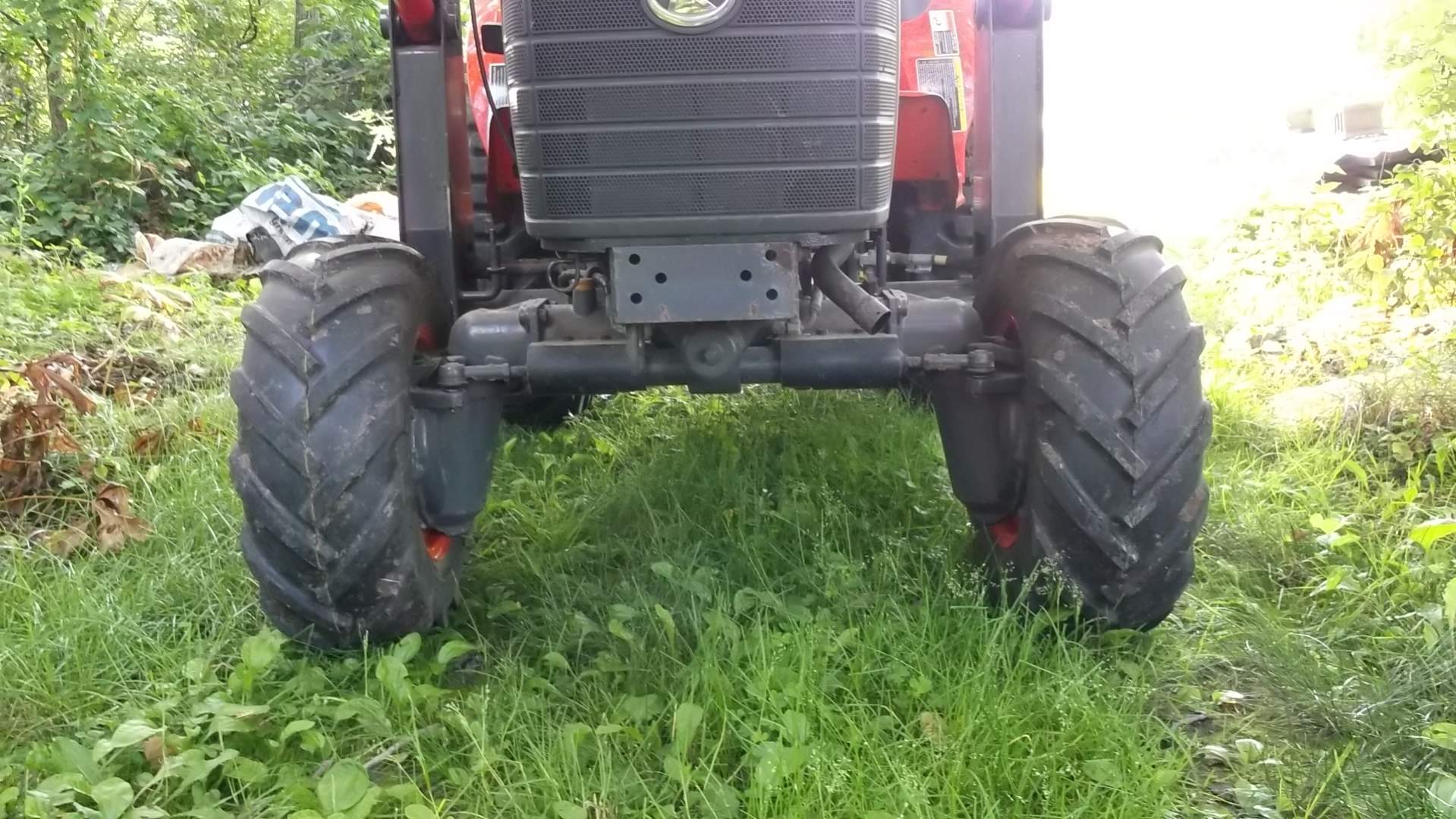

I just got a B26 last fall after selling my L4350. I noticed right away the front track was very narrow. I converted some 12x8.5 rims to the Kubota bolt pattern and accomplished 2 things at once. It gave me a wider tire 23 x 10.50 x 12 (6ply AG tread) option and increased the front track width by 2" overall. The new tire is only 2% larger in diameter so it will not affect the 4x4 ratio. The stability was immediately noticeable. DSCF1752.jpgDSCF1753.jpg
