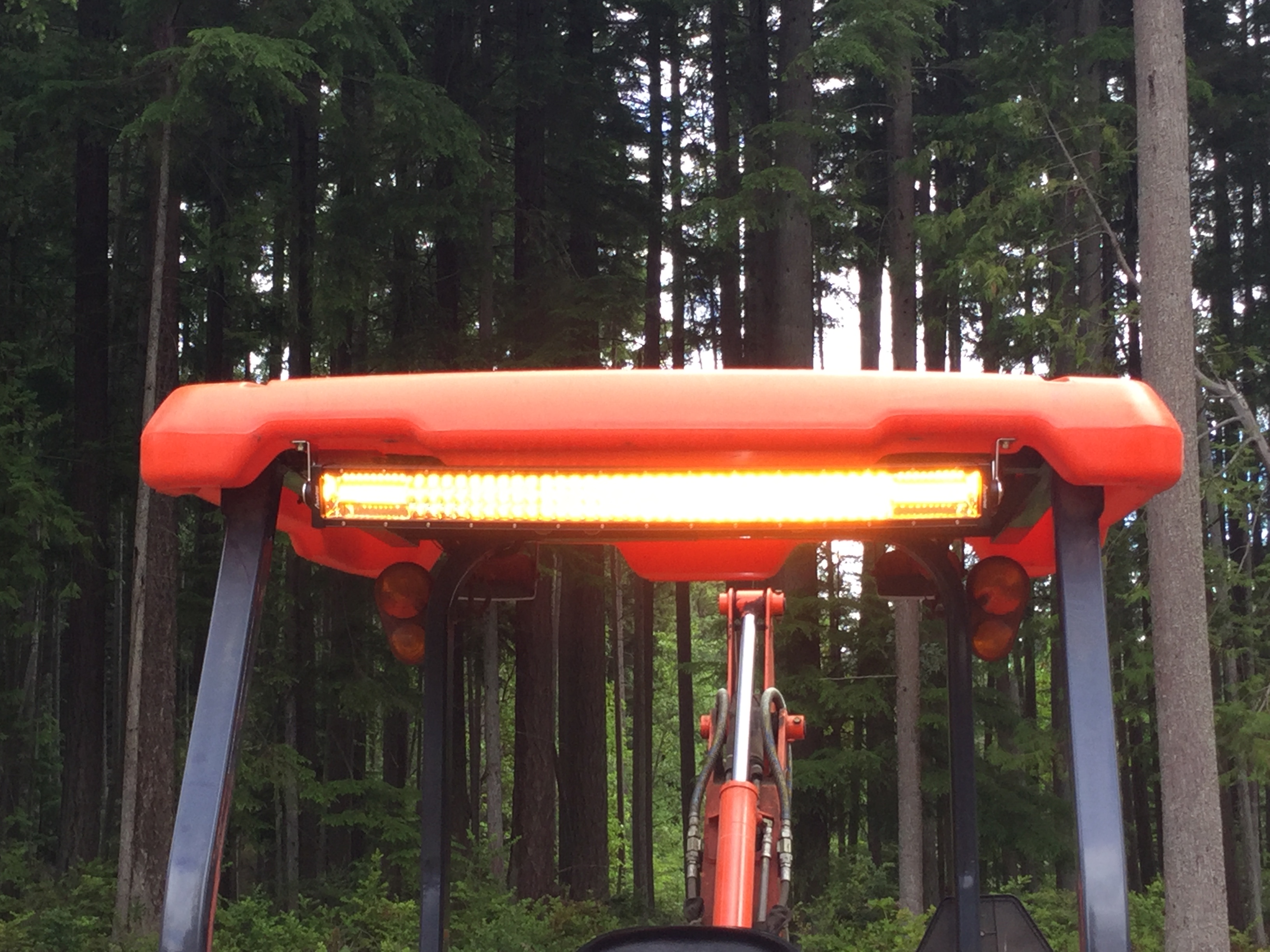

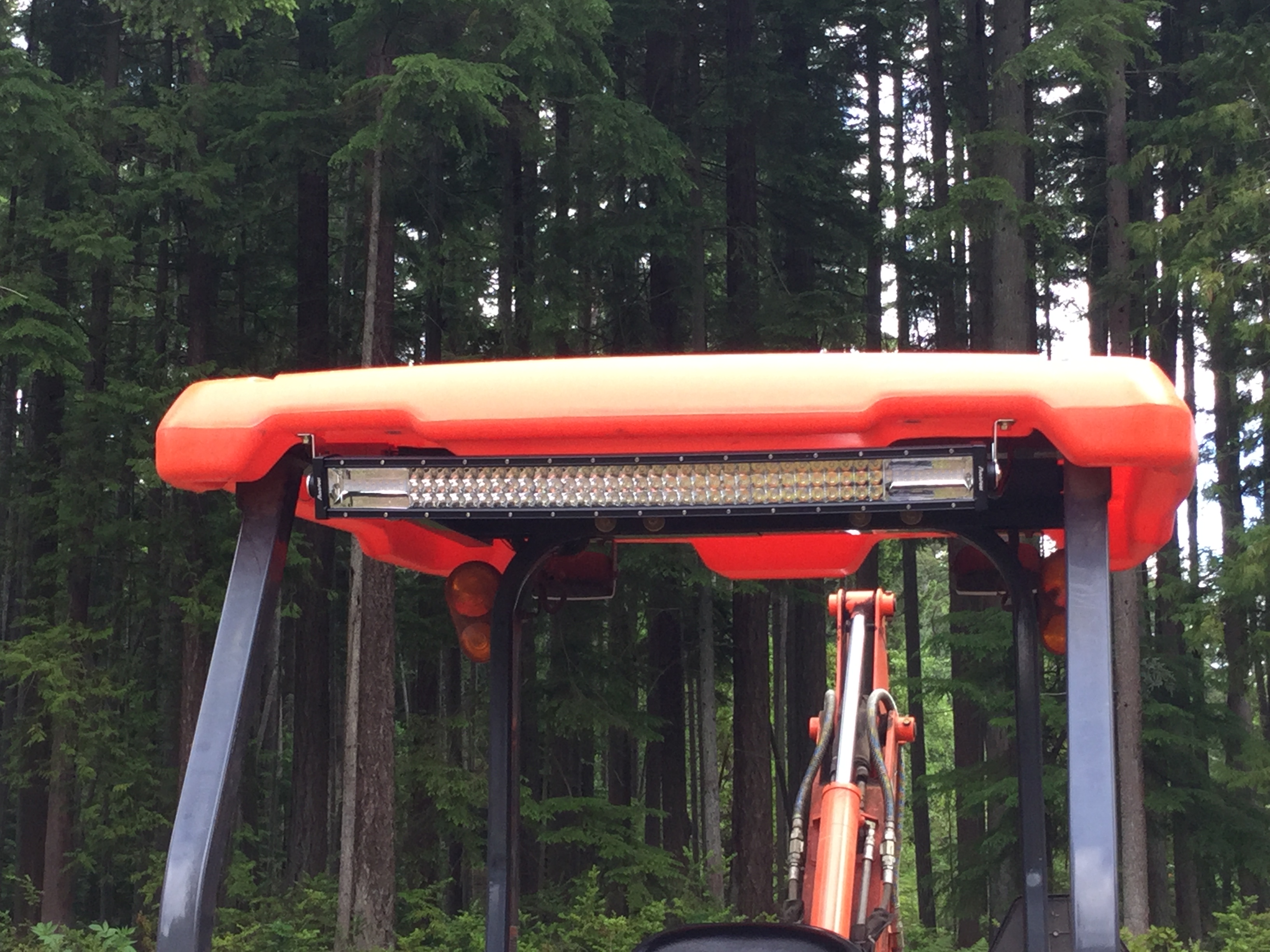

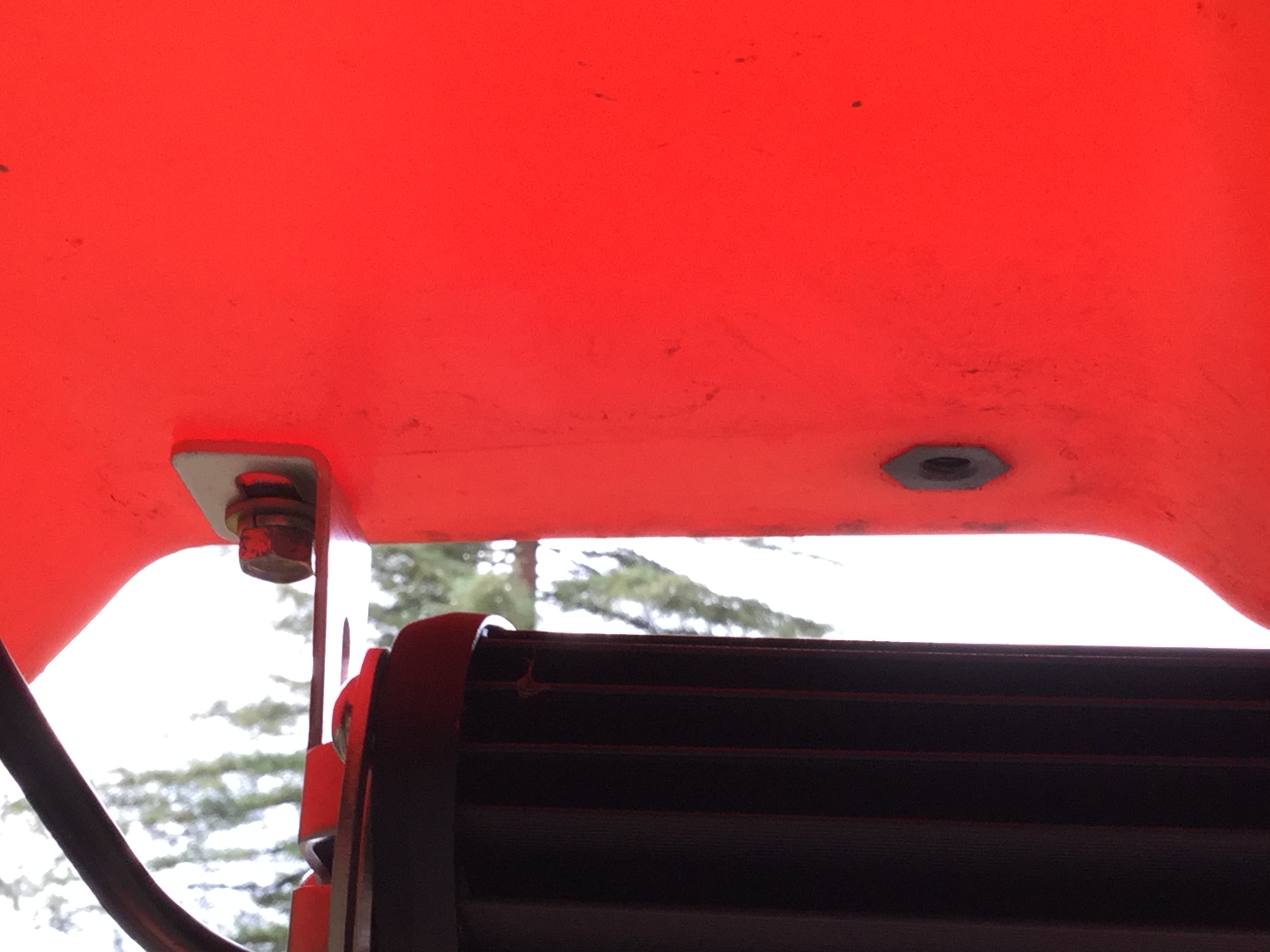

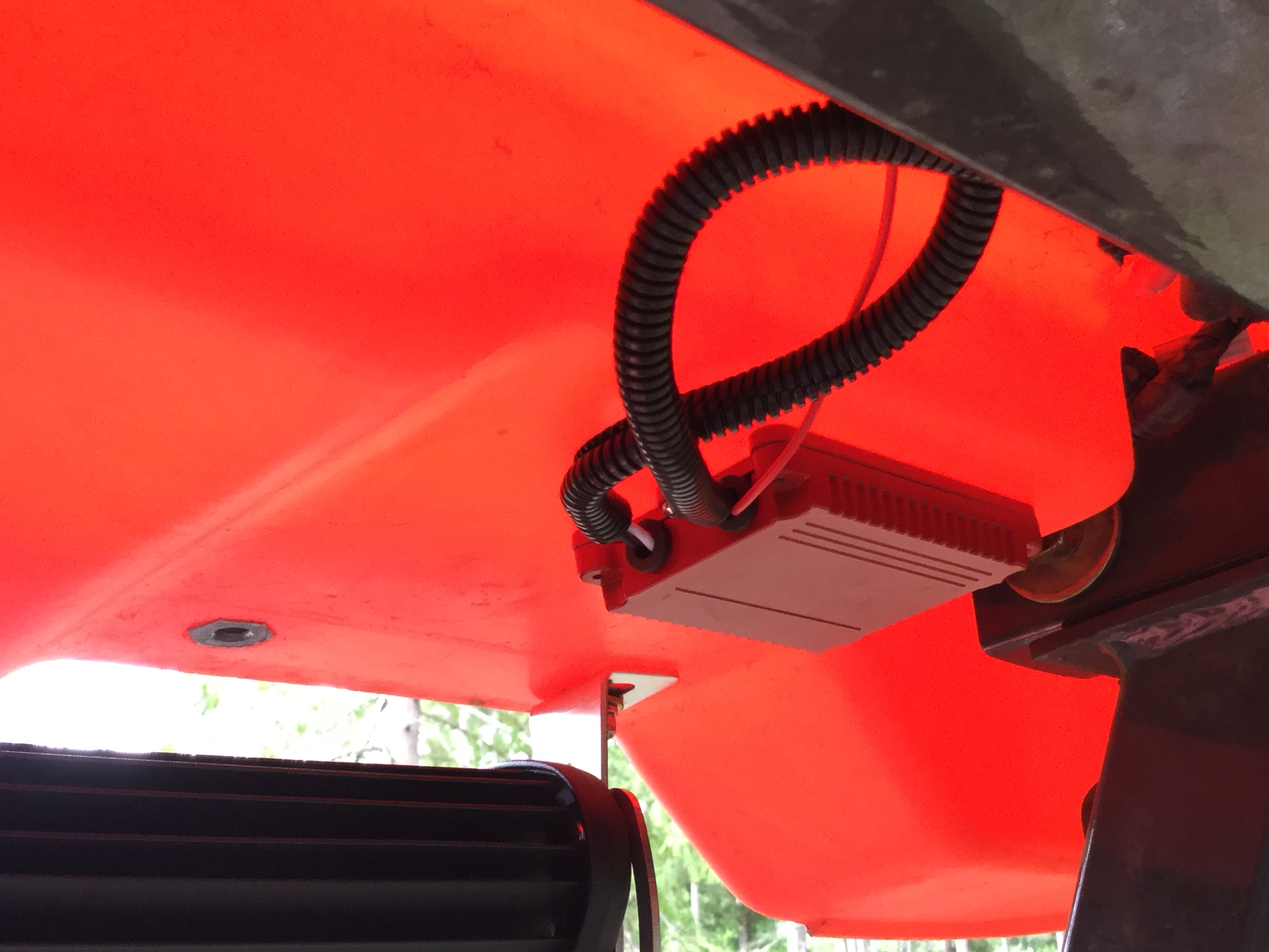

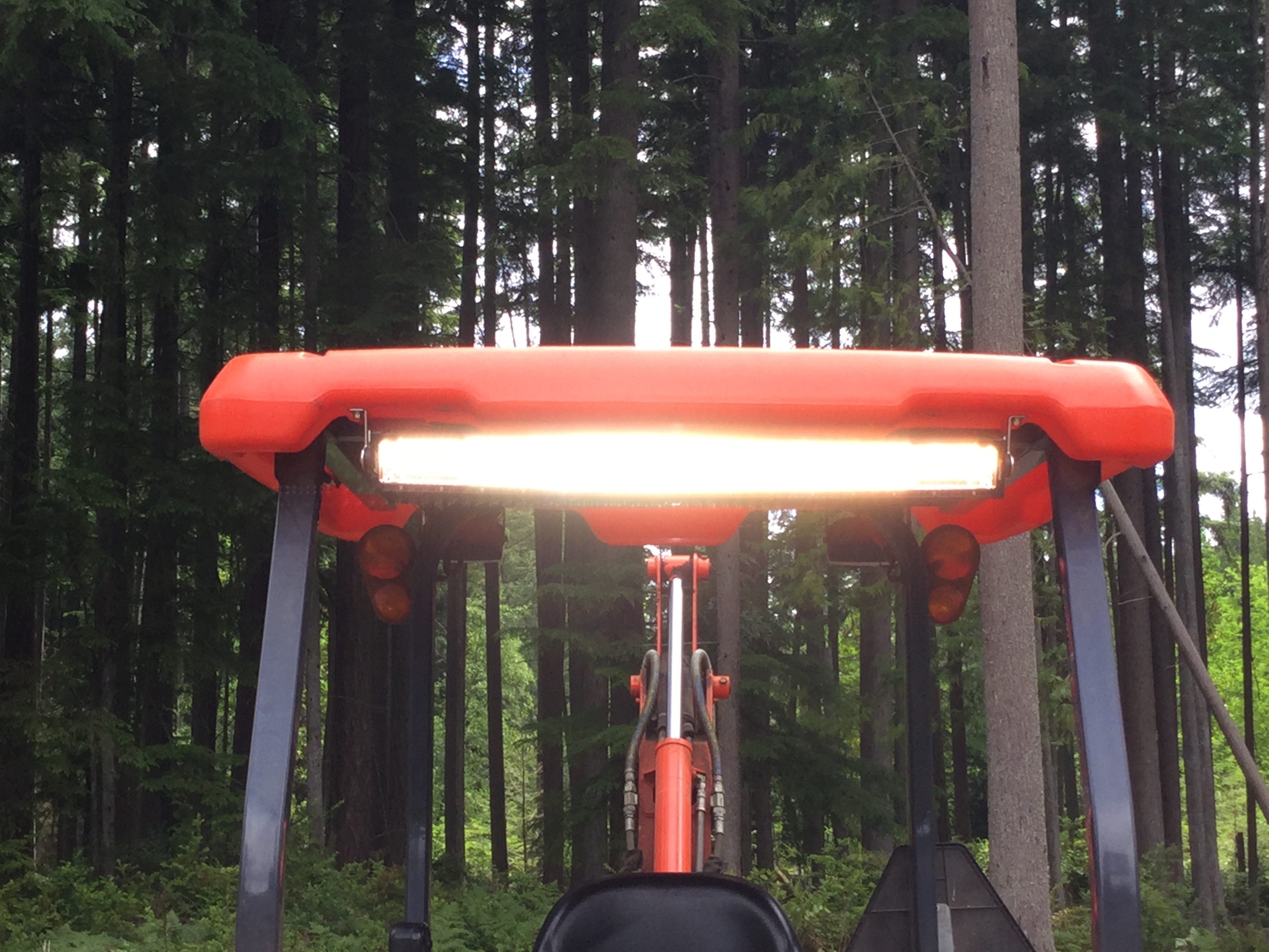

I installed a 32 inch curved three row LED lightbar in place of the stock work lights. The lightbar installed perfectly in the existing work light mounting holes (it even came with screws with the right threads). I only had to run the hot wire down to the existing unused 20 amp AUX(key on) circuit in the fuse block. I mounted the lightbar controller to the underside of the canopy with three screws into the plastic. These three holes would be the only remnant of the installation if everything was put back to stock. The lightbar was obtained on eBay item #152997069857. The brackets in the pictures came with it but do not show in the listing. The lightbar has spot, flood and combo modes as well as 8 different flashing combinations all controlled by a key fob remote. I have nothing to do with selling these lights. I just couldn't believe how perfectly it fit and wanted to share.
