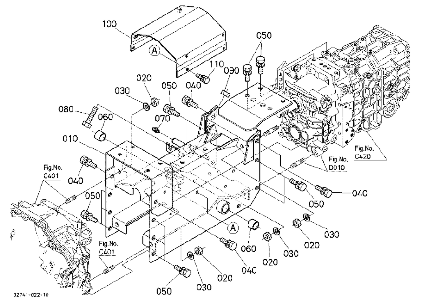

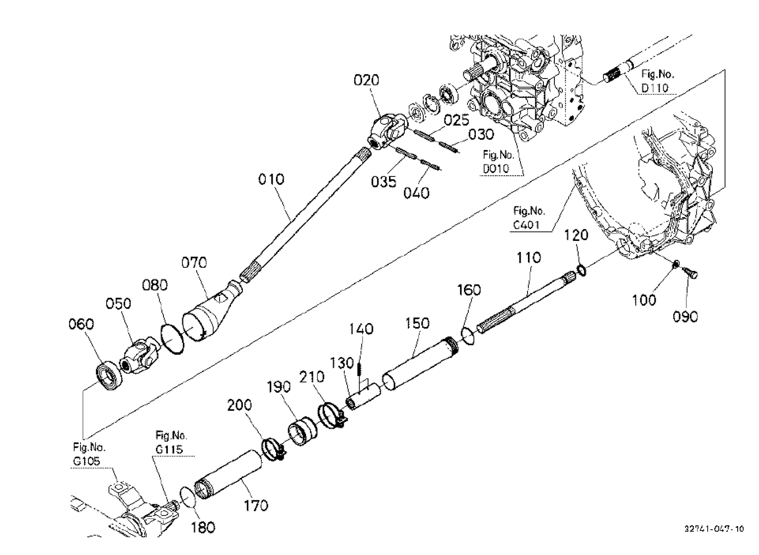

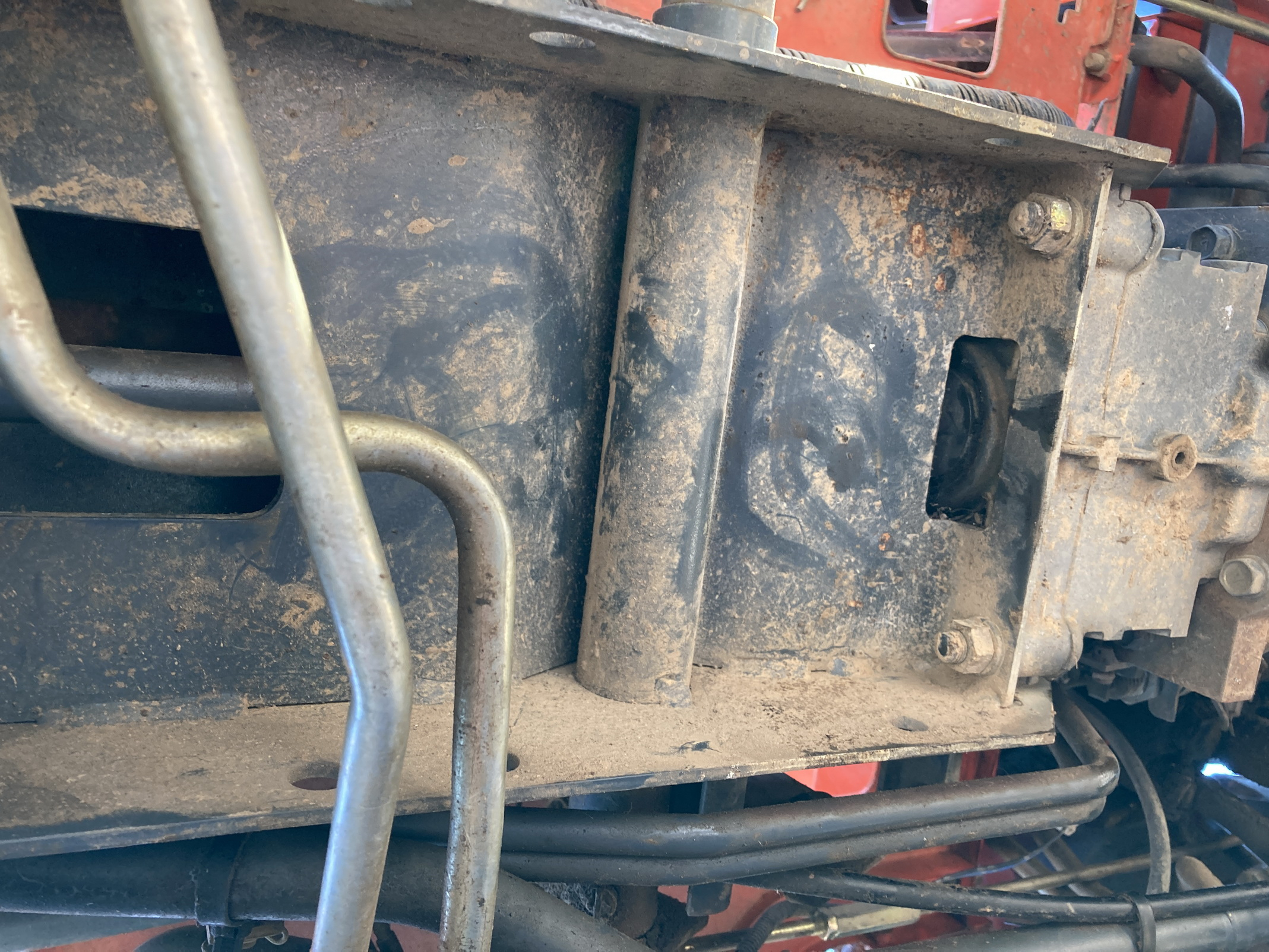

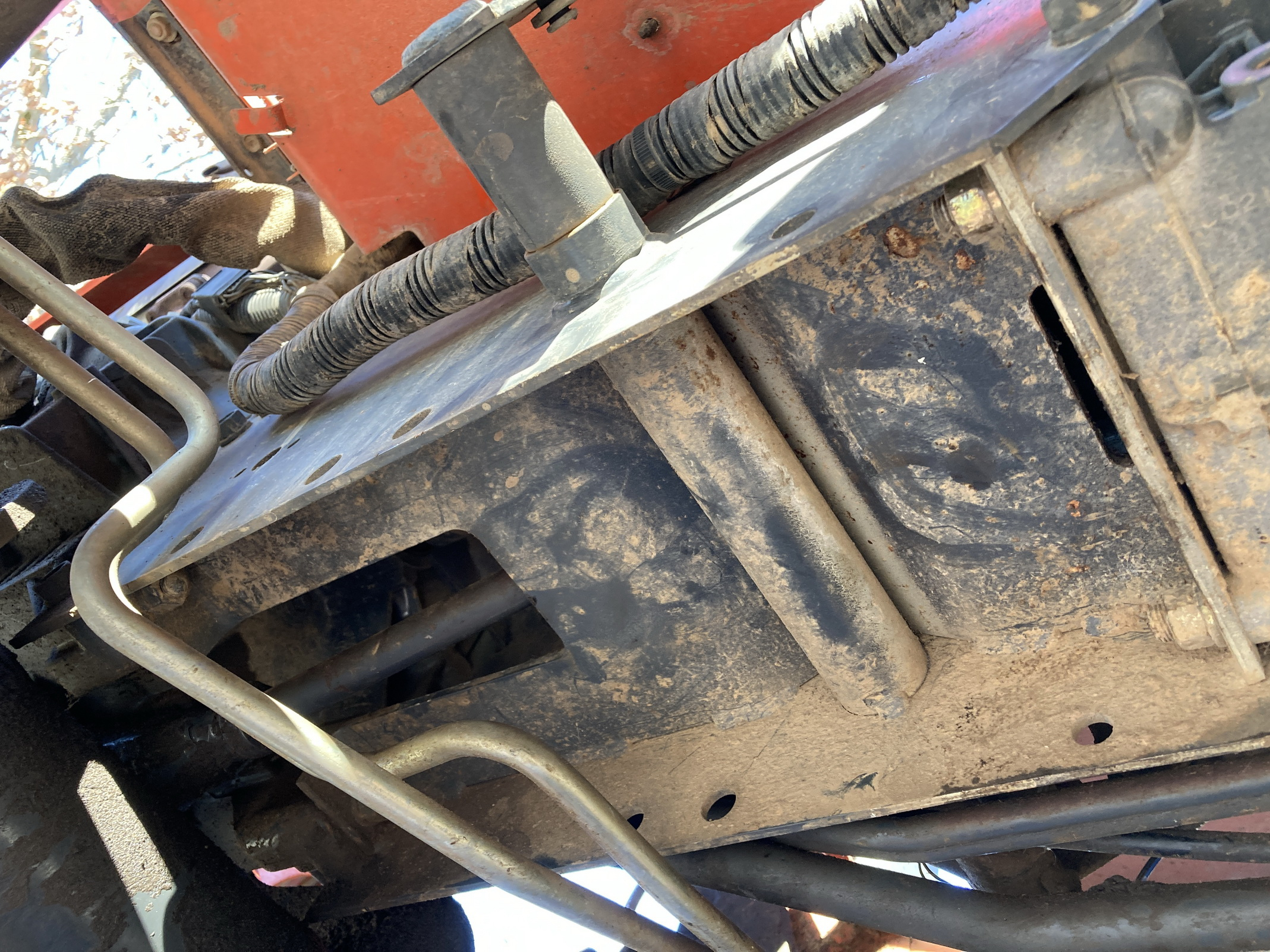

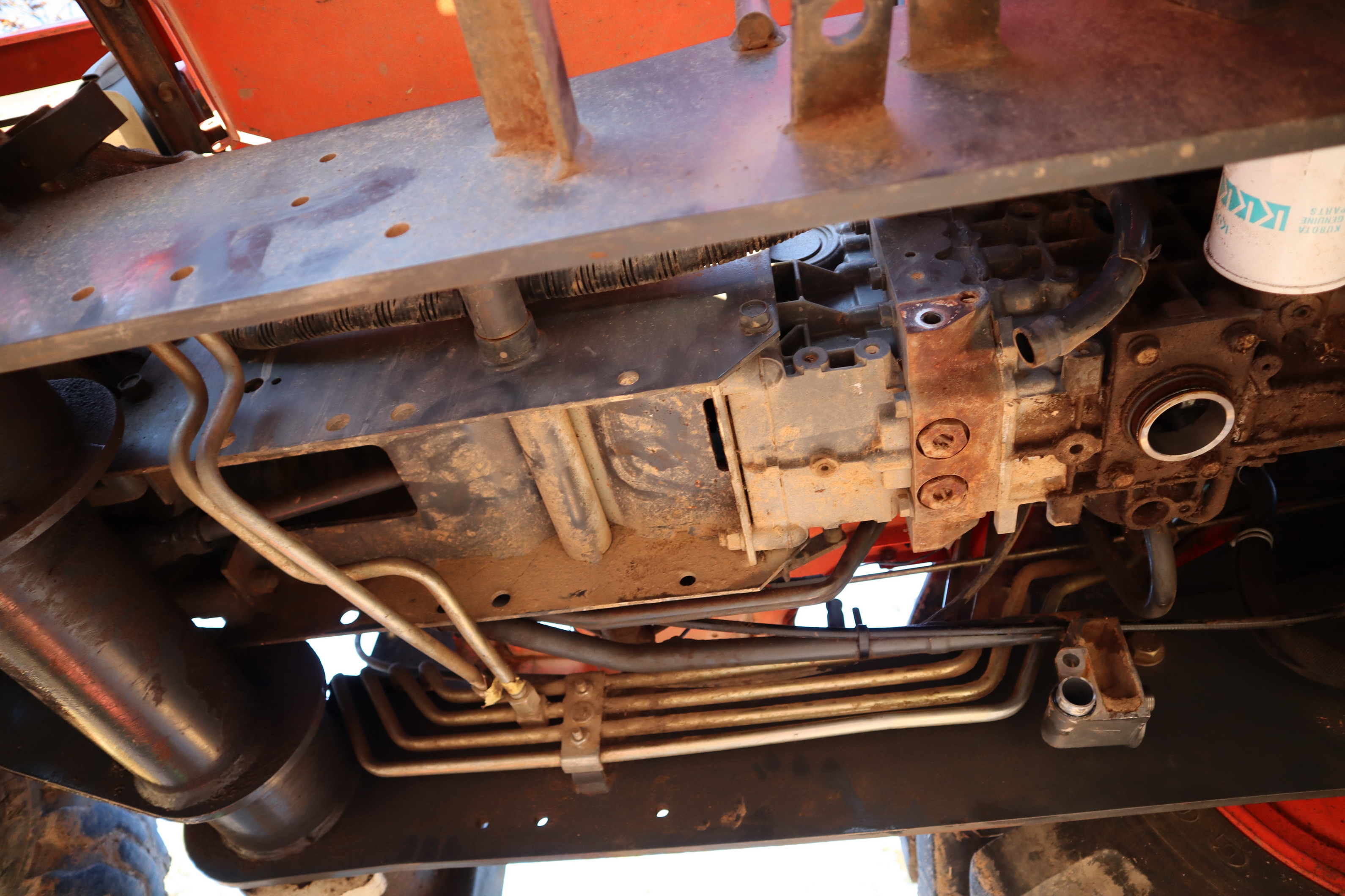

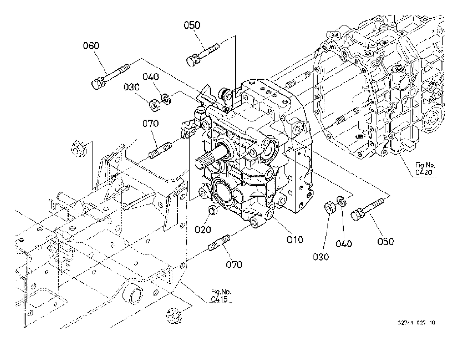

This U-joint failed and it looks like the repair is super expensive. I have been looking at alternatives to such a labor intensive repair. I am considering cutting out an opening in the plat from the bottom after removing the HST oil tank. Possibly using a plasma cutter to open for repair. This would make it easy to push out pins to remove U-joint. Two large bolts can be removed which support the front axel and wheels. This could give the extra movment of the drive shaft to allow removal and installation of the new U-joint. I am not sure if this will work but the photos and drawing look to support this theory. I have attached pictures and parts diagrams to show how these thing come together. Please, anyone who has done this repair, via dealer or otherwise please share your thoughts and opinions.
I have called the service department of our local Kubota dealer and they are unwilling to provide details on this repair. Also the service manual is not available on the internet and I may purchase a hard copy from the dealer.

A few observations from your pictures.
1) your U-joint appears to be full of crud. Even if it is grease from greasing the U-joint(s), if operated in cooler temps and depending on the grease compounds, grease can get very hard just by themselves, add in some dirt and grit from normal operating and you could have it bound up with very solid wad of whatever contributing to failure.
2) not being able to see what is ‘above’ the HST tank or what might be above the plate you plan to cut out, caution with flames when cutting is a HUGE MUST!
3) again a safety caution. Many jack stands have been recalled. Many more are suspect that have not been recalled. Many people are suggesting using various types of blocking material, be aware that every time you put a block on top of a block, you add a potential shift point. Also bases of any support system needs to be on solid non-shifting/moving surface.

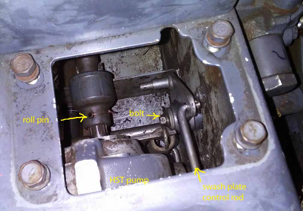

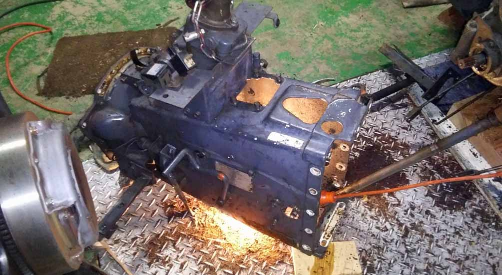

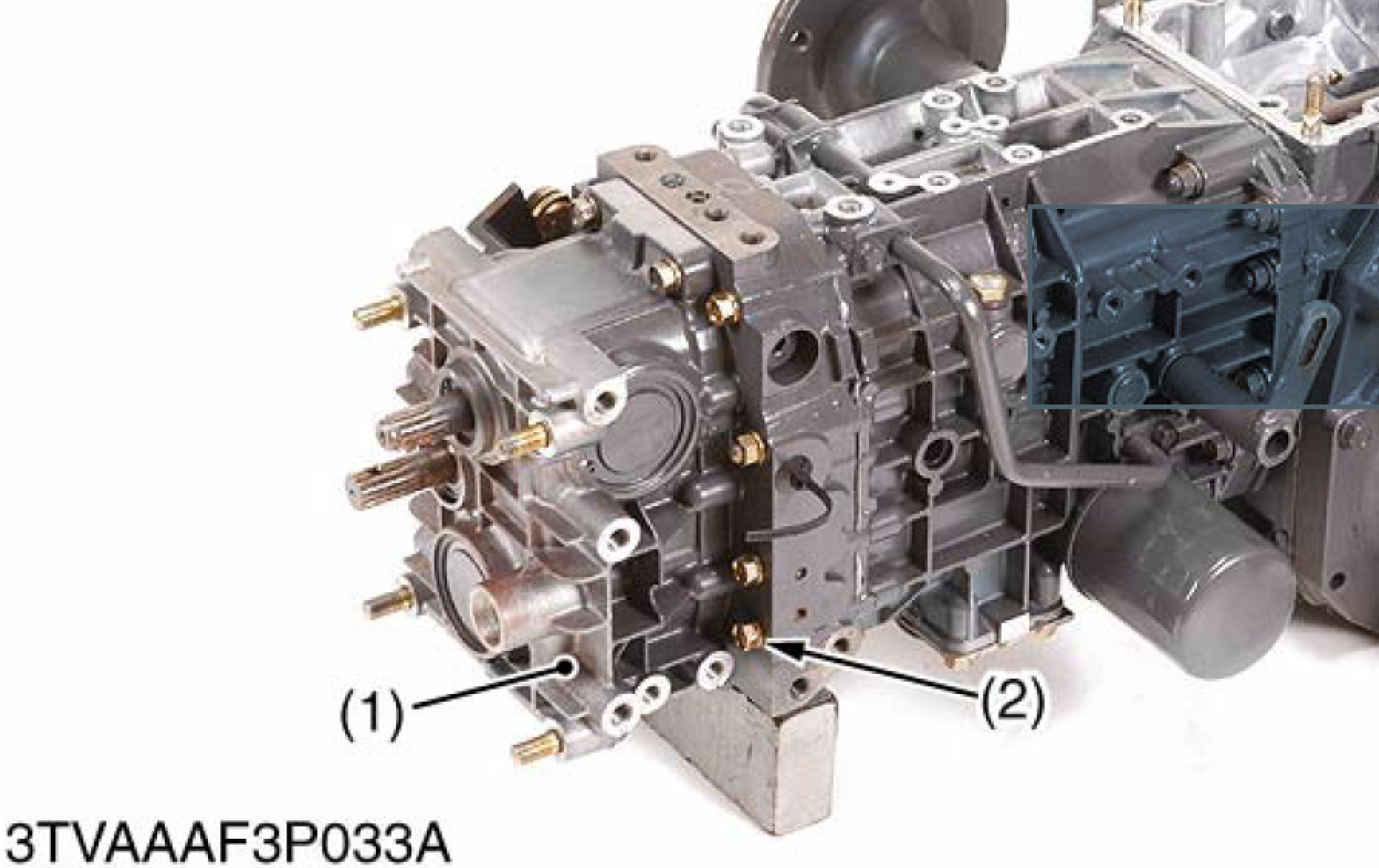

I recently split and reassembled a B20. There are more similarities to the B26 than I would have expected. The tunnel section on mine has 2 hatches on the top, and one on each the left side and the bottom. This allows access to the main shaft U-joint, but the MFWD coupler is harder to access.
I see the B26 has gone to double roll pins from the single pin + wire on the B20. The B21 does it like the B26. I noticed that my U-joint roll pin had broken, tho it had not come apart yet.
I think you should cut a hole. Splitting the B20 was a huge project, as was the B21 I did years ago.
