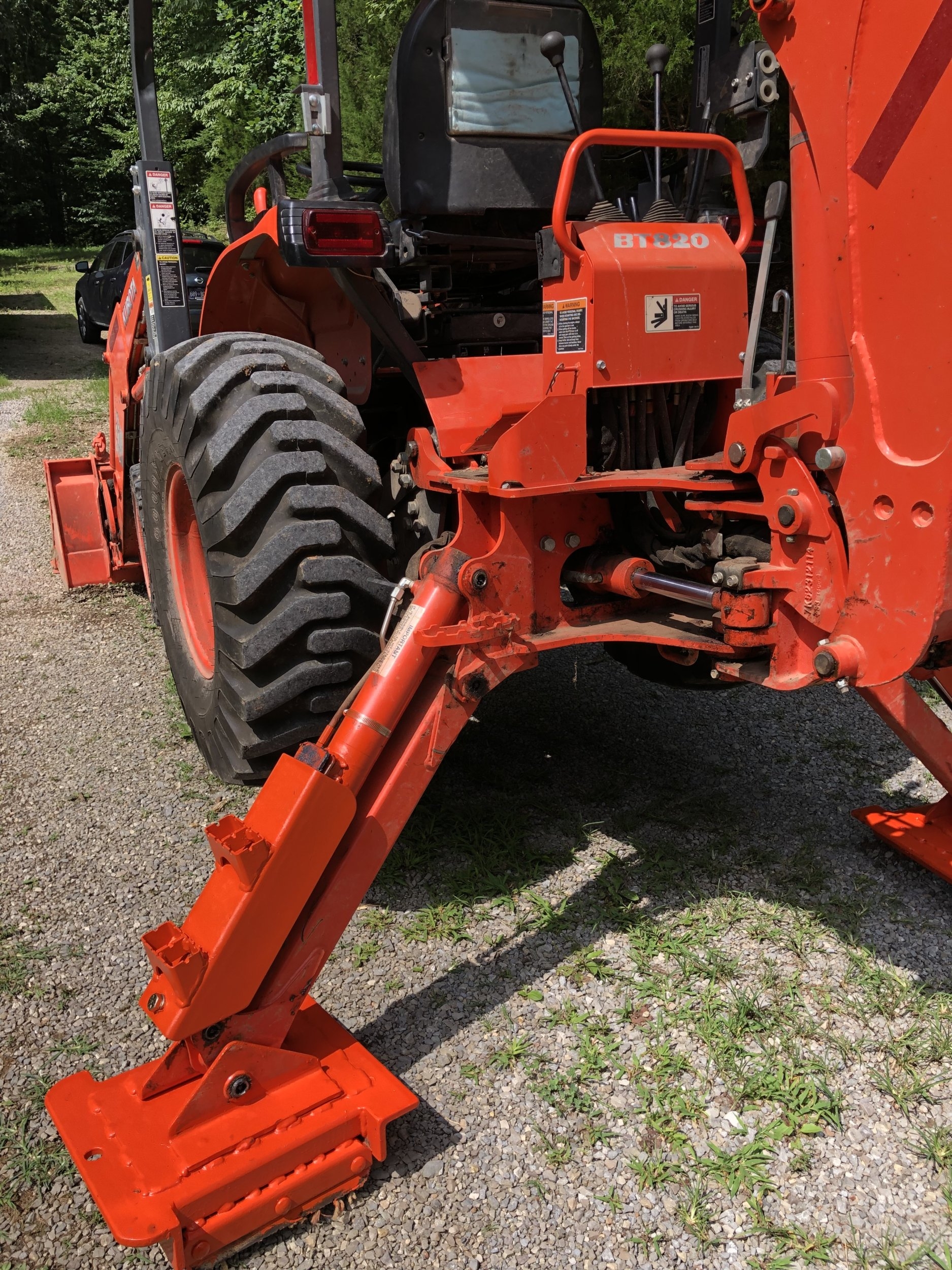

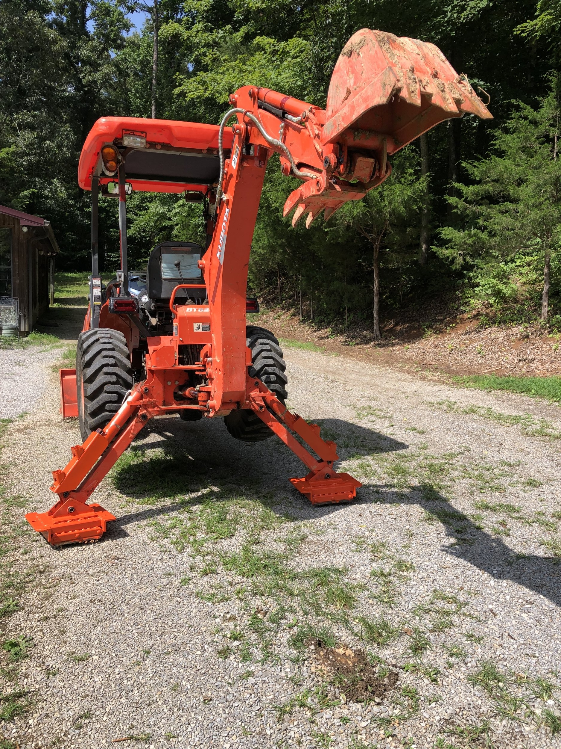

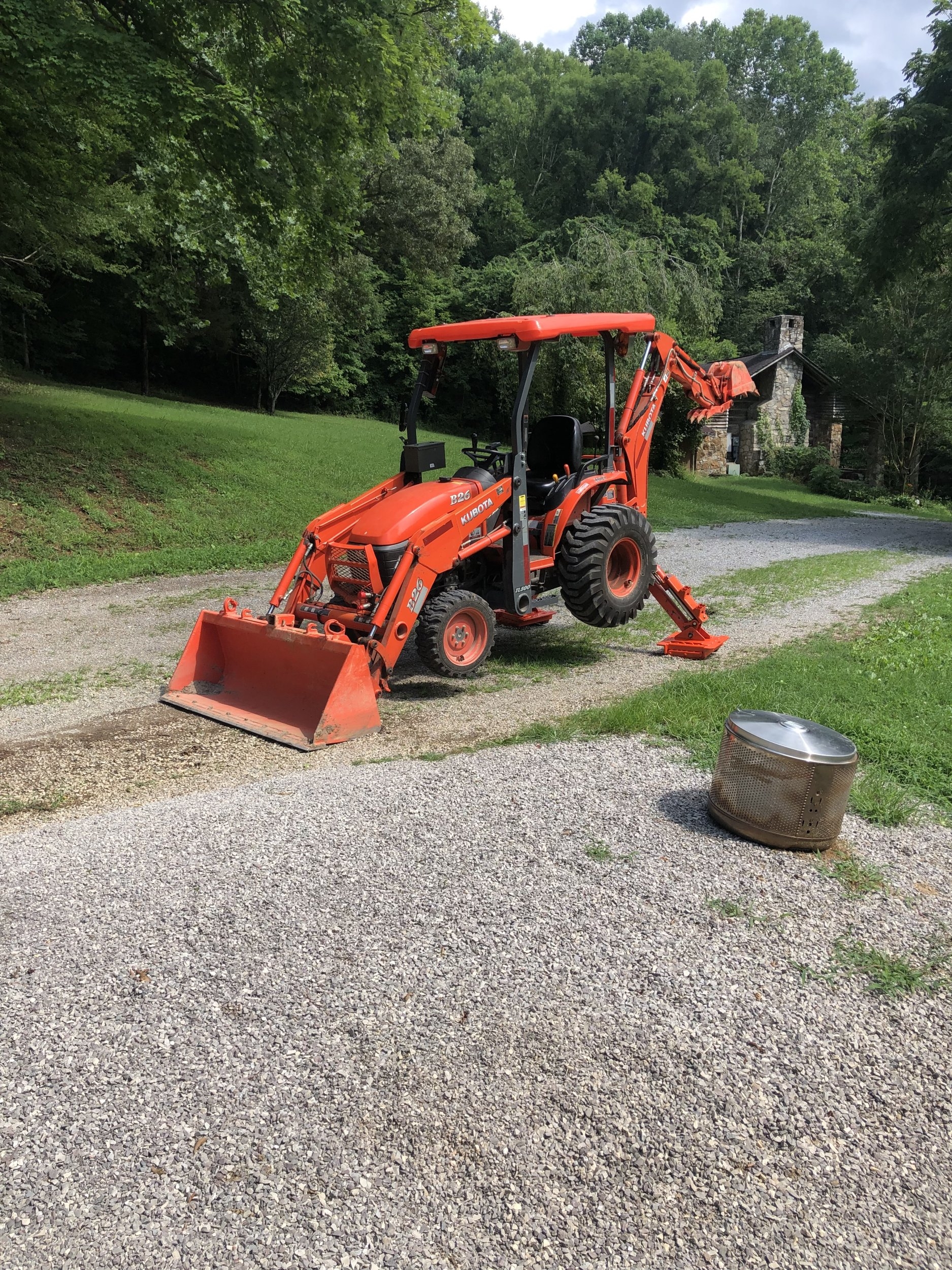

Combination rubber pads and cleats. 16x18”, about 5” height advantage over OEM. Combo advantageous on our hillside, falling water farm. Terrain soft to rock on a slope.

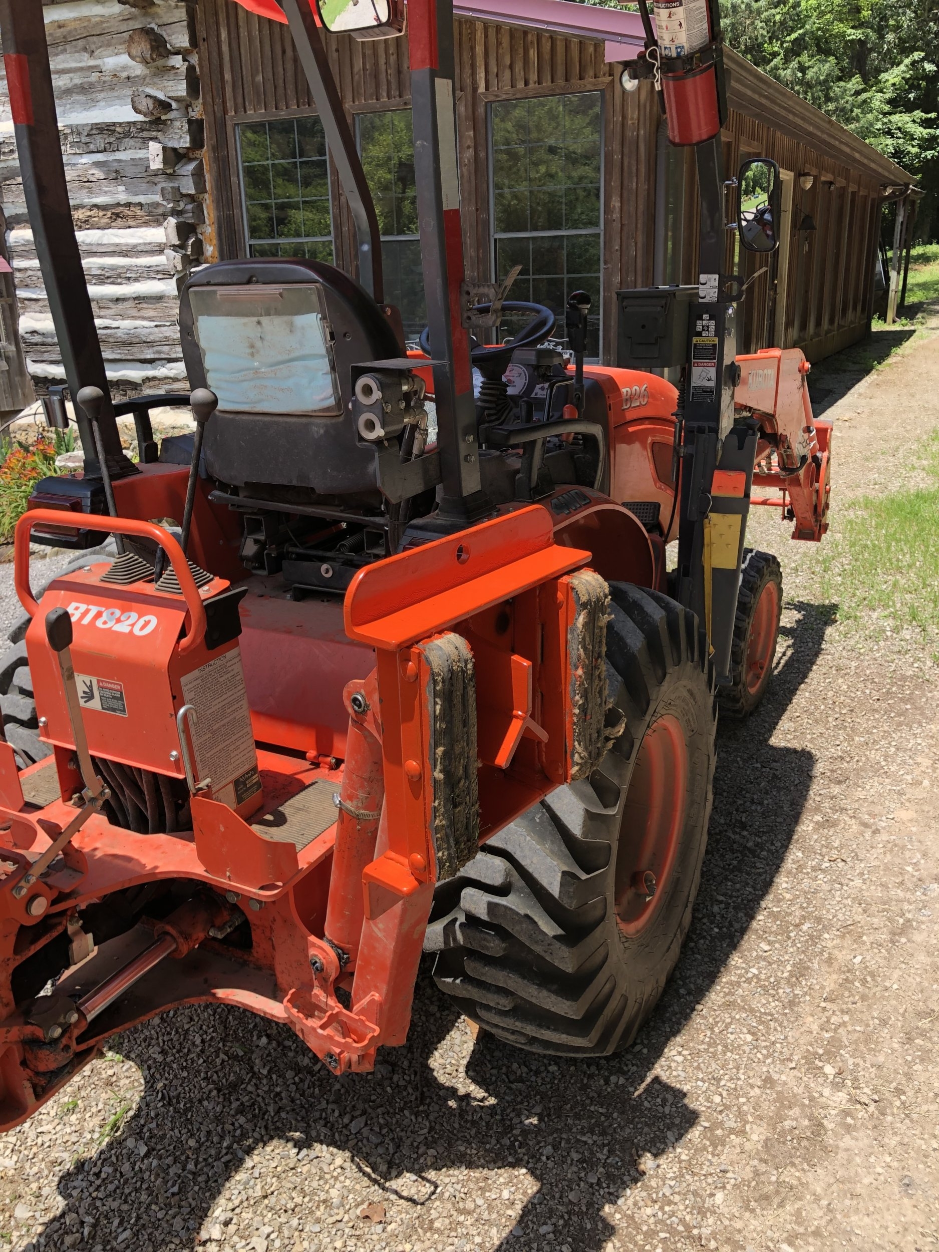

Few more pictures. Made some stabilizer’s covers with steps for easier climbing.
Easiest thing is to added OEM factory rubber pads. The B26 came with rubber pads. So impressed bought a set of NOS off eBay for the M59. All TLBs use the same pads. Adding steel to increase both width and height helps keep level, from sinking and sliding on our hillside farm.
