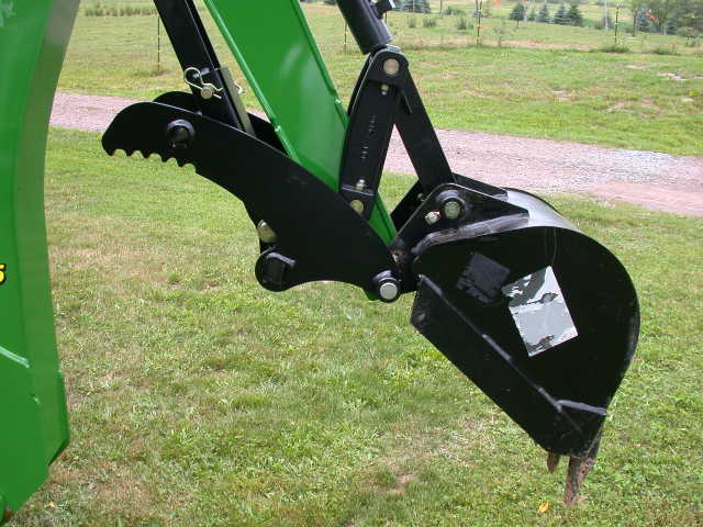

I built my own mechanical thumb out of 4" by 3/8" plate welded to the stick. Very handy and have about $150 into it. It maybe light for your b26, but works good on my little hoe.
   / B26 Backhoe thumb - to buy or not to buy? #22
Great job!

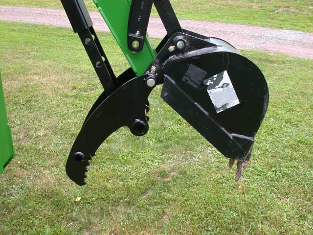

I got a hydraulic thumb on the mini-ex and it's a must have. I think a backhoe would be the same. "Better to have it and not need it than need it and not have it". (Yes I've been watching Lonesome Dove)
   / B26 Backhoe thumb - to buy or not to buy? #24
I have a hydraulic thumb, and while I have a larger machine, I am very pleased with the capability.
I can mimic the behavior of a mechanical thumb, so I have a good perspective on what works, and the hydraulic is at least twice as useful as the mechanical.
If I pick up a rock and put it down on edge, I can control which way it falls by which side releases first. And, the hydraulic thumb adds a whole new capability to positioning rocks or other heavy items.

I bought a B26TLB in July of 2008 with a backhoe thumb. It is useful. However it is very flat (ie no curvature). There are small points on the end of the fingers, but they are too small! Some teeth about 2 inches long need to be welded to the ends of the fingers (which I have yet to do).
You will have to determine if the $1400 is too much.
The backhoe thumb requires the following from Kubota:
1)Remote valve kit for backhoe mounted attachments.
2)Hydraulic thumb.
3)Quick attach coupler for the backhoe bucket.
4)Replace bucket, the original one will not work!
