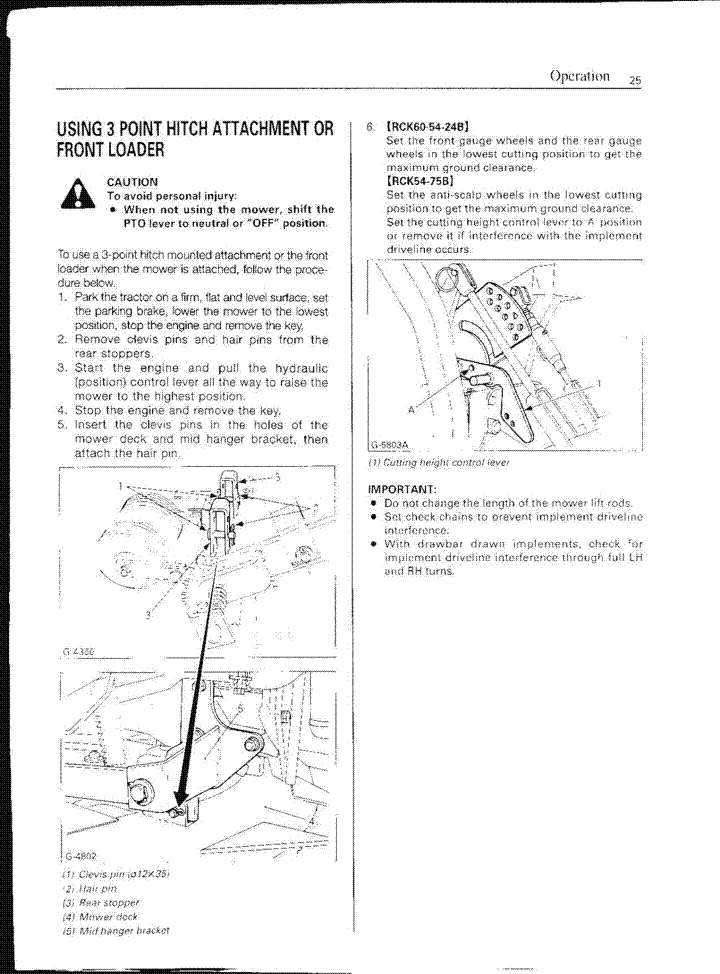

Hey fellas. I just upgraded from a BX to B2410. I was led to believe that I could lock the MMM up so that it doesn't drag when I'm towing trailers or using stuff off the rear. I like having the weight of it on and really don't want to keep taking it on and off. But I see nothing in the manual and I've got a call into my GREAT dealer. But I gotta figure you guys have some tips. Thanx.

Check page 25 of the Rotary Mower Operator's Manual
Models RCK60-24B
RCK54-24B
RCK54-75B

the deck doesnt really lock up, there are pins to hold it up though.
look under the tractor just about the mmm. you should see a small silver tab sort of pointing to the front of the tractor with a pin in it. thats what you use to keep the mower up.
hope this helps.
   / B2410 MMM lock
Yes, page 25 worked. Thanx. Just two pins and bingo, it's up.
