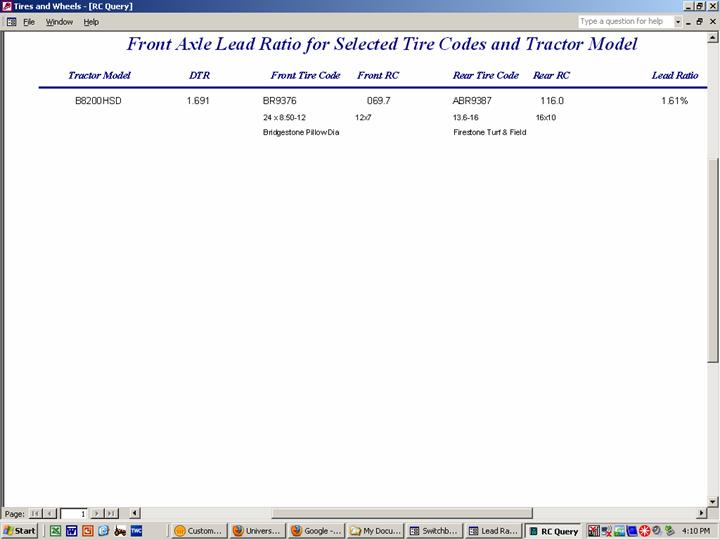

Have been looking into replacing rear tires and learning about the importance of Rolling Circumference on a tractors 4wd. To confirm that the tractors current front and rear tires have the correct RC to match the Mechanical Ratio for Lead and Lag, I marked a front and rear tire then drove in 2wd on hard pavement for one full tire rotation. The result was when the front tire turned once, the rear tire was lagging by a lot. The rear tire mark was at about the 2 o'clock position. One interesting thing is when taking the tractor out of 4wd it never feels likes it binding. The lever moves smoothly out of 4wd.
The rear tire is the original 12.4-16 Firestone R1. The front is a Carlisle 6x12 R1. The original front was a Bridgestone that is no longer available. I have spent many hours trying to find what the front tire should be and what the Mechanical Ratio is. I tried Kubota Corporate and they said to work with a dealer. I spoke with a dealer and they had no idea what I was talking about and said to call Corporate. I have also read many threads on multiple forums but can not get a clear answer on what is the correct front tire dimensions.
The front Carlisle tire is 23 inches tall with a RC of 68.9. According to Firestones current specs the rear tire 37.6 inches tall with an RC of 106. However, the tire on the tractor is 30 years old and I have no idea if the dimensions have changed. The tractor only has 650 hours and all on grass so the lugs look great with minimum loss of tire circumference.
I did find a sheet from another forum thread that posted the Mechanical Ratio for a B8200. The B8200 uses the same tires as the B2150 so one would think the mechanical ratio would be the same. When I calculate the lead/lag with my current tires using the B8200 mechanical ratio of 1.691 it calculates a lead of 9.9%.
Lead Lag Calculator
Anyone know what front tire(s) are correct? And the Mechanical Ratio?

Let me add that the difference in tractor Lead should be 0-3% or 0-5% depending on what you read. The tractor front should never Lag.

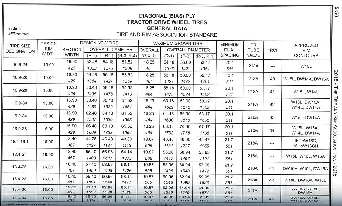

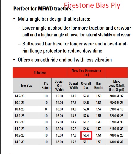

You are being prudent in selecting tires.
You will learn that many brands of tires from outside North America fail to follow the tire "Bible," the Tire and Rim Association Hand Book.
I have seen a MITAS tire on a new M7040 be 3" smaller in diameter than the TRA handbook spec. That creates a circumference that is over 9" too small.
Look over the attached material and note that the diameter of tires changes as the tires age or "Grow."
Also, the diameter changes for the same size, say 16.9 x 28, depending upon R1, R2 and R3 &4
Radials have their own set of diameters.
Rely on the published literature by companies like Firestone and do your best to create the front to rear ratio which has been working well for you over years.
Dave M7040
Dave M7040
Dave, that's where I started with charts like that years ago. And what I found out is that none of those measurements are what you are looking for to calculate lead vs lag or front to rear ratio.
Those are arithmatic diameters for a theoretically round tire. That works for circular things, but not for tires because they aren't round when they are on the tractor.
What you want is a spec that is called the "loaded circumference". That is the spec used for the gearing calculations, and all tire companies have it available although sometimes you will have to go to the engineering specs to find it. As you might suspect, it is dependent on load, flexibility, and psi.
The difference between calculated circular circumference and actual loaded circumference will typically be large enough of a difference to completely mask what you are trying to accomplish - which is to make the front tires turn about 5% faster than the rears when in 4wd.
