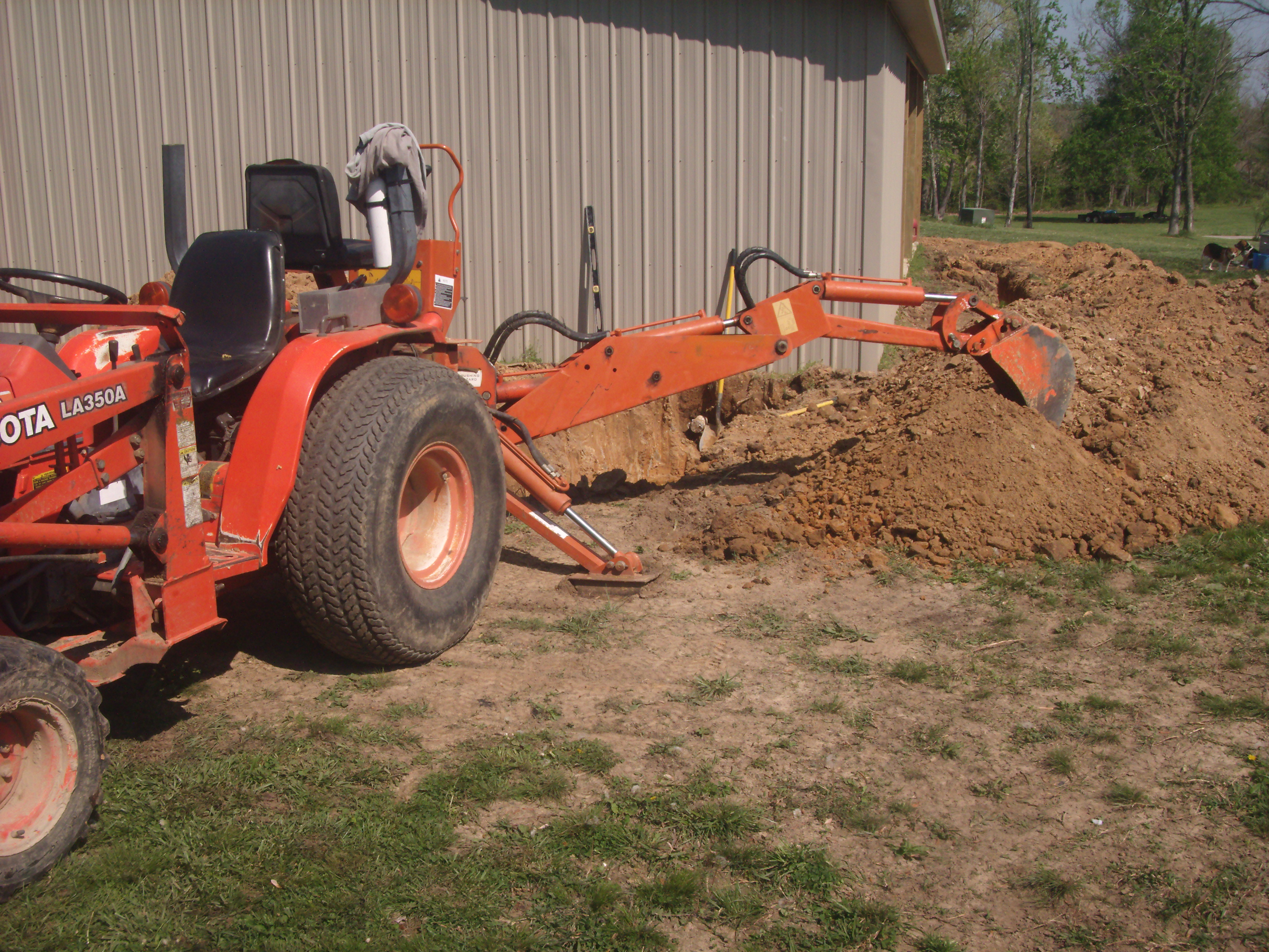

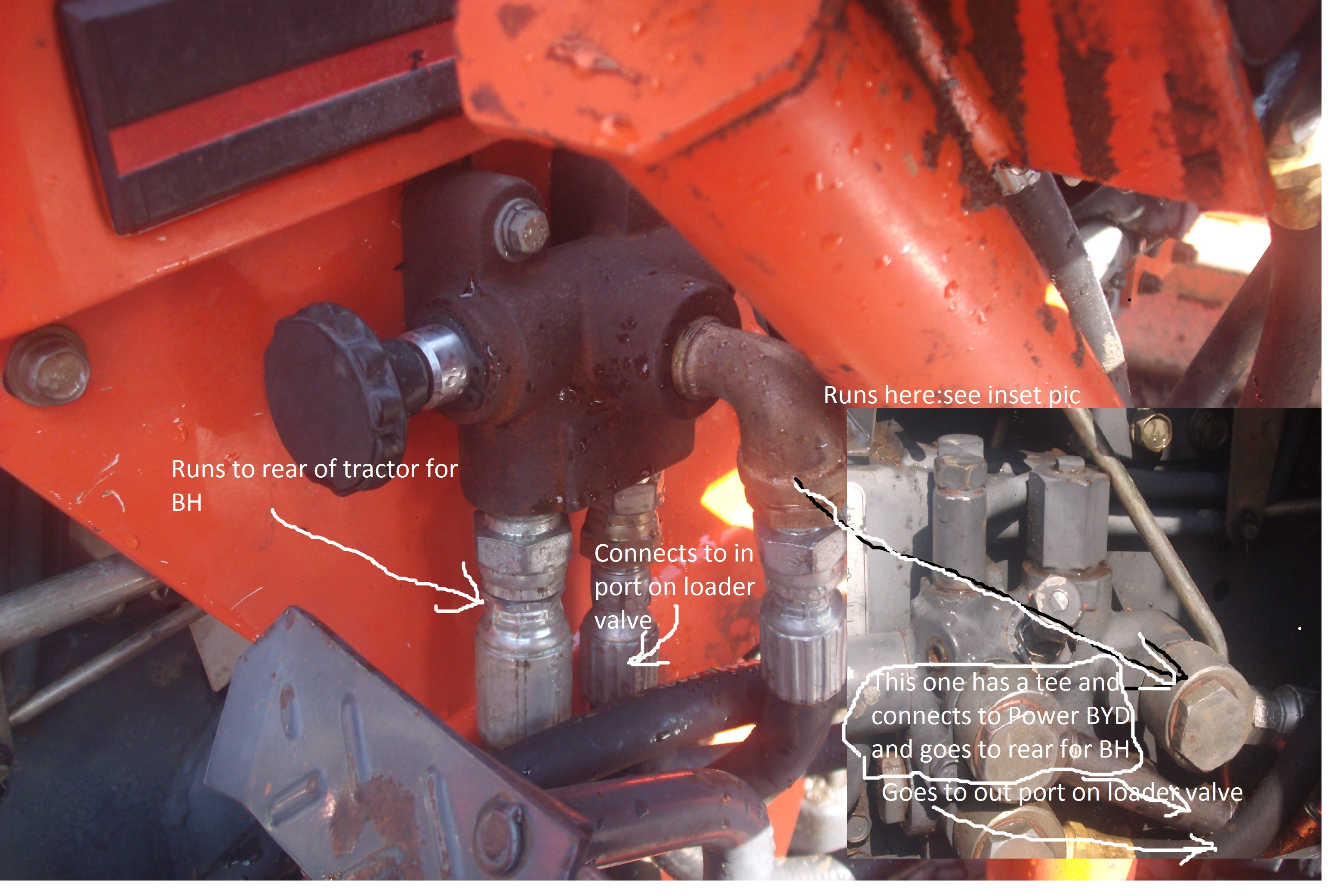

Mar 23, 2016 / B2150 BH puzzel maze #1 C coxey2 Member Joined Oct 3, 2011 Messages 26 Tractor kubota b2150 Hey, trying to untangle a mess from a few years ago. This setup works fine but I have to mess with a selector switch when going from BH to FEL. I would like to just connect the two hoses at the rear of tractor when not using the BH. Any ideas??
