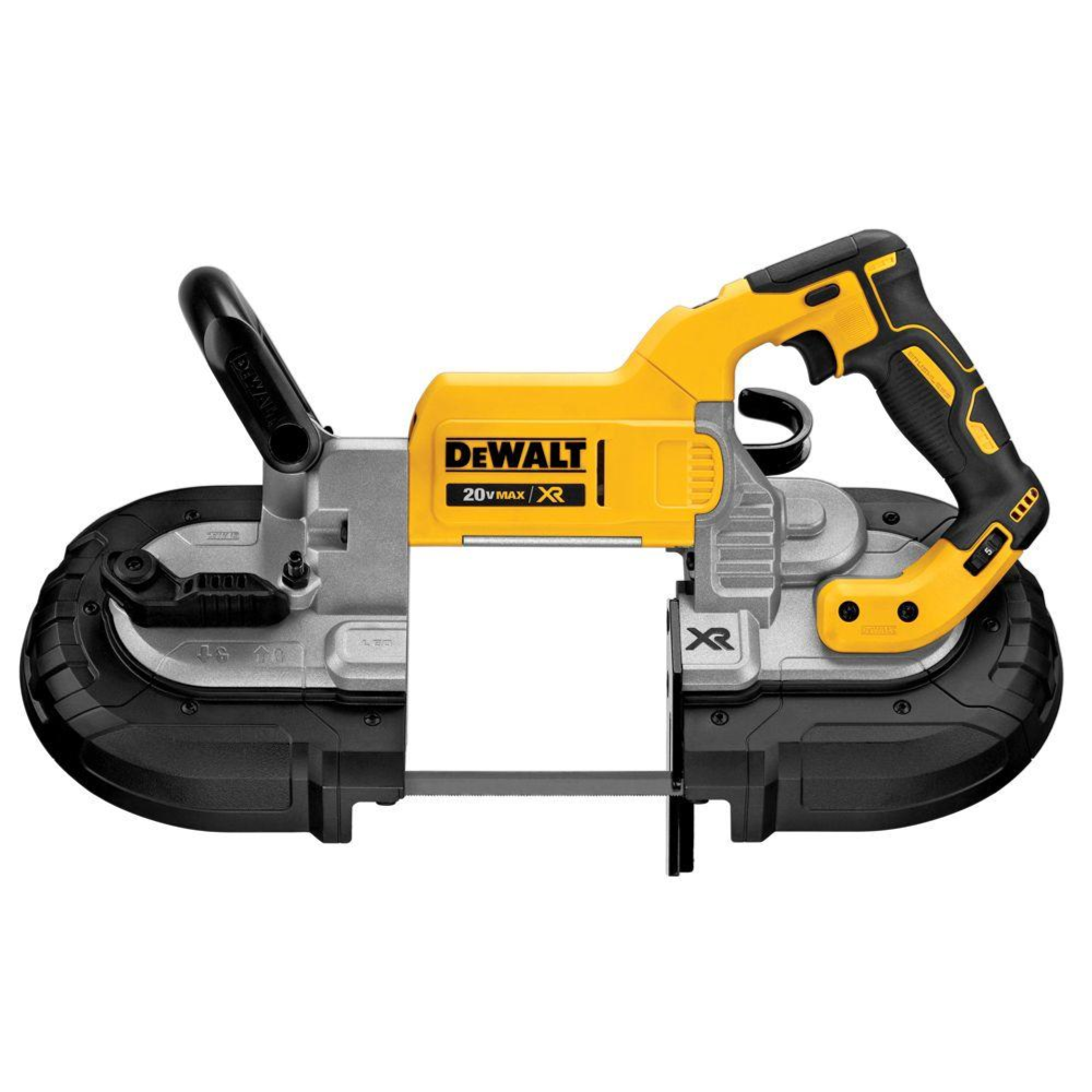

sounds like you did good, Just some easier way to do things like that for not much money is a portable hand held band saw , Either battery or plug in. Not very expensive i use mine all the time, worth having one for sure, If you have battery drills look for a band saw the same brand that takes the same battery.

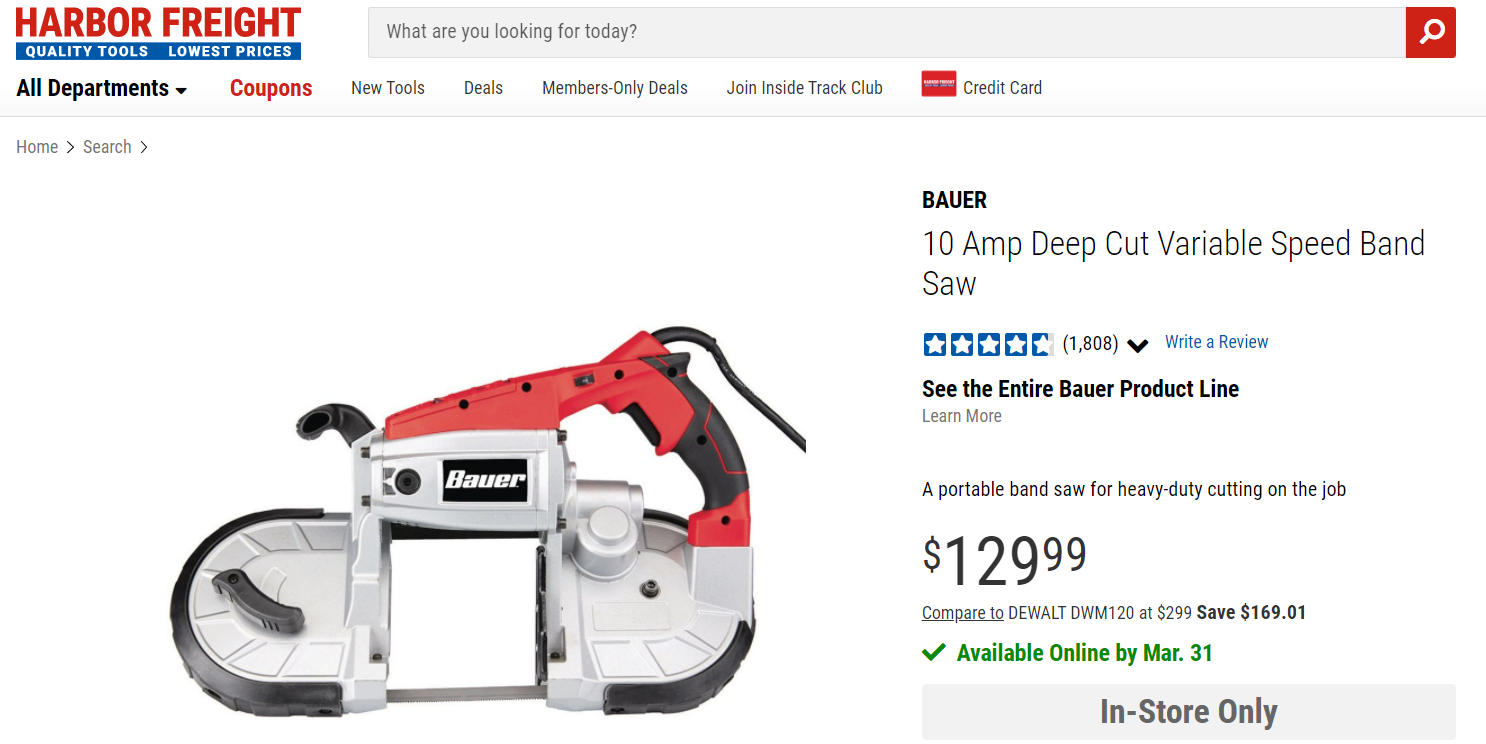

Not a sawzall. A portable bandsaw, or "portaband". See attached screenshot of a decent one that HF sells. A week or so ago I saw it for $90, which was about what I paid several years ago for its "Chicago Electric" predecessor. Nothing wrong with exercising the arms once in awhile with a hand hacksaw, but these are sweet.

No uses a band saw blade cuts like the bigger ones but is hand held, no pushing your arms to the limit LOL
