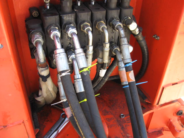

O.K. I just took delivery of a used 2005 B21 for use on my property. The tractor is in great condition with 995 hrs on it. I spent a little time on it this weekend and discovered that the left backhoe control lever operates the the boom swing and the dipperstick while the right control lever operates the boom and and the bucket. I am new to tractors and hydraulics but very mechanically inclined. It appears someone must have incorrectly flipped hydraulic lines. I can probably trace the lines and come up with a logical fix, but I don't want to mess anything up. I also don't yet have the service manual to work from. I assume the problem must be at the control valve. Can anyone provide the location each line should connect to on the valve? Also, what is the proceedure to avoide blowing fluid everywhere and ensure I end up with a leak free job?

The person who used your machine before you is a "CAT" control operator. All Kubota TLB's ship configured for "John Deere" controls but a CAT operator would have switched the hoses since there is no switching valve on the TLB's as there is on all the Kubota excavator's.
Just remove the cover over the backhoe valves (after relieving all pressure in the lines), move the levers up and down to identify the valves that need to be swapped and switch the upper and lower hoses on those valves and everything will work per the drawings on the B21. I have done this many times on my B21 and now my B26 since I have a buddy who is a CAT control guy and I learned the JD pattern.

I switched my B21 with no problems and took some photos of a recent hose replacement. The hose's with the yellow band need to be switched with the hose's with the blue bands. I like to operate mine with the CAT controls, just a personal choice. To make the switch remove the cover under the joysticks, it has maybe 10 bolts takes a 1/2" socket and wrench, then slide the cover over the joysticks.
When you take the hose's off keep the top and bottom marked and just switch the positions from side to side. takes about 20 minutes,
keep a few shop towels handy, because some fluid will run out.
After you finish be sure and check the fluid level.
