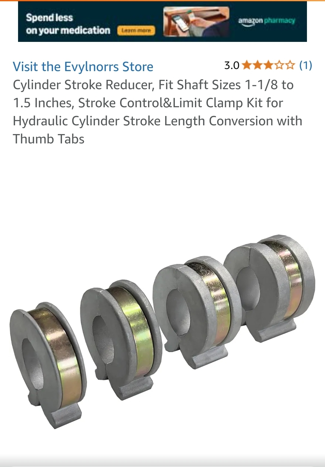

What about putting stroke limiters on the lift cylinders to prevent them from collapsing when in float
Not gonna help. You'll just lose some of your control of the blade angle. If you had float capability on the curl cylinders, that might help, but I've never heard of that being a thing. You pretty much just have to keep your hand on the loader lever and make regular, little adjustments. I've used 4 different loader mounted plows, on 5 tractors (that were all a lot bigger than a B series), 2 skid steers and a wheel loader. They sucked on everything but the skid steers. It just puts too much leverage out in front of the machine, pushing it sideways or digging in. With the blade that far in front of the machine, the tiniest dip of the front wheel is magnified greatly at the plow and float in the lift arms doesn't lighten it up enough to help very much. All of this changes completely once the road surface is frozen hard. Then things get lots easier. I wasn't joking about looking into trading back to the frame mounted plow. They work lots better on any tractor, especially a lighter tractor.
