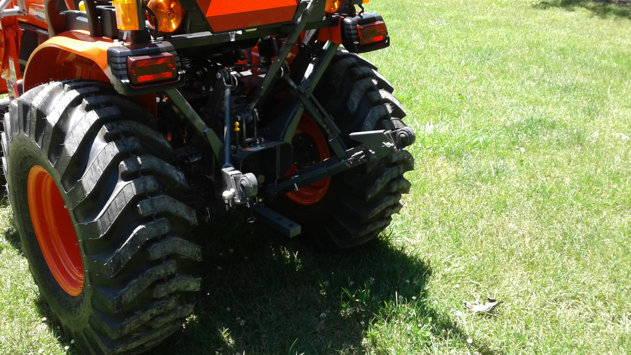

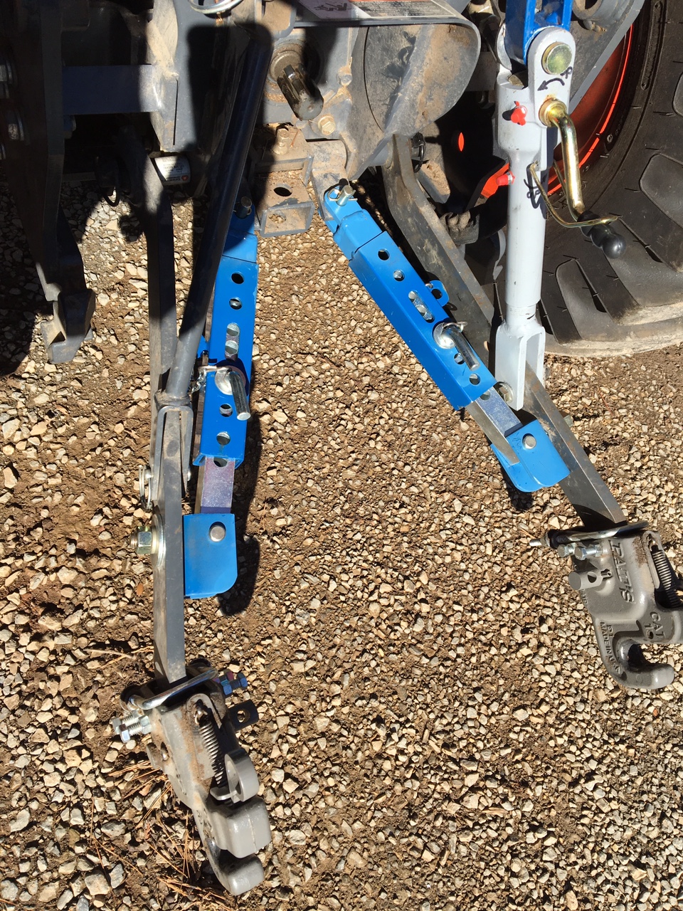

Looking for leveling box link like this for B26...
There's a 1yr old youtube vid which talks about adapting this for an L series YouTube, though apparently it may have been recently modified by the manufacturer and the fork may no longer fit. Plus it seems these are difficult to find. Anyone found a comparable leveling link that works/can be adapted to a B series?

Got this leveling box thru Weaver’s tractor. Used part of the sway bar end for upper mount.
   / B Series leveling box assembly? #4

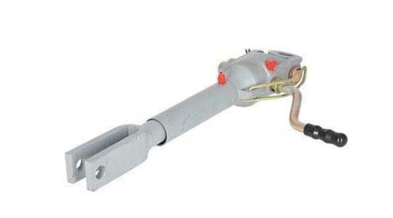

If you can't find one Kubota makes a ratcheting side link, mine was ordered with this and extending link arms. Only photo I have showing side link

Got this leveling box thru Weaverç—´ tractor. Used part of the sway bar end for upper mount.

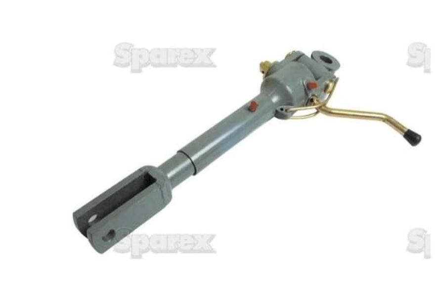

I had seen your pic on another thread (and sent you a PM about the modified sway links). Weaver website no longer has this leveling box. Closest I can find is a SBA370010122 leveling box made by Sparex for Ford compacts. It looks a lot like yours/Weaver box.

It’s been a few years since the install. I know I measured the range of OEM turnbuckle. Had to take into account extra length added by the top joint link above the leveling box to fit the tractor. You may see a marker line to indicate the fully retracted position. It has travel to extend beyond the OEM range which is nice for grade work.
There were several vendors selling vary similar aftermarket leveling boxes. At the time, weaver’s did a better job of detailing the dimensions needed for selection. Don’t recall any documentation about the leveling box that came with the order. Usually keep that kind of stuff. Don’t recall any brand or number on the leveling box.
