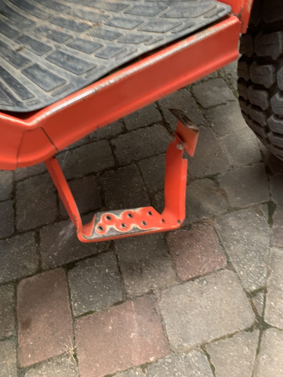

I know I need to lose a little weight, but come on Kubota, maybe you should beef these steps up? Its a friggin’ tractor. IMG_6371.JPG. The stamped sheet metal step is junk IMO. I think I’m gonna just fabricate a new one out of 1/4 or even 1/8 inch plate steel. The steel of the step looks to be thinner than 1/8 inch. If anyone has any modifications they have done to steps on a tractor, show them. Thanks!

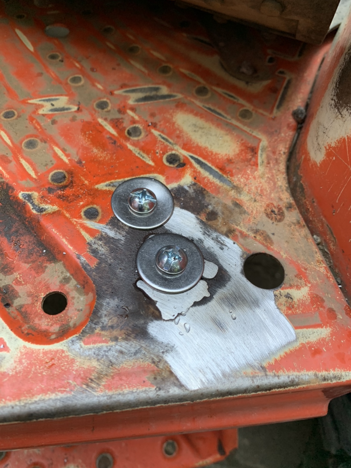

Technically speaking, the weld failed. The floorboard steel is thin as well. Tractor is 6 years old. B2650 I’ve worked it pretty hard 1100 hours or so. Also. When it failed a couple days ago, it gave my left shin a present.IMG_6373.JPG

Ouch better get that step fixed, I welded round stock around mine so it would not bend .....

I’m not sure that would’ve kept my step from failing. The weld just popped off at the rear side of the step to the underside of the floor. It bent after the weld broke as my foot and leg went down. I may just take the step off. I can get on the tractor fine without the step. It’s just nice to have one there in winter when I have thick clothing or bibs on.

Actually it looks like the sheet metal failed at the weld. Not specifically the weld itself. Either way, this should not have happened if it was a better design. Everyone is trying to go cheap with the thinnest of steel these days.
