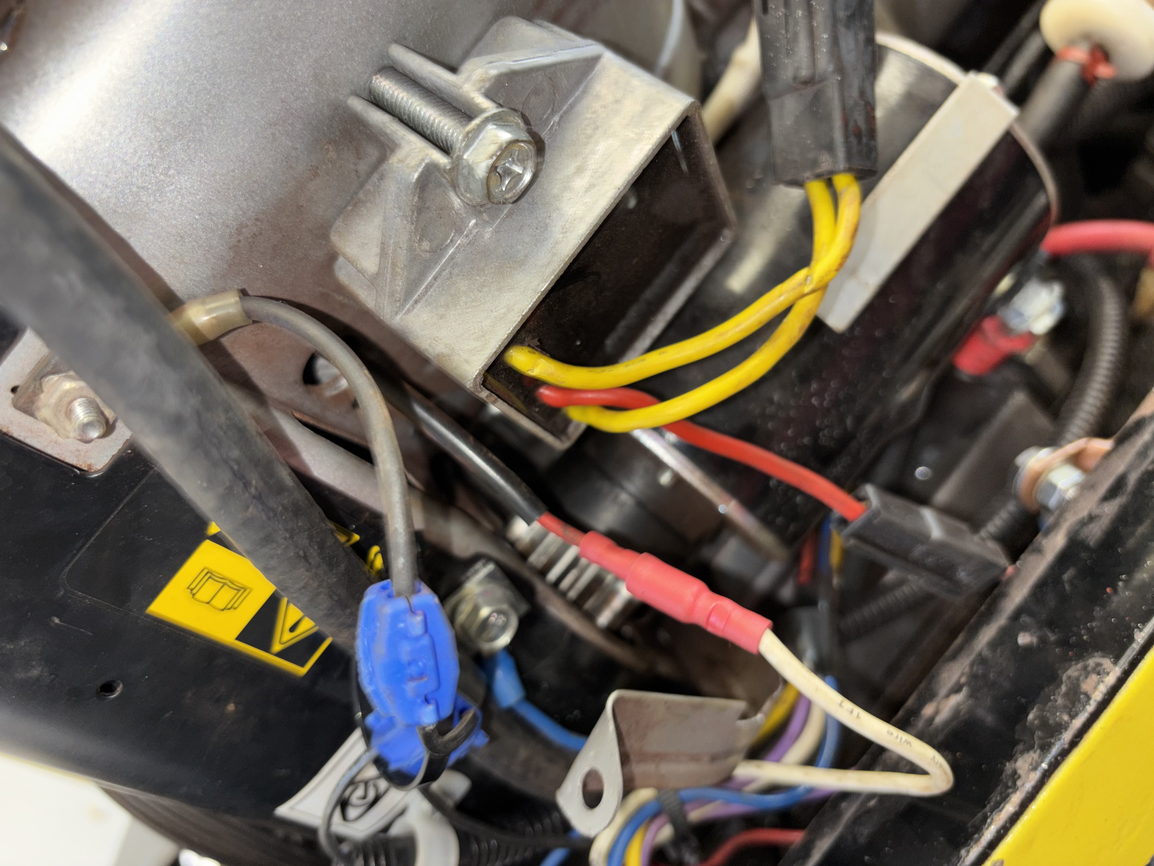

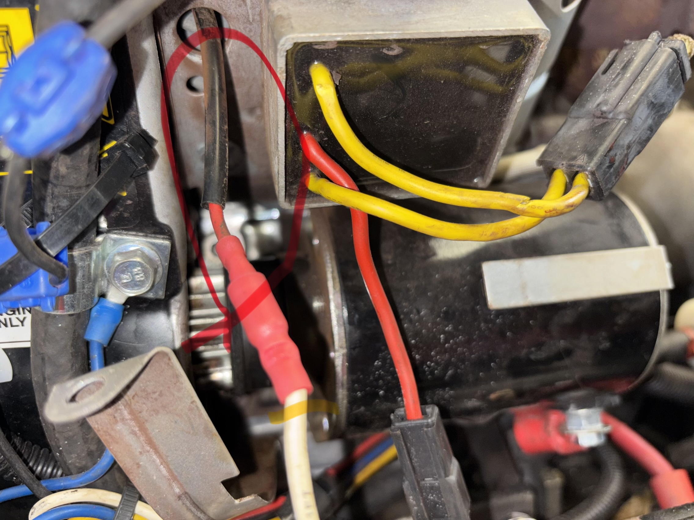

Sunday at 12:29 PM / B&S VTwin model # 303447 #1 G Geochurchi Member Joined Oct 31, 2021 Messages 46 Tractor B&S Vangard Greetings, can someone identify where this wire connects on the ignition switch, and what it is connected to inside ,I really don’t want to pull the cowling off. Thanks Attachments IMG_5985.jpeg 1.5 MB · Views: 22 IMG_5984.jpeg 3.9 MB · Views: 20
Sunday at 12:58 PM / B&S VTwin model # 303447 #2 RandyT Elite Member Joined Mar 27, 2006 Messages 3,227 Location BEECHER CITY, IL Tractor KIOTI DK45S I believe that it goes to the fuel afterfire solenoid on the bottom of the carb. Should connect to one of the A terminals on the key switch.
Sunday at 2:02 PM / B&S VTwin model # 303447 Thread Starter #3 OP G Geochurchi Member Joined Oct 31, 2021 Messages 46 Tractor B&S Vangard Thanks, I will check that, never thought of that, the more I think about it , that would be the reason for a no start yesterday. Last edited: Sunday at 2:17 PM
