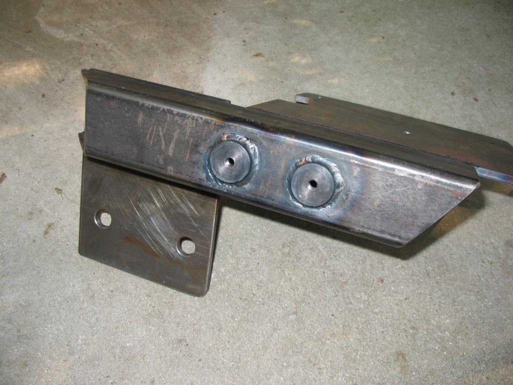

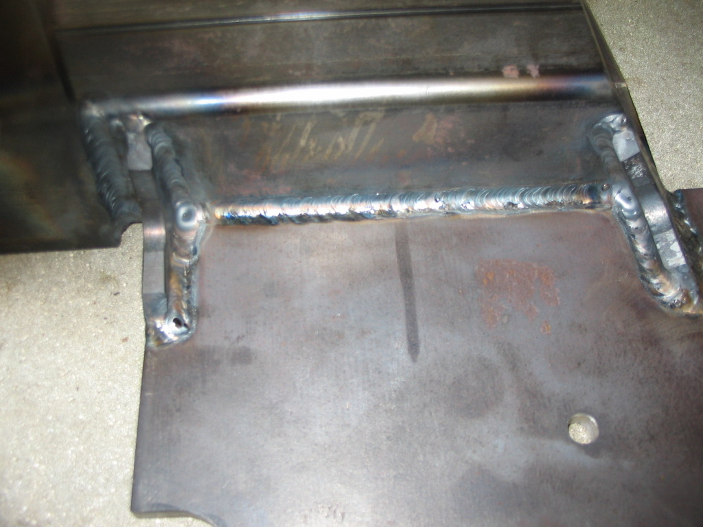

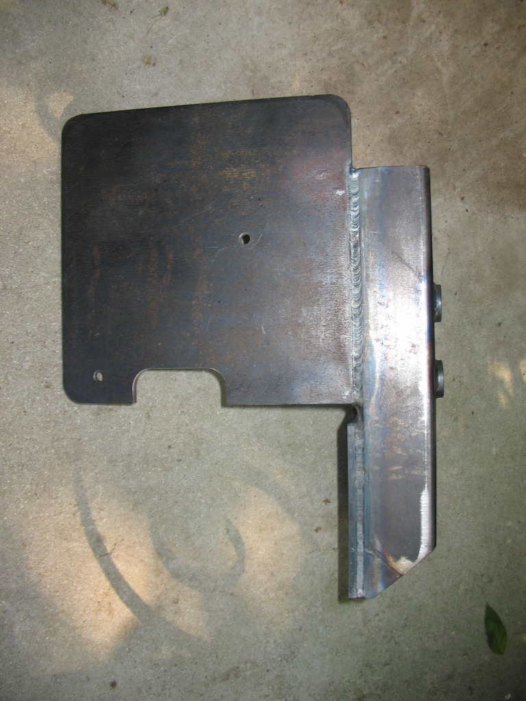

I liked the standard Kubota Remote installation, but I don't like anything clamped to the ROPS. I also like to work off existing holes and fasteners whenever possible. Luckily, Kubota was very accommodating, and I used the bolt holes that secure the ROPS where it exits the fenders..
Heres the rough mount welded up, and drilled to accept the Cross AD 2 Spool valve that I bought from Messick's.. The guys at Messick's were more than helpful in choosing this valve.

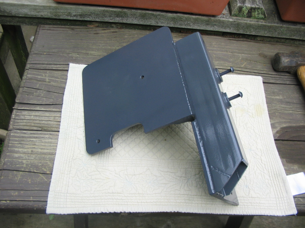

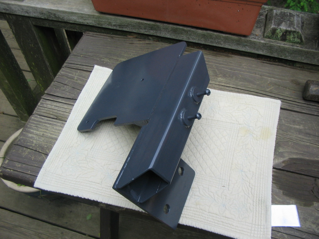

The next few pictures show the bracket painted in Kubota ROPS gray.

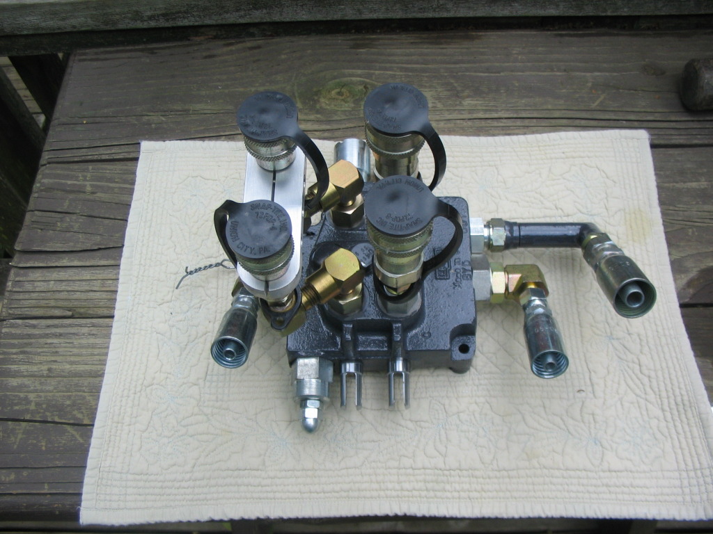

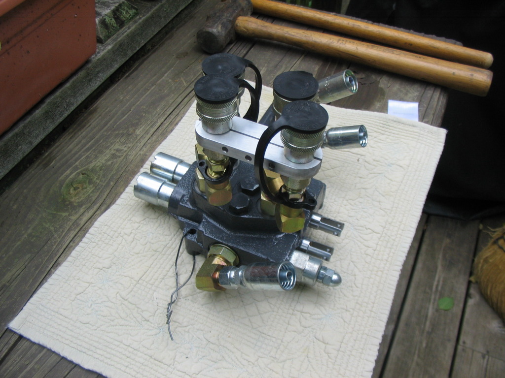

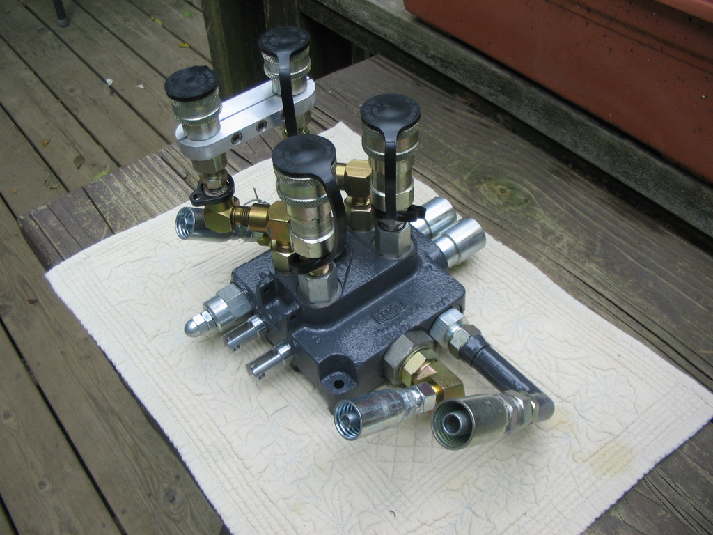

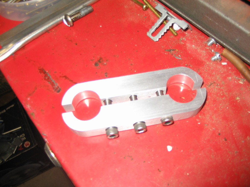

This little item is 6061 aluminum with three 10-24 SS socket head cap screws.. I merely call it "the clamp".. It's purpose is to prevent the off center QD's from unscrewing and provide some strength to the 1/4" QD's that are offset.

Here are the photos showing the Cross AD valve painted ROPS grey and completely mocked up.. A few fittings were subsequently changed for the final installation.

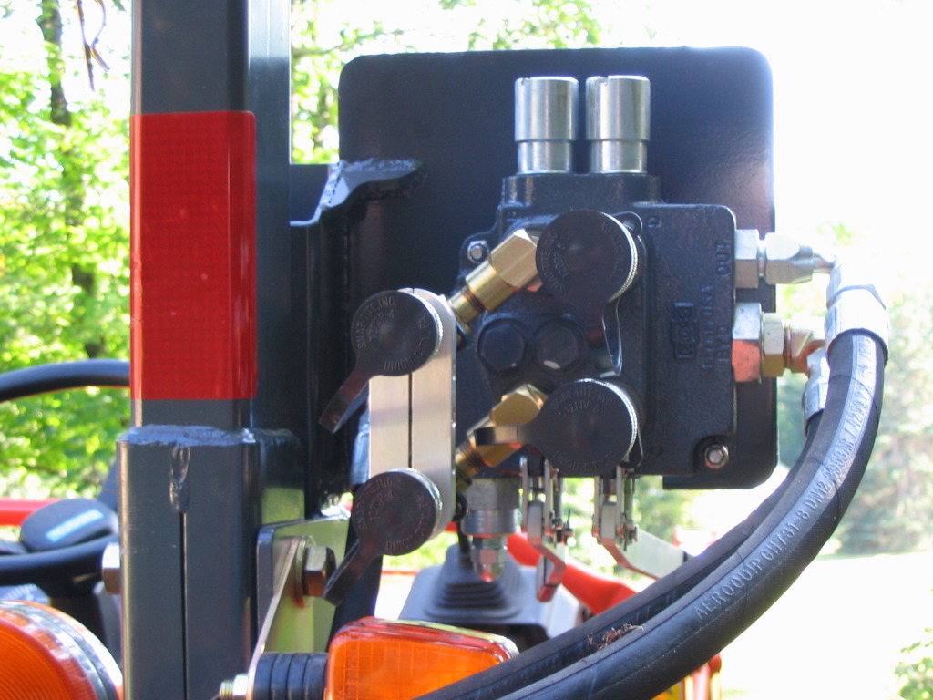

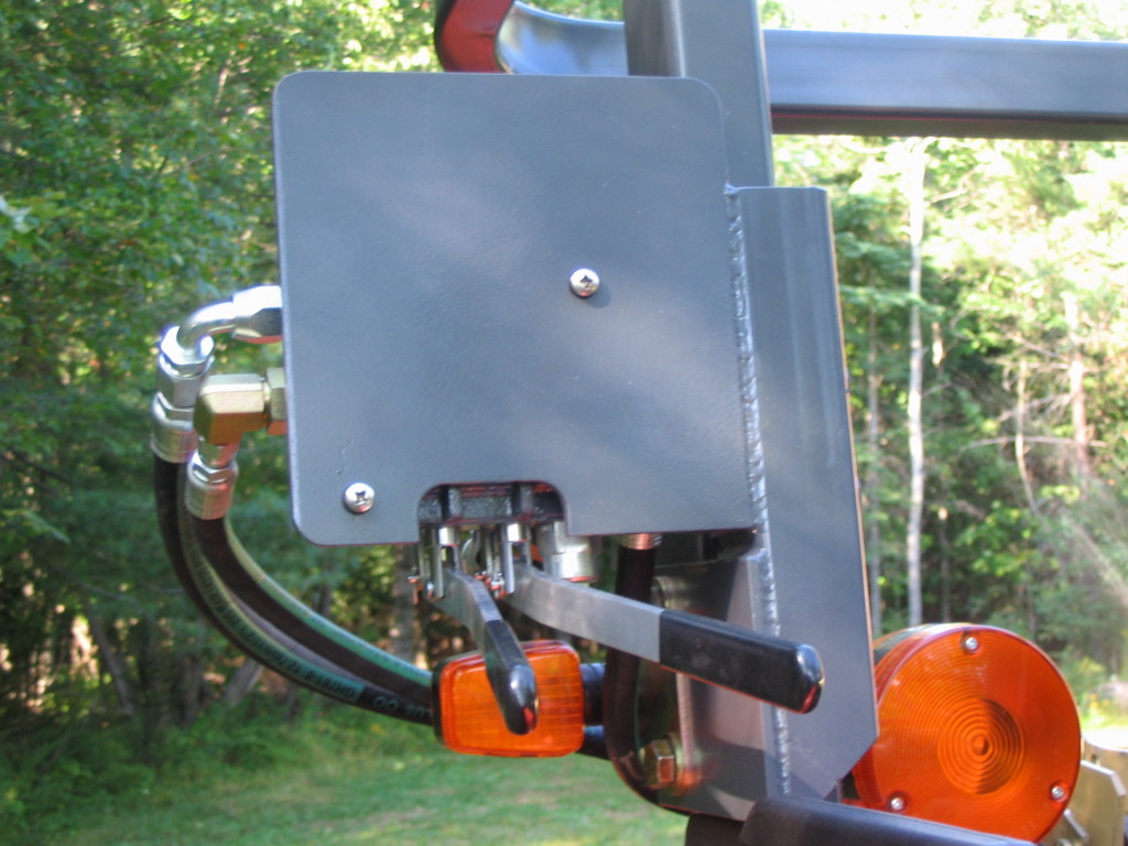

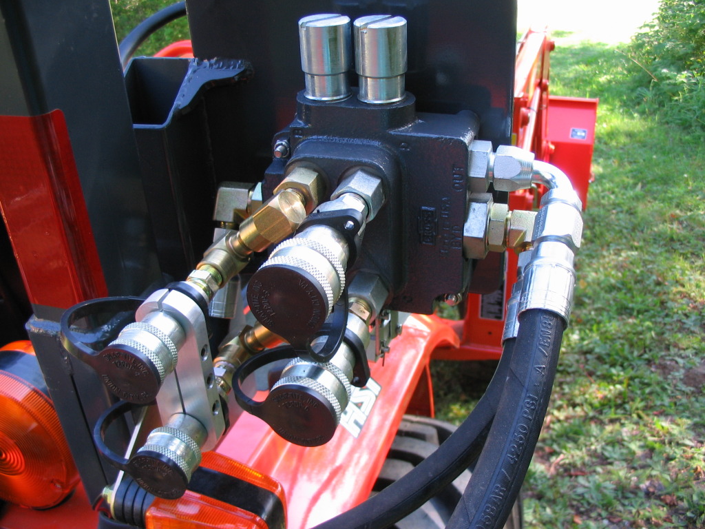

And the final installation.
The steel levers supplied with the Cross valve were replaced with aluminum levers a little bit longer for finer feathering.

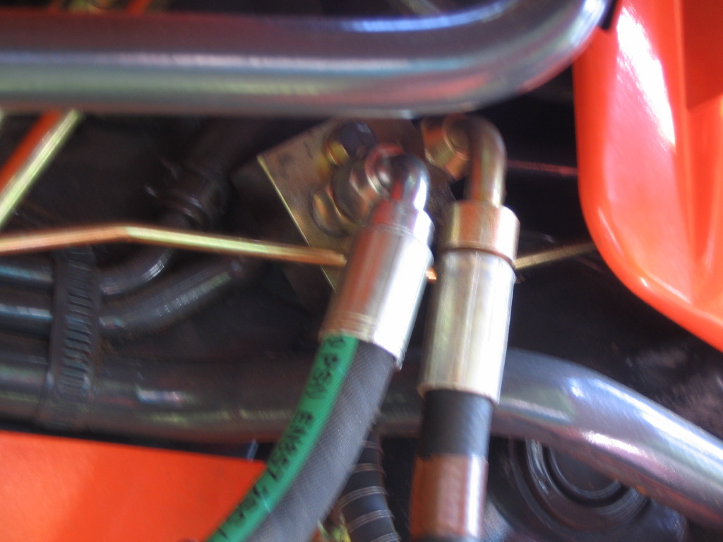

The following pictures show the detail of the new hoses on the hydraulic block, and the routing of the outlet hose that tees into the tank.
