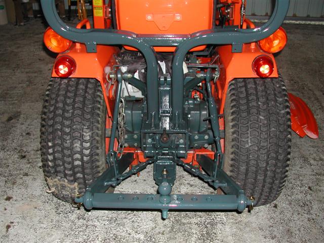

   / B-6200HST Tires/wheels
My brother is definately interested. We're unsure how many hours the turfs have on them, but as you can see, they're in pretty good condition.
Along with the full set, you'll also get a spare front (mounted on the the spare rim) and a spare rear tire.
This pic is of both rears on the tractor.

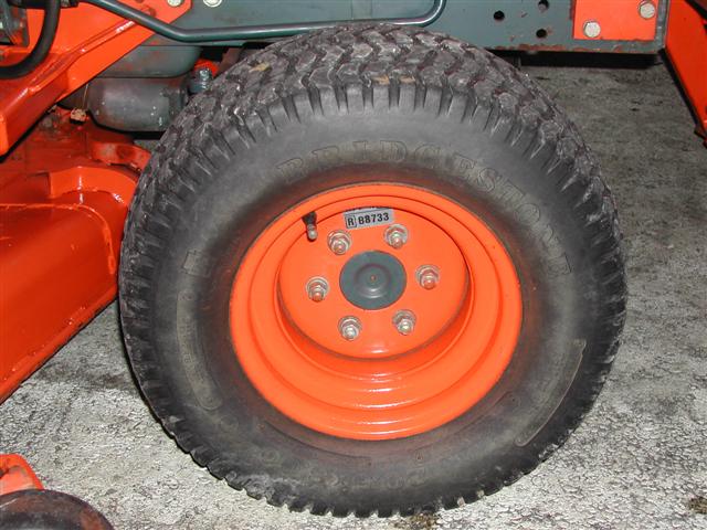

This is a front tire
Oh, sorry, You asked for the sizes. Here they are:
Front: 20.5x8.00-10
Rear: 29x12.00-15
Let us know if you are interested in a swap....
