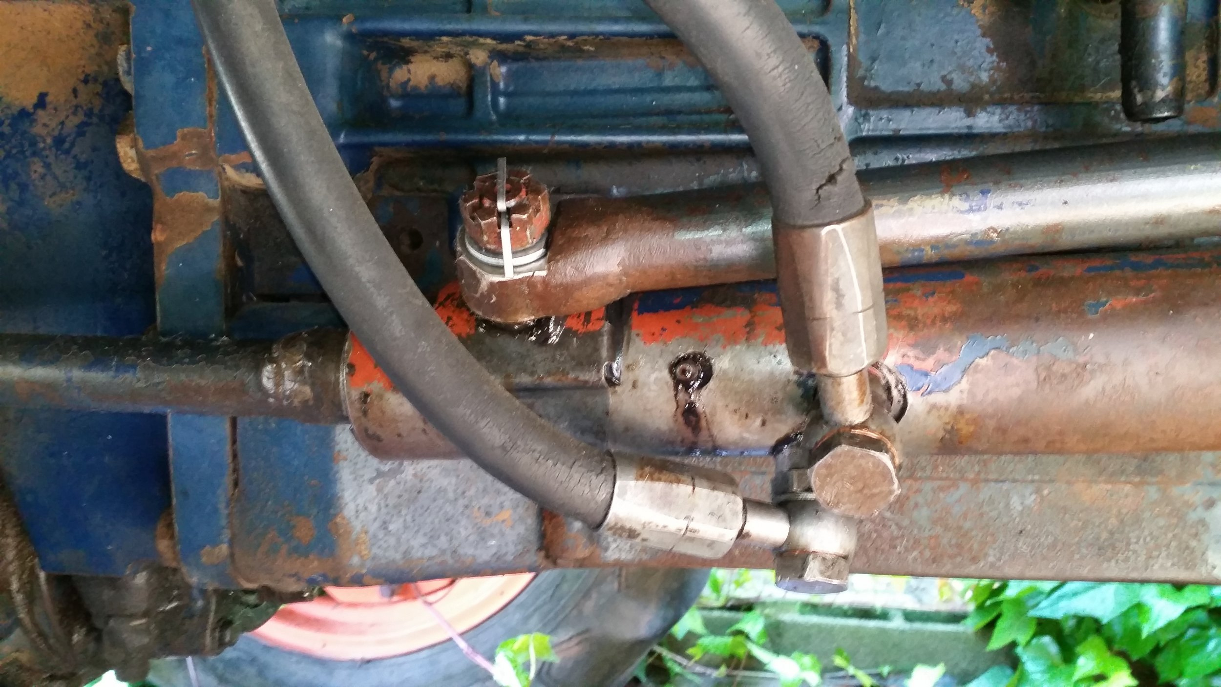

Would anyone know if the #3043938R92 Steering Cylinder was made by IH? If not what company did manufacture it?

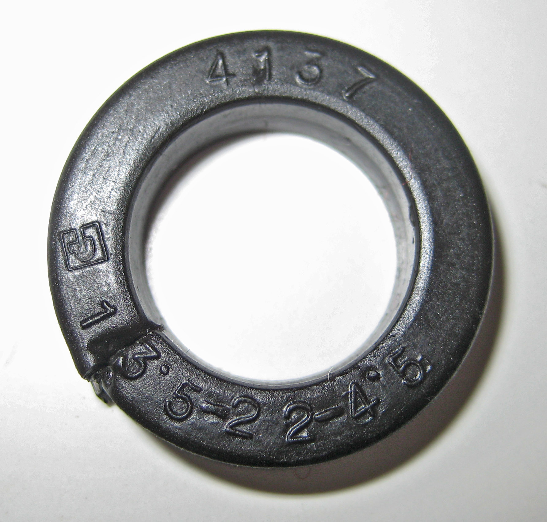

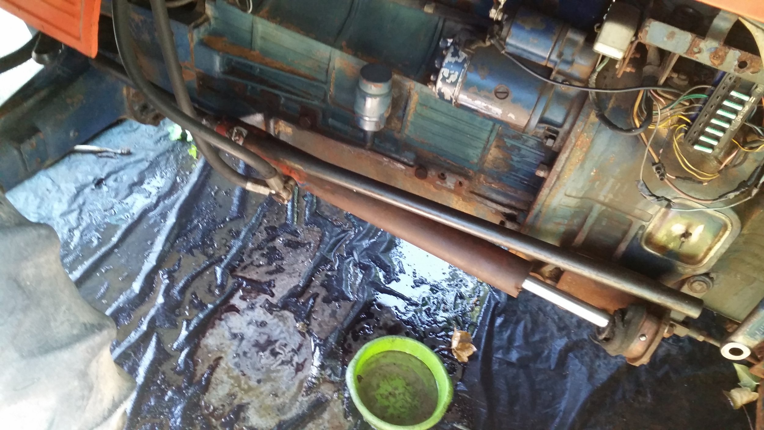

I live in the south of Spain and I have asked in several hydraulic seal stores, but everyone tells me the same thing: "we don't have that size".
I have asked too on dealers in big cities like Madrid, Barcelona, Bilbao... and I can't find them.
I have long experience repairing hydraulic cylinders, I have repaired many loader cylinders and other machines, but this is the first time I have repaired something so old.

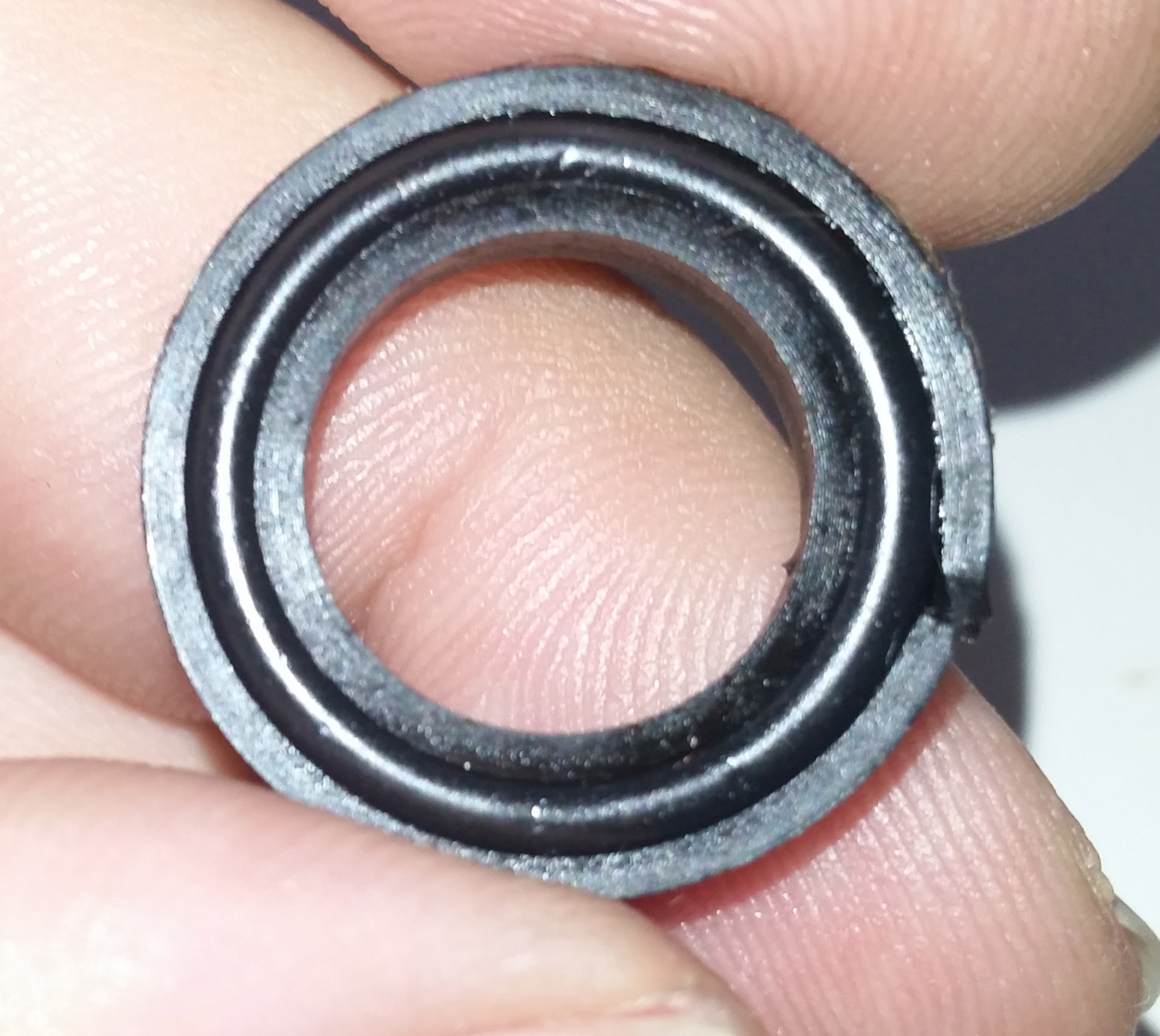

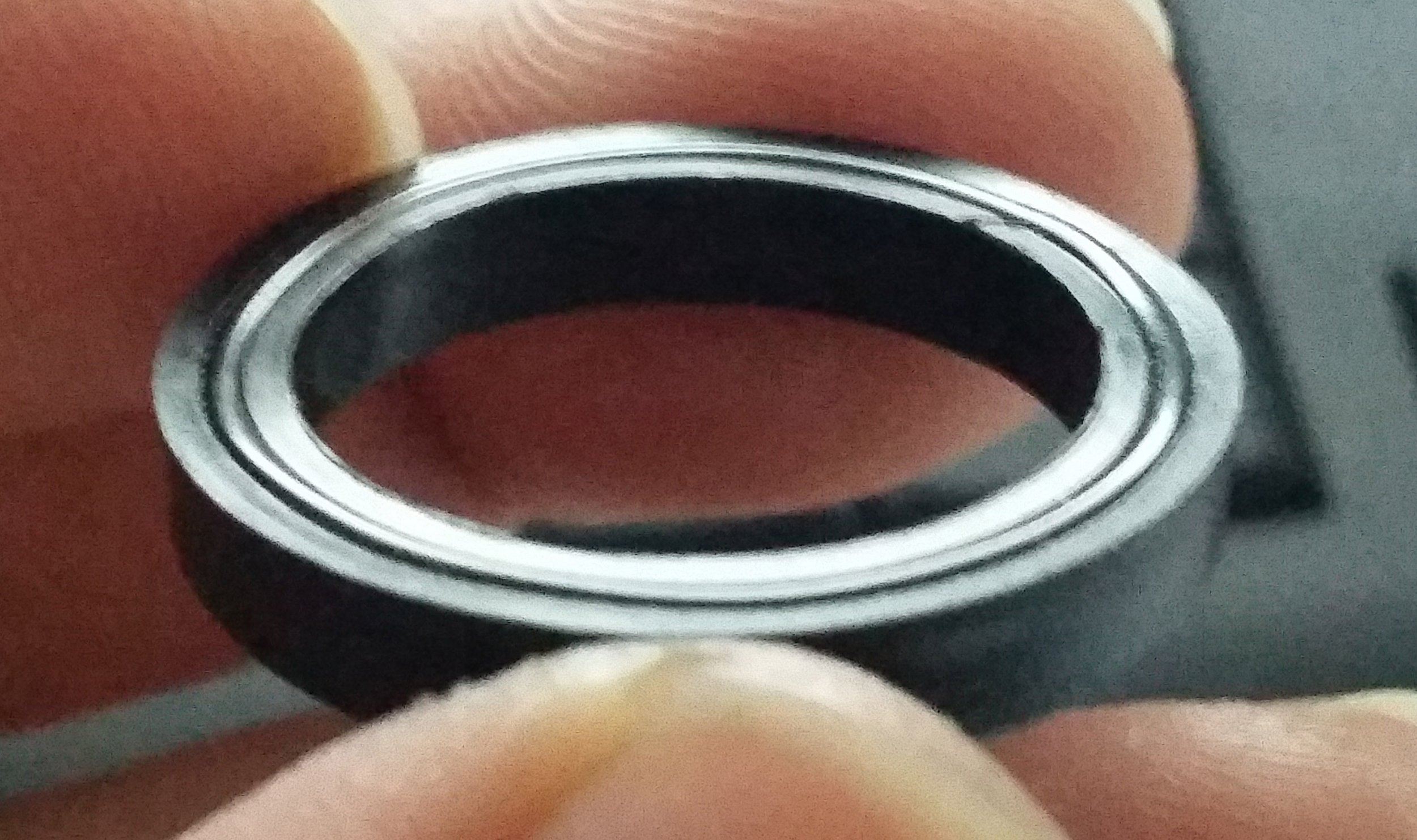

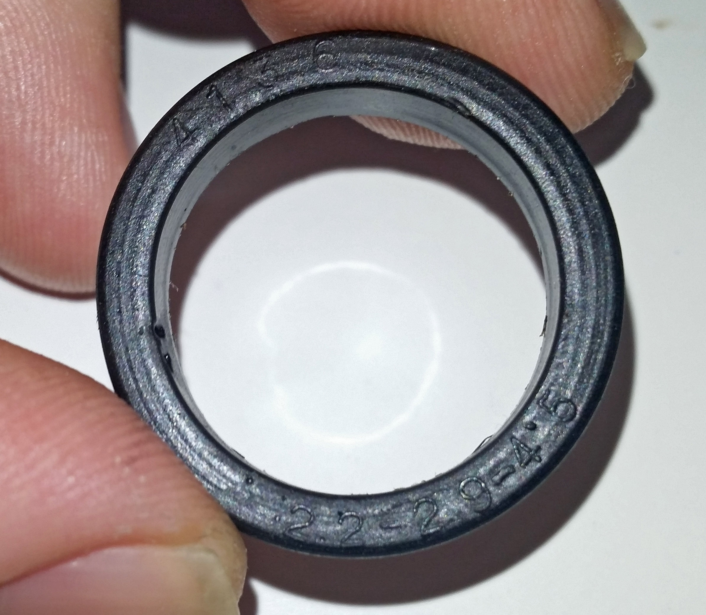

This cylinder has a distributor inside, which, being connected to the steering rod, makes the cylinder move in one direction or another. The biggest problem is a pair of loaded u-cup seals that are installed on the spool.
If anyone knows where to find these seals, I'd appreciate it if you let me know. ;)

That's some really odd size for hydraulic seals.
There is a local hydraulic shop that can cut custom sized hydraulic seals. Kind of expensive but doable. You can try and contact them to see if they can help you out. It's called HidroMarinha and they have a sheet on their website were you fill with the dimensions you're looking for. Here is the website: HIDROMARINHA - Soluções técnicas
Another place that usually have lots of seals is called Vota Seals in the Netherlands. https://votaseals.com/
I did a quick search on the Vota Seals and found a 22-29-5 seal, which is close to the 22-29-4.5 seal you have now. Maybe with a bit of machining, that seal could be fit. The 13.5-22-4.5 is a lot harder to find.
